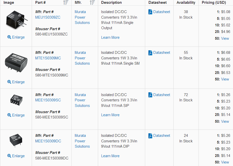

You do not want to hand-build a whole lot of switchers, transformers, rectifiers, and regulators.
A well-built switcher is self-regulated. 100mA for $6.
I am assuming the 3.65V max on this series is the actual working voltage of a "3.7V" battery.
https://www.mouser.com/datasheet/2/281/kdc_meu1-267600.pdf
The 18650 battery is 3.7V nominal, but when fully charged is around 4.2V, and around 3.6V or so is when it needs to be recharged.
The PDF you linked shows 3.3v or 5v input for that DC-DC converter; that's definitely out of the range of the 18650 cell. The 26650 might work, as it's 3.3v nominal. Do those converters expect a regulated input voltage? The datasheet didn't say... if so, that suggests I'd need a regulator between the battery and the converter. I did look at some of those isolated DC-DC converters on Mouser, I had the same question for all of them: it appears they expect a regulated input voltage.
But maybe that's another legitimate design possibility: battery -> 3.3v or 5v regulator -> multiple isolated DC-DC converters (one per output)?
