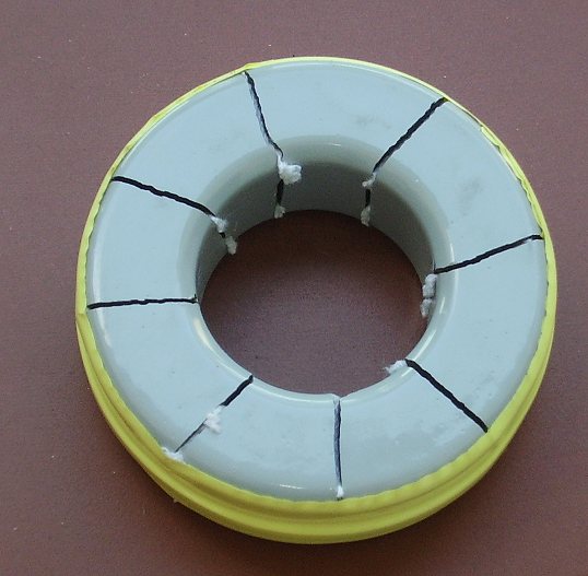

Multi-gapped ferrite
Savu!
I do this, but it's not repeatable and not effective enough with home-made technologies. If I cut it with diamond circular saw, then it's dirty, slow, expensive, and the surfaces are not perfectly parallel. If I crack the toroid, the pieces are not uniform, and the gaps are not always radial.

I think you can. There is no specific link, it's a picture on the main page of Yageo portal. Look at the attachment!
But "multi gapped" toroid sounds like marketing speak for powdered iron toroids like the ones from Micrometals Inc. and Amidon.
It would be distributed air gap, but I don't search for this. I need MnZn ferrite, for example 3F3, 3C95, and many (at least 4) well defined, rectangular small gaps. Powdered metal has huge loss.

Structurally any more gaps than one will be problematic for the toroid. Also EMI will radiate worse, ie at each gap. What are the issues with having a larger single gap only?
Maybe there are new lower loss and higher temp powdered iron material mixes that can work, given relief of design constraints rather than smallest size and/or super efficiencies? Have you looked at the cores used on newer PC mother boards?
This is false. With increasing number of gaps the EMI decreases.
Stronger stray field, wich induces strong eddy current in the wires.

The requirements for this component are completely different. They work at very high freq, therefore with very low ripple, and they are cooled quite well. My application is the opposit.
Again:
I need ferrite toroid segments. If it is not commercially available, please let the topic to sink!
What does it cost? (Probably 10 times more then the ferrites I will machine with it in my whole life.) Can you buy a thin diamond blade for that machine? Who will make a fixing device for every size of toroids? At what cost? And what do you do with the ferrite dust? And will it be fast enough? Won't it break the ferrite instead of cutting? Cutting ferrite requires stable force! A rigid axis can produce very high force fluctuation if a very small excentricity is present!
I need a cost-effective solution, not a bunch of further problems!
And I don't want to produce components! I want to use them!
Sorry, but a half solution is worse then nothing for me.
