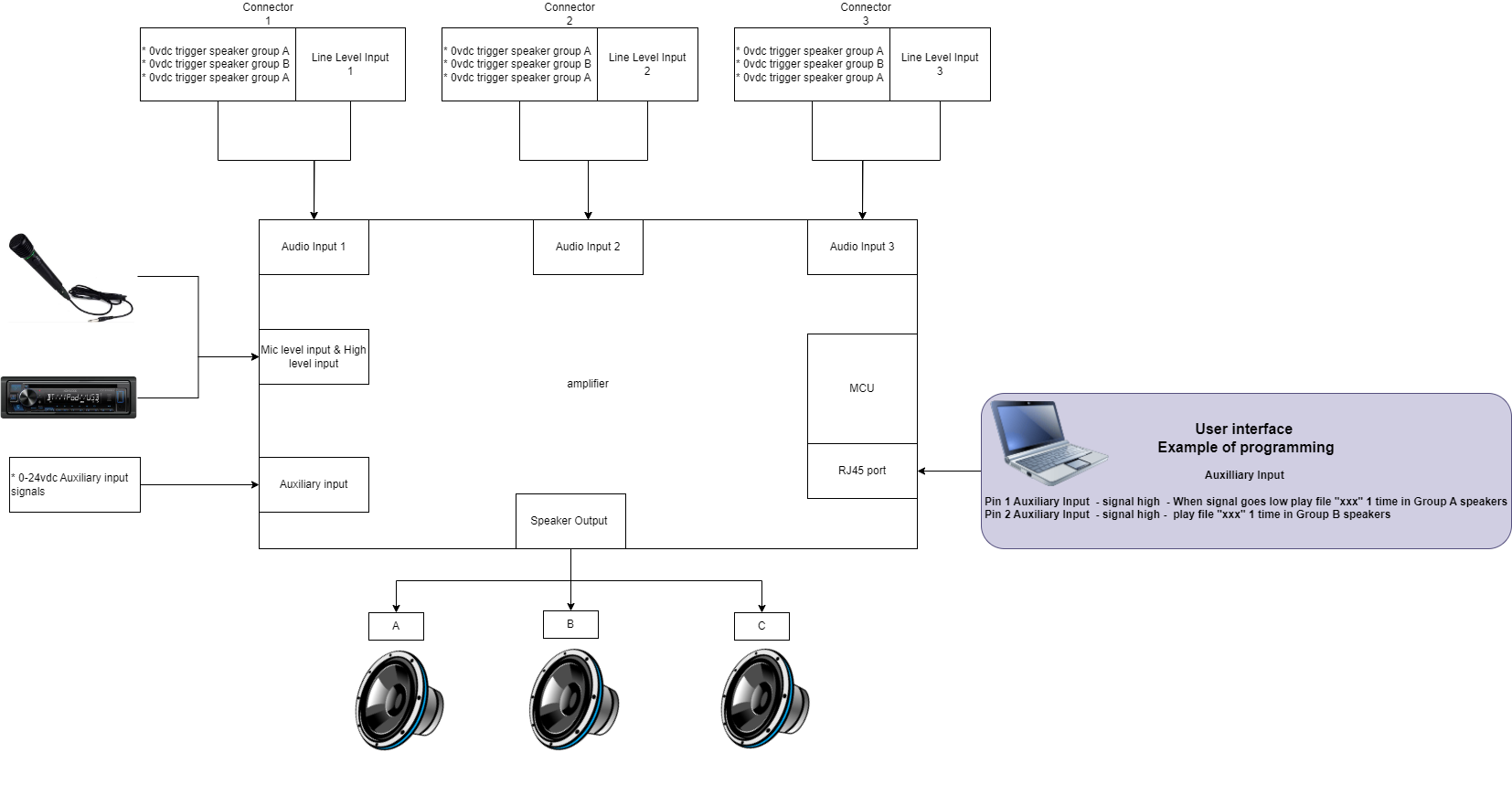

I’m thinking an UI to assign files to maybe some GPIO inputs or something and then you select which speaker group to play the file but not sure if my thinking is correct.
I will make a flowchart to get a better understanding of the project.
Something like this

Audio inputs is to play audio from other devices through line level. Typically the decision to where to route the audio is decided by the external device with a 0v signal. This is for automatic announcments primarily
Microphone inputs is for dynamic microphones like guide mic/Drivers mic
Auxiliary input is for various signals like door signals or stop signals. for example if the stop button is pressed the chosen file for this function is played.
So if I understand correctly, each 0V trigger selects where to route which announcement - announcements come from external devices that provide both the trigger signal and the line level signal (?)
The microphone input is always active and mixed into all outputs (?)
Just these two don't sound like they need a MCU yet, can be done with just discrete electronics. Yet. There must be something you need the MCU for.
The buttons trigger audio file playback from local storage - all outputs, or selective ones? In your diagram in #6 you allude to pin 1 and pin2 controlling , how many such pins will there be? Will they all be the same file, or different ones? Will they all be played only once, or can they be repeated?
One last thing that could help is if you detail each input and output condition separately, and hand that to the designer. A full list of every condition will be required anyway when you start the development.
Good luck, sounds like a very interesting project, I'll be sure to follow.
Correct
The microphone sends the signal to activate usually by a pressing a button so the same kind of trigger principal for these inputs as above
For these function an MCU is not needed indeed.
For the internal file system and processing it will be.
There will be maybe 5-10 inputs for different kind of applications, In UI i want to be able to pick a file from storage and assign it to any pin so when i for example press the stop button i can program it to play a specific file and how the characheristics should be. (Play once, play when signal goes low etc)
