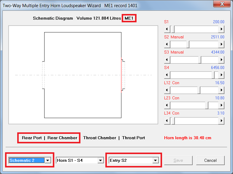

I'm working on this idea of a MEH cabinet but with mids and lows only. Using Hornsrep screenshots it seems hard to visualize. But I will draw this up as soon as I get some clarification.

Regarding the ME1 Record:
I'm assuming HR is using S2 for the location of the entry ports. Is this a correct assumption?
Ap1 and Ap2 I'm not sure about. If I'm just using a 2-inch cutout then both of these values should be the same correct?
Vrc and Lrc seem to have default values. I can't remove them. I was thinking the Nd record governed the horn dimensions as well as the rear chamber. Why is Vrc and Lrc populated in the ME1 record?
Yes. The position of the entry point is shown in the right-hand drop-down list box. The position can be changed to S3 if required by selecting that option.
Yes. If you update your version of Hornresp, you will find that the port can be flared if required.
Because you have specified a vented rear chamber behind the ME1 driver. Just delete the Vrc and/or Lrc values in the ME1 Input Parameters window input boxes, or set the ME1 Vrc and/or Lrc sliders to zero in the wizard.
