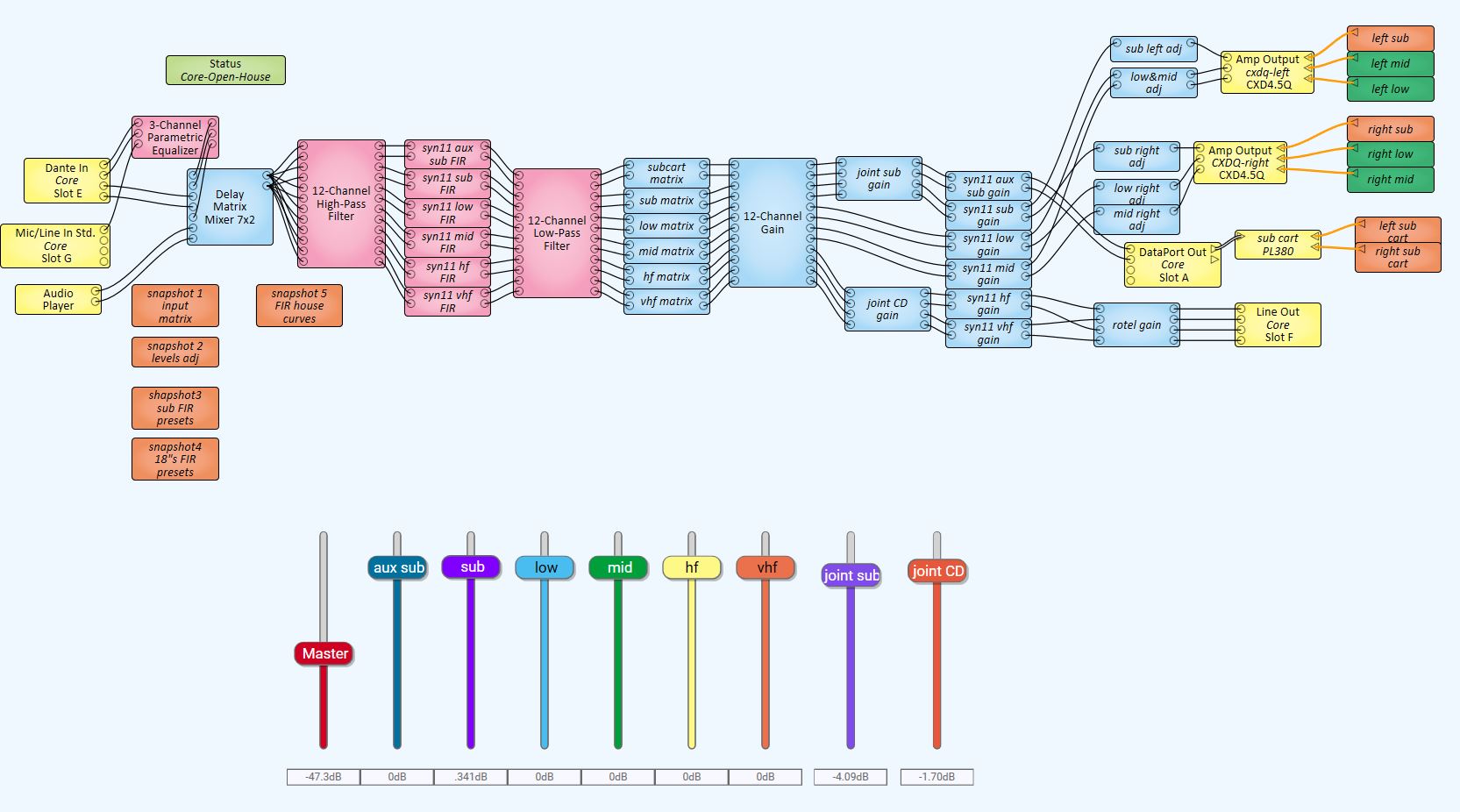

This is the schematic for a pair of 5-way syn11's on top of dual 18" subs..
With 12 channels of 16k taps per channel.

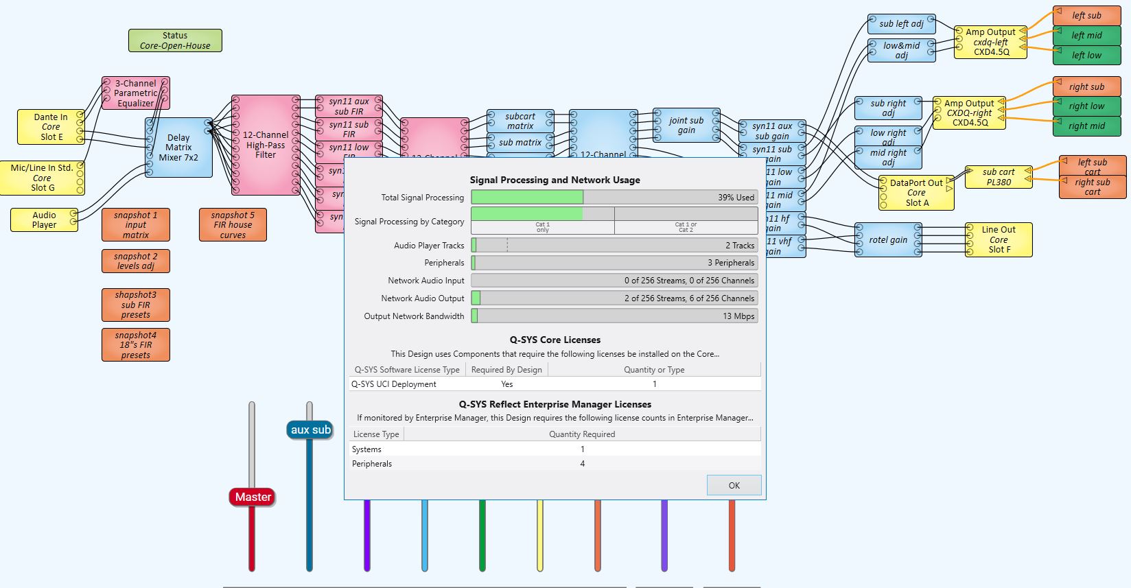

Here's same thing, but showing 510i's capacity utilization.

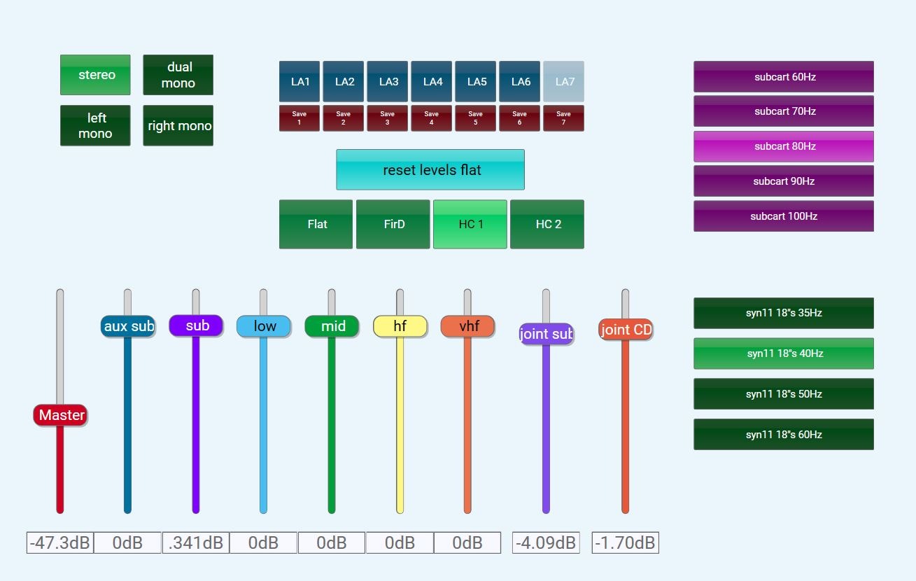

Last the remote I'm using. You can put anything in the remote,..... that go onto windows laptops or any OS device I think.
The faders control levels on individual driver sections. The buttons LA1-7 are presets for the faders, you can make and change at will.
The subcart buttons set the low-pass filter on the dual 18" subs, the syn11 buttons set the high-pass on it's 18" drivers.
The coolest thing I think, is the set of Flat, FirD, HC1, and HC2 buttons...they change all sections FIR filters on the fly without audible hitch or glitch, for various degrees of downward tilt house curves.
