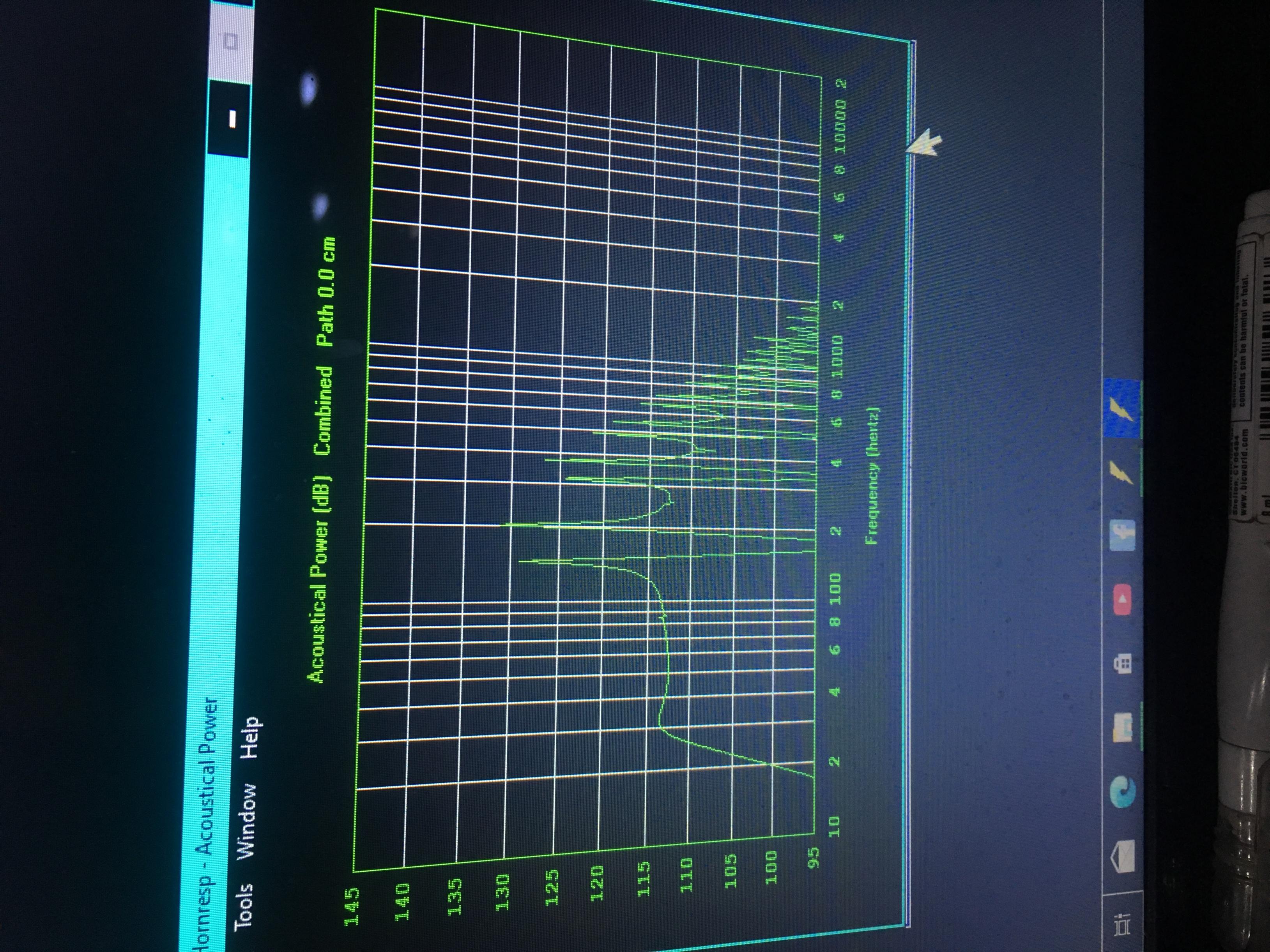

Example: dayton rss265ho4 single, in a tiny ‘TL’ of 38 liters
