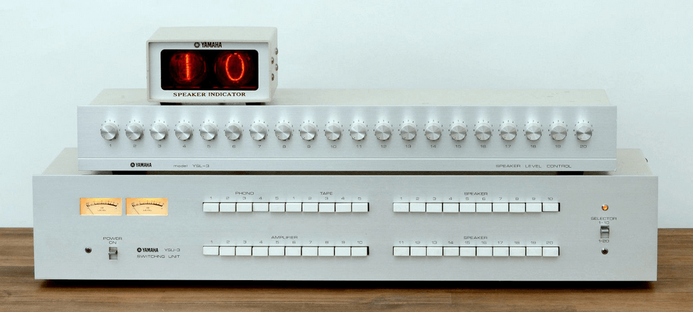

Yamaha YSU-3 and YSL-3

THAT is sexy! How does that work with loading amp outputs?Yamaha YSU-3 and YSL-3
The Yamaha does not load the unused output.
