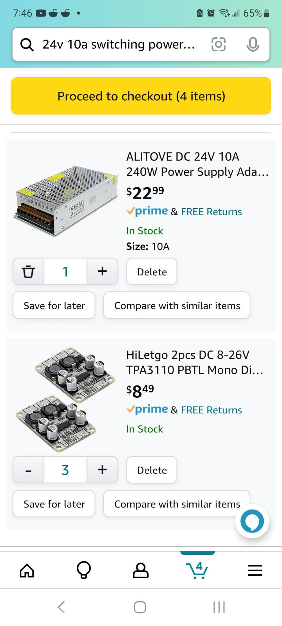

Found this PSU has 3 Com 3 +V
You'll have to give a quick dirty idiots run down of ABD Mod and PBTL haha

@HAYK thanks- Never ordered from there lol Ill give it a go- i see you meant MOD as in modification- not sure my pea brain would be able to mod those boards. Thanks for heads up on 3255- Ill poke around I guess for the dual power supply ones.. I dont want to limit the watts of the woofers.
