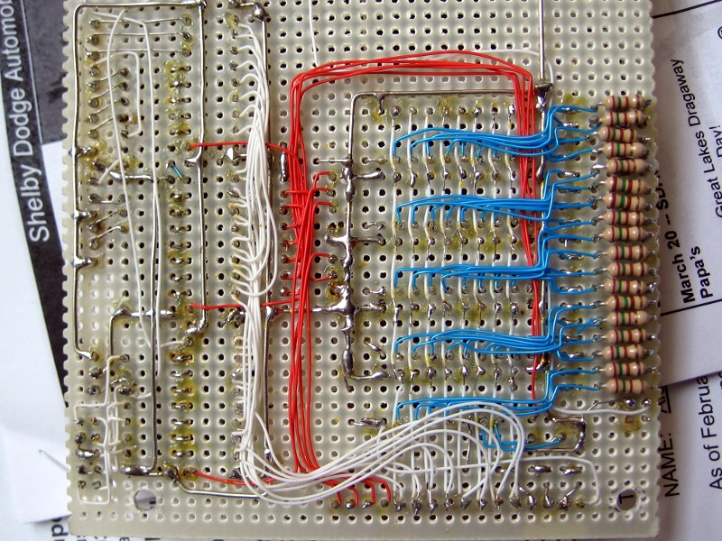

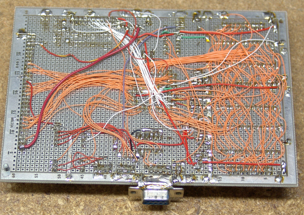

Wow, that's some serious wiring!

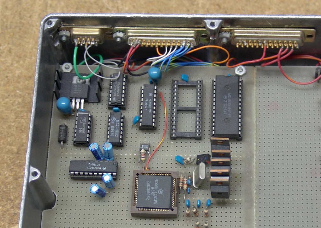

I have been using that construction method for a very long time. It is especially good for digital projects.

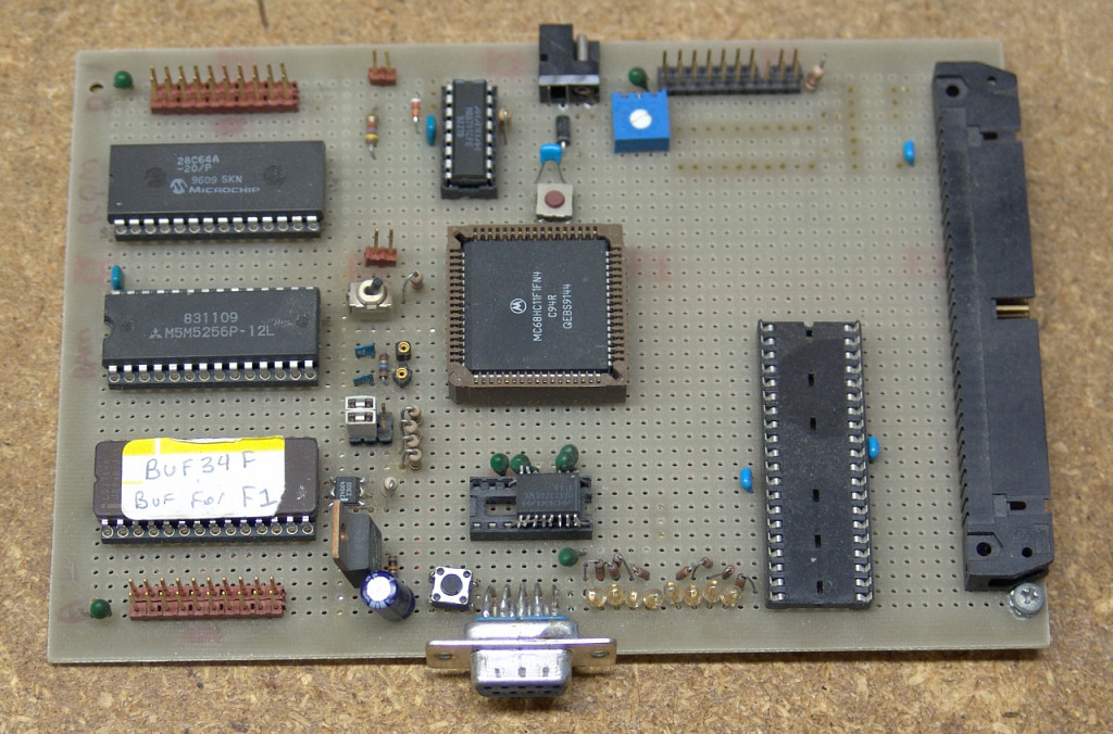

I still have the boards I made for a music synthesizer that I designed and built in 1970 / 1971 (yeah it took that long). It used a master oscillator and 12 seperate dividers to generate the top octave, and then several dozen flip flops to generate the lower octaves. More dividers and opamp summers allowed individual control of the harmonics present in the tone. The whole thing was fully polyphonic. This was long before Mostek was even a company, and the MK50240 wasn't even a dream. The tone generators took up 5 boards about 5 X 7 inches using RTL logic (before CMOS or TTL was popular) The linear power supply was 3.6 volts at 25 amps using germanium power transistors. The boards are in a box in my warehouse, the big stuff is long gone.

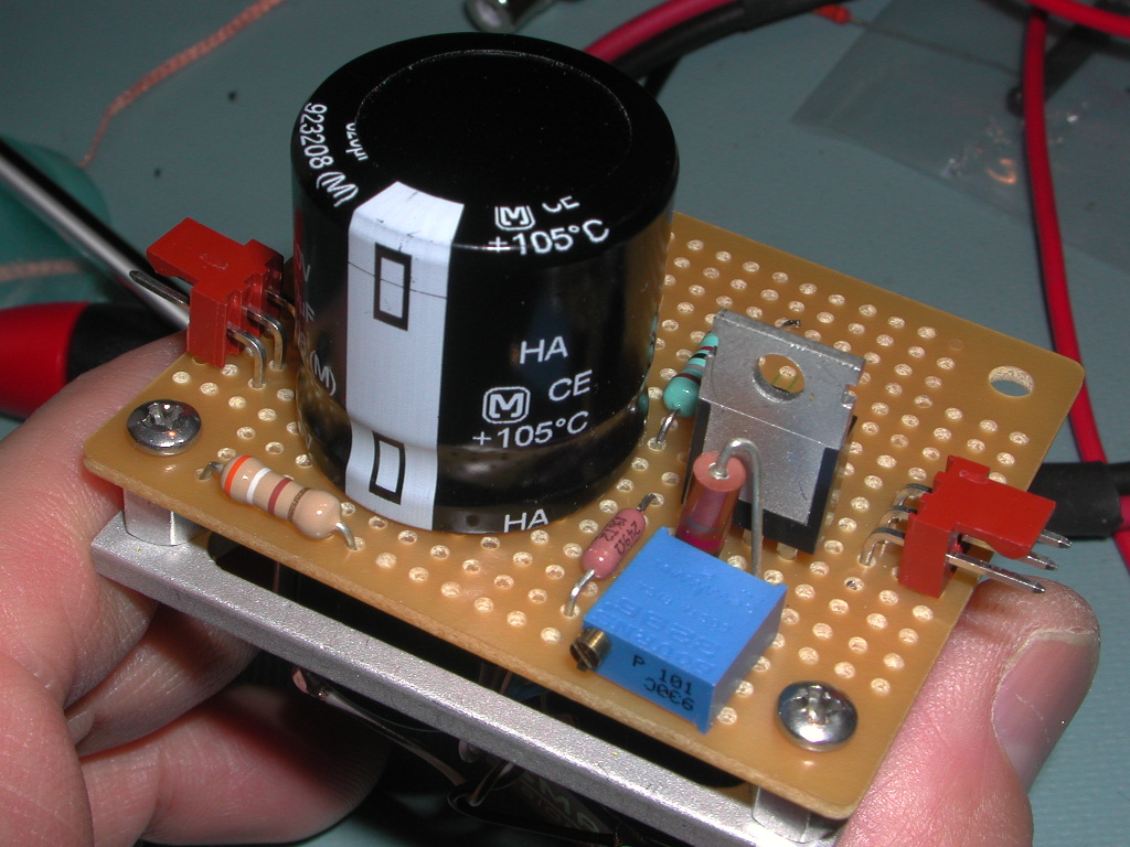

These are two newer projects that were in my closet. The boards in the Hammond die cast box make up an electronic fuel injection controller that I built in college, around 1991. Yeah I didn't start college until I was 37. It succesfully ran the engine in my turbo Dodge, and was responsible for the melting of at least one head gasket. It was abandoned after I totally aced the digital design class, and learned to hack the Shelby controller (made by Motorola). The other board is an EVB that I designed for the 68HC11F1. Noboby made what I wanted, so I made my own.

Very cool, George. I also have a Turbo Dodge controller/logging module that I built to fulfill a similar need, but I never finished it because we can tune the stock modules so easily now.

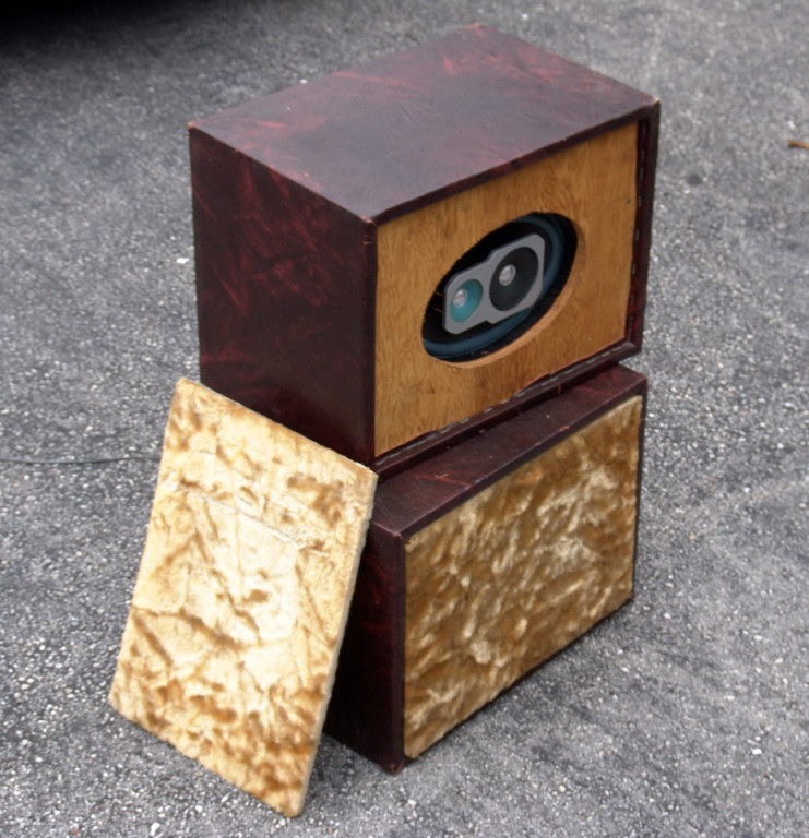

Meet Master Blaster, or at least what's left of him. Back in school we had an analog design class. The same teacher that asked for a simple digital project (I did the EFI controller) asked the class to design and build a simple analog project (tubes were unacceptable antiques). He got each one of us to stand up in front of the class, state what our project was, state the goals, and state the measurement criteria. I simply replied that I was going to build a car stereo amp, and the teachers head would hit the roof of my car when I set it off!
The design was simple by todays standards, but way above the norm for students seeking a computer engineering degree, where analog meant the opamp in front of an A/D converter.
A push pull SMPS boosts the 12 volts to +/- 30 volts. That is the supply for 4 identical amplifier boards that make about 30 watts each and a subwoofer amp (BTL) that made about 100 watts. The power supply was done using this perf board construction, but the amps were on PC boards that I made. Some old timers may recognize them. They are one of the Tiger series, the Plastic Tiger, I think. The sub amp used two of the same boards but TO-3 output devices for more current capability and the load wired across the two outputs. The amp has been robbed for the sub amp and 2 of the main amps. Hey it has been in my closet for almost 20 years.
The little Dodge Omni had 2 6X9's 2 6 inch, and a 15 inch sub. The whole class gathered in the parking lot, and I put in a CD that was dead quiet until the bass drum hit. It took about 3 milliseconds for the teacher to jump out of the car screaming profanity, and I got my A.

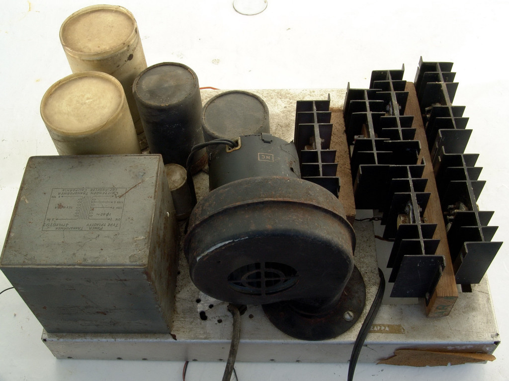

Photos, the 400 watt SS amp that I built in high school (1969) and a pair Of Speakers that I made. These are obviously old, pre disco even!
Not sure which controller your cars use...
The 86 Turbo Z uses the LM/PM setup, but I converted it to 87 LM/PM because that logic module is a bit more sophisticated and the EPROM is larger (16kx8). It also has the SMEC harness spliced-in so that I can quickly switch to the SMEC for testing (I do some cals for local folks). The 87 CSX is still the stock LM/PM with a custom cal, 3 bar MAP, big injectors, etc, etc. They each have different cals with rather different origins. The CSX is a very early reverse-engineered calibration that has a lot of bugs but runs well at WOT where it counts. The Daytona's cal is more refined, but still has a few winter idle issues.[/QUOTE]
Since there was no power transformer, we can't talk about it here.
Hmmm...sounds like my dad's 8417 amp. He built it in the late 60s I imagine and gave me the amp a few years ago. It had only a small transformer for the preamp side but it did come with a wooden box filled with big capacitors and diodes and an unpolarized plug at one end....
