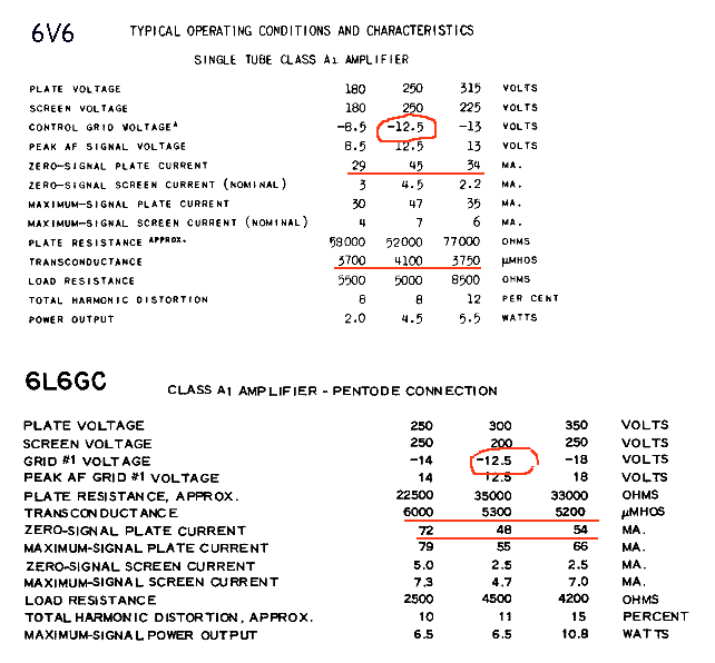

From a quick glance at the datasheets the 6V6 gm ~4000, the 807 is ~6000. If these number are correct does this mean the 807 has higher sensitivity than a 6V6? Or do I have this backwards?
The two numbers are at *different* current (right?).
Gm always increases with current.
Also with cathode area. (And plate current is a design factor on heater power.) The double heater power on 807 suggests higher Gm but it is not twice as high. In fact not radically different.

That was my point/question. If a 6V6 could be driven by the circuit then a 6L6 family tube (807/1625) should be as well?
Unless you are doing something super unusual, read the data-sheet drive conditions and see what the drive voltage (and all other!) values are.
I know we are all locked-in/down and bored out of our gourds. But back-figuring drive from Gm from unstated loading assumptions is not a good use of excess energy.
Yes, your thinking is correct. If the tube you choose has enough gain (gm or mu), it's a starting point. Just build the amp in LTSpice and play with it and see what happens. The main difference is that the amp was designed for a 12W final tube and you are introducing a 25W final tube. So expect a lot of changes in the operating conditions, PS, OPT, etc.
