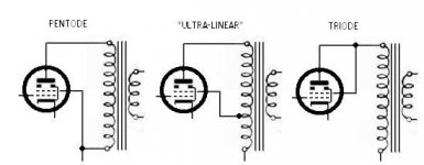

Oneday I will want to build a "classic" tube amp. The Mullard schematic posted here, is using the el84 in pentode right?
So I suppose I could ask for a UL tap as well when getting the output transformer wound? Then I could add a switch so I can switch between UL and triode mode.
When disconnecting the ul tab with a switch how should I wire the screen? I am still confused about triode or pentode mode. When I pseude triode mode I should just connect the screen to the anode via a small resistor?

Yes, the EL84 is run in penthode mode.
You could ask for an UL OPT, no obligation in actually using it though.
You could ground the screen or tie it to the cathode.
No, that is regular penthode mode.

Bas, using a resistor is still "triode mode". The decware amp, among hundreds of others use the resistor to limit current flow surges - thus protecting the screen grid. In class A designs, they are not really needed.
So, in your amp, either the screen will be connected to the UL tap, or directly to the plate.
In no case would you ground it - I'm not sure why Frank suggested that. He is thinking of the "suppressor grid", G3, maybe? This is tied to the cathode internally.

It doesn't matter where the suppressor is connected. It has a coarse pitch, and electrons with any reasonable energy fly through the gaps. It's only there to repel the low energy ones from the anode in pentode mode. The valve would work ok without it, just with a kink in it's characteristic.
It's the screen grid (G2) that's the important one:
If it is connected to a supply, it determines the pentode charcteristics of the valve.
If connected to the anode, it becomes part of the anode. This is a psudo-triode.
If a resistor is fitted in series with G2 to the anode, things become more complicated. Voltage is dropped across the resistor, and the G2 and anode voltages will differ. The valve will be neither triode or pentode.
If G2 is connected to a tap on the output transformer, it's still a pentode, but the feedback to G2 tends to improve performance. Some say it acts more like a triode.

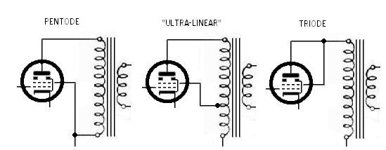

Bas and John,
Bas--I don't see the cap that decouples--so, still not getting that part.
John--
Doesn't tying the screen to the anode or supply result in essentially the same thing--positive wrt to cathode and current flow? (Voltage drop across tranny is not significant? )If so, then how is pentode mode different from psuedo triode?
Rick
John--
Rick
fragman56 said:Doesn't tying the screen to the anode or supply result in essentially the same thing--positive wrt to cathode and current flow? (Voltage drop across tranny is not significant? )If so, then how is pentode mode different from psuedo triode?
It is VERY different, because when the screen is tied to the "bottom" of the output transformer, it is seeing none of the signal voltage from the plate circuit, since this develops across the output transformer primary winding. If we move the tie point further up - to say 40% of the winding, then we have ultra-linear. The screen grid is now "seeing" 40% of the signal from the plate circuit. Move it all the way up, so it is connected directly to the plate and it is now seeing 100% of the plate signal. It now IS the plate! That's why we say it's now in "triode mode".
Now do we get it? 😉

There are some problems with psuedo-triode mode that are not huge but benefit from some attention.
1) it is possible for the direct connection of screen grid 2 to the anode to induce high frequency parasitic oscillation. One cure for this is the low value resistor in this connection either between sg2 and anode or at the anode( in stopper mode) with the sg2 connection made to the b+ side of the resistor. Of course this introduces some feedback into the equation but it is usually regard as trivial.
2) with sg2 and the anode at the same potential and sg2 seeing the electron flow first, sg2 has a tendency to act as the anode itself and hence a relatively high current can flow through sg2 shortening its life. This can be overcome by introducing a small voltage offset between the anode and sg2, bypassed by the signal. Typically 30Volts is an effective voltage offset that causes almost all the current to flow through to the plate. The 30 volts can be easily obtained by as zenar diode string of six 5V6 zenars as these have almost zero temperture coefficent and almost zero noise. Bypass these with a high value 'cerafine' capacitor or it's ilk and the triode usually sounds better than without the offset.

If not too
much trouble, could you sketch it out (rough is ok with me and Bas, I suppose).
I am assembling my SE El84 amp now with 100 R between grid 2 and plate but would like to try this out before too late.
