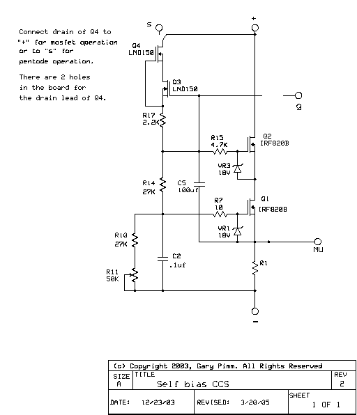

Definitely Gm. Ideally, the top tube would have a cathode follower Av= 1. That way, the bottom would see a pure CCS.
"Any rules of thumb for choosing the top tube?"
No, not really, though it would seem that a MOSFET works best up top.
