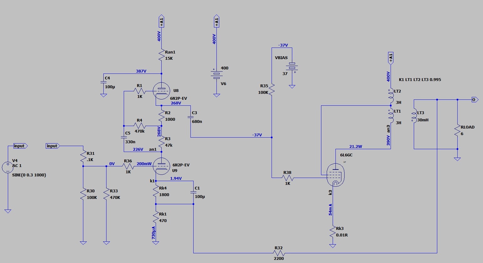

Hello I want to build a new amplifier using ECC83-12AX7-6n2Pev (all equivalent) and one 6L6GC in SE with GNF (no others please, because I have a lot of them).
I never played with mu-follower.
Can you please check if the mu-follower schematic is correct and which values you would suggest (using the above tubes)
Available AT is 320VAC so I think to get 400VCC.
Second question: what about two ECC83 in series and a 6L6GC with GNF? It gives me a much lower THD% (second scheme) and a much bigger input sensitivity: should this sound better?
