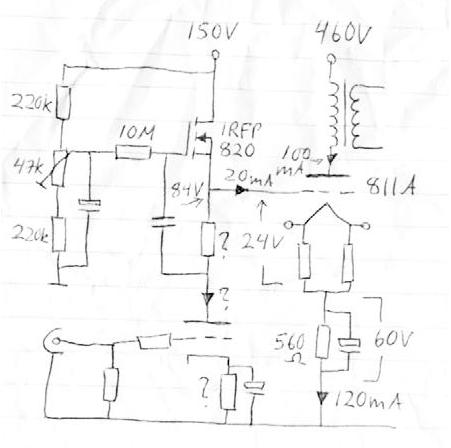

I´m a complete newbie when it comes to Mu-followers, but as far as I can understand such things would be great as drivers for power tubes that draws grid current (A2).
The power tube I´m thinking of is 811A, which requires about +20-25V and some 20mA into the grid at idle.
I´ve powered such tubes before from beefy cathode followers but now I´m looking for more elegant solutions.
According to my way of thinking the mosfet is the one that does the job, the bottom triode only controls the mosfet. Since the grid always works on positive voltages the mosfet only has to deliver current in one direction, so to speak.
Am I completely lost here???

I believe so, but they would require a high current to get the low output impedance.
I have tried a 12gn7a triode strapped with a mu follower sinking 30ma. From memory acroding to gary pimm, he mention that is mu follower's rp would be determine by the current following thru the mosfet. THe higher the current the lower the rp. with 30ma rp is around 40 ohms, as i recall. So in this case the bottom tube should source more than 20ma so that the top mosfet would be able to source 20ma for the idle state. What happens with a mu-follower is basically a common anode going to a cathode follower in this case a mosfet. This way they also actively load the tube too. Basically i figure that mu-follower work as a team, tube provides voltage gain and mosfet provides current. That way they are more optimize that way.

Thanks for the answer!
One major problem here is that the tube has to be able to work at a low plate voltage, since I want to keep the voltage drop across the 811´s cathode resistor as low as possible.
If it also has to sink lots of current, well, mission impossible🙂
The 811A draws almost 100mA at the peaks.
Maybe a more ordinary triode gain stage followed by a mosfet would be a better idea in this case?

I've been wrestling with a similar problem myself. There are some good pages at the Tube Cad Journal explaining SRPP function that might apply. On the Svetlana site there is a tech bulletin for the sv83 that is a mu follower with a pentode top. This would act more like your fet, and reduce the equation for Rak to a matter of transconductance. According to Svetlana, the circuit given will drive an SV572, but that only takes 50mA.
It occurs to me that the asymetric current possibilities might lend themselves nicely to driving class A2. I was thinking of going with split +- supplies and direct coupling, allowing the bias to be derived by a set difference in supply voltage. Thinking this way, the negative swing is through the bottom triode. This can potentially mess up this topology for pushing lots of current. Good thing driving A2 doesn't need much current when driving the grid negative. The positive swing is provided by the top element. As this is a cathode follower, current is the name of the game, and it should provide nicely. I'm thinking of an EL34 or KT88 for this tube. I'm still trying to figure out a nice triode with a Va of around 600 to 800V.
So it's actually a push-pull circuit, and as you said, the top element can deliver the current when needed.

the mu-follower should have twice the voltage on the plate +some add. to turn on the mosfet. Or not you are going into distortion.
For instance take your B+150Vs
The triode plate voltage of say 80 volts, the tube can only swing 50-60Vpk to pk only after that it would be distorted. Normally mu-followers used cap coupling because the B+ must be quite high around 300 and above so that the bottom tube does not run out of voltage to swing. But even with mosfets they need 20 volts extra you will still be insuffice voltage swing, pentodes would be worst like the el34 needs much more around 200volts extra

I don´t think 811´s need much more than 40-50V peak to peak, so the voltage swing is not much of an issue. At least not when compared to other big triodes...
Current swings from about 20mA at idle to 100mA at positive peaks and almost zero at the bottom. The grids internal resistance is quite nonlinear, so a low driving impedance is necessary.
