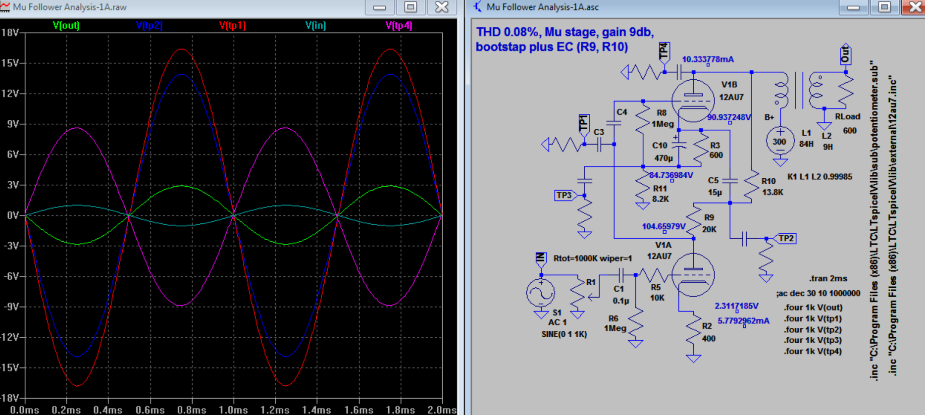

Alastair E says:
"a pretty mediocre top active device"

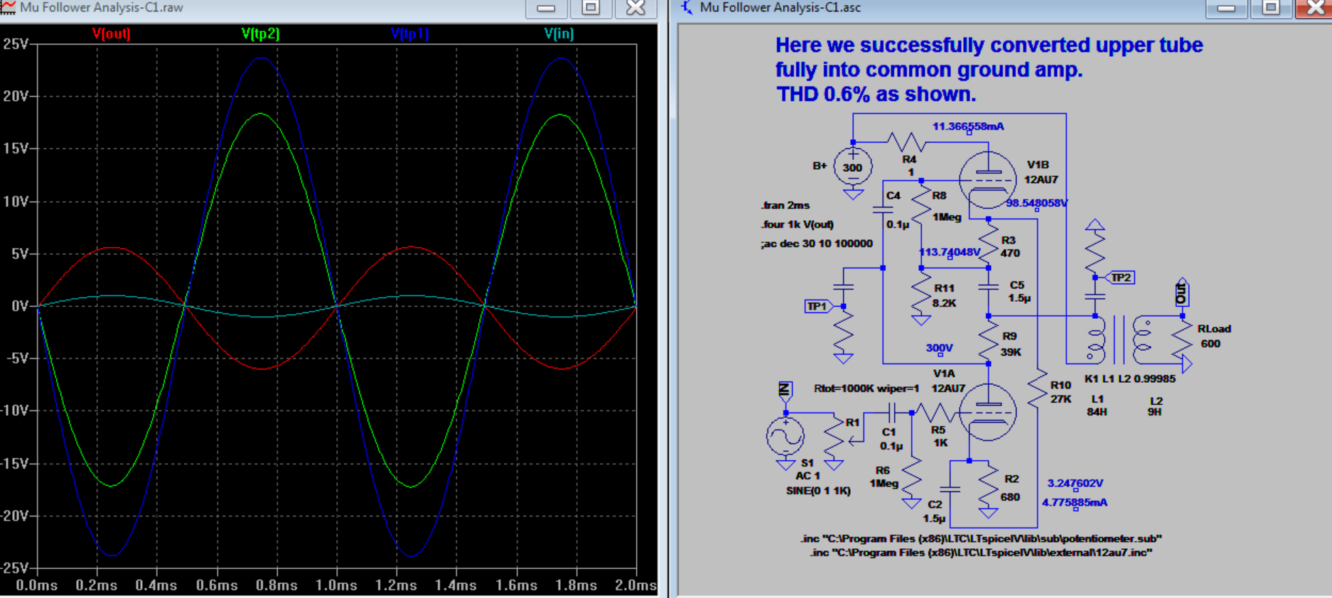

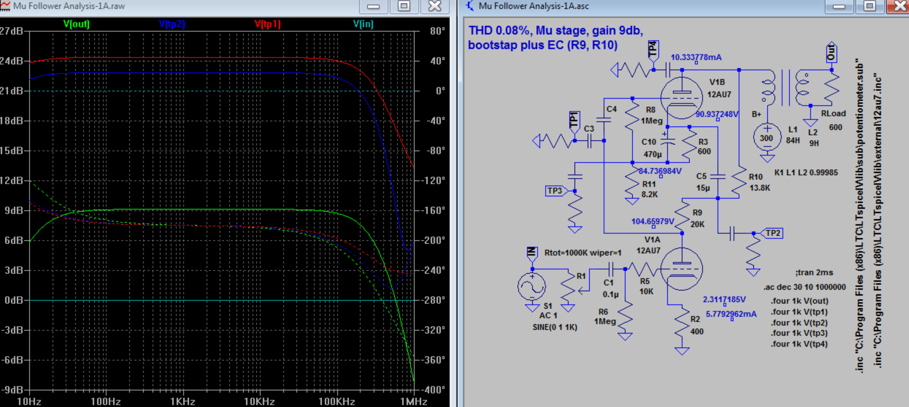

Here I have connected the bypass cap to top cathode via a resistor. This increases much (adjusted) gain for your need. This also fully converted the upper tube into a common ground amp, making it a dual common ground amps, let me know your comment.
If stability is a concern we still can loop some global nFB from top plate to bottom cathode. Mona, I am adopting your sch, please take a look.

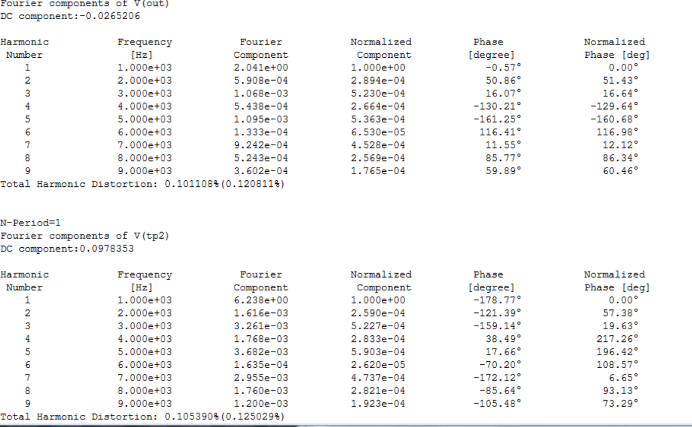

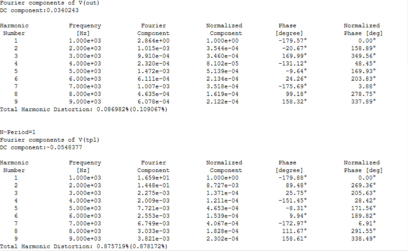

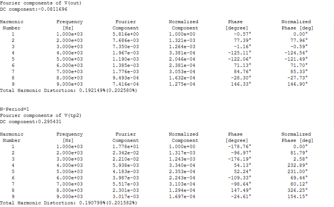

Edit: THD 0.192149%(0.202580%

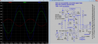

Output impedance is irrelevant for calculating the boostrap resistance, as you should always calculate voltage gain assuming no external load. For a mu-follower (or any other CCS-like configuration) the impedance presented by the upper valve is ra+(mu+1)Rk. Use this to calculate the voltage gain into an open circuit.Koonw said:I just wonder how is the dynamic or bootstrap resistance is calculated if output impedance is significantly higher than CF.
Then, find the stage transconductance into a short circuit - bootstrapping is disabled by the short. Divide one into the other to find the output impedance.
It is a CCS for voltage gain into an open circuit, but not for transconductance into a short circuit - hence lower cathode bypass affects output impedance. Note that as soon as you apply an external load the bootstrapping becomes less effective; your factor of 0.9 is just a wild guess on this, so better to actually calculate than guess.But if it is near CCS, bypass or not make no difference, but in practice some do notice a difference.
I'm not sure I understand the question. The only place for mu-follower output is the upper cathode. If not, it is not a mu-follower.And where in your opinion is best place for output?

In what sense is a top triode 'mediocre' and a pentode or MOSFET 'better'?
Cheers
Ian
Yes of course the top tube contribute most of the output, if not all. Should it be right on top of cathode or at the bottom of cathode resistor? If on very top, that would includes the self-bias circuit of top tube, what is your insight to connect on top, distortion and sonic wise. So this is FAQ question, but in particular the Mu follower Rout is already higher if connect wouldn't it load down further (so is the rest of bootstrap path as you pointed out)? TIA
In your last schematic you introduce positive feedback via R10+C2.More gain, more distortion !

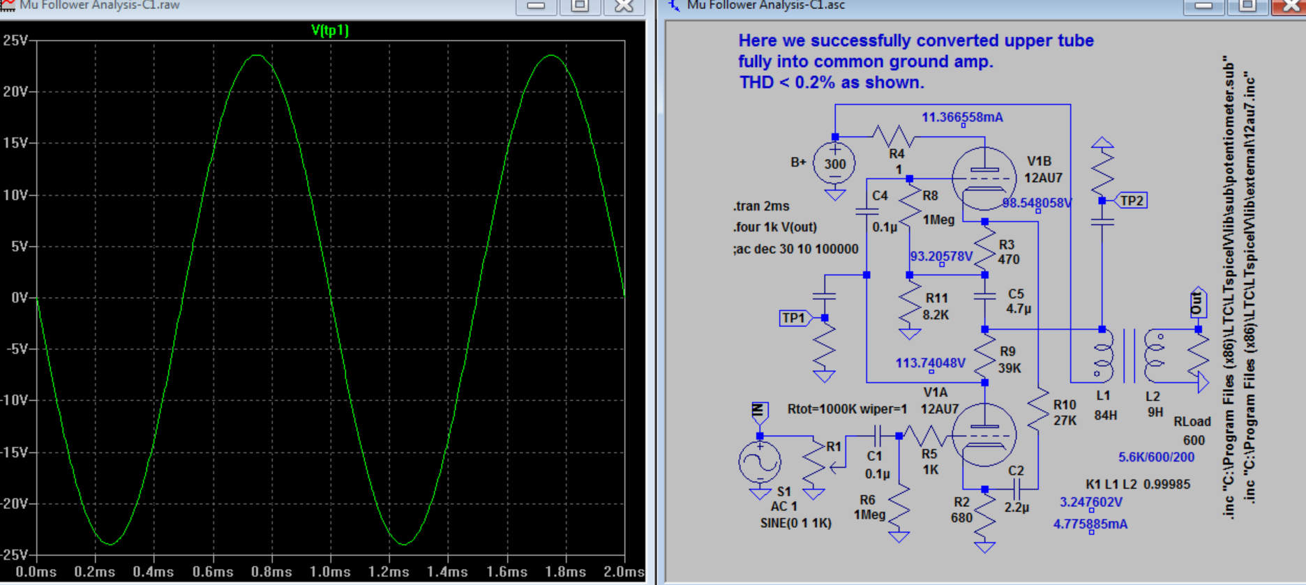

Mona

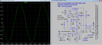

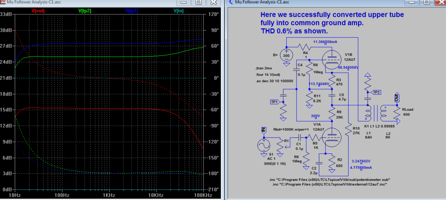

Yes, that 0.6%, but I readjusted value got it down to <0.2%. After all the beauty of this circuit more PF less distortion, believe it or not. I tried nFB, the distortion is higher, so go figure 🙂
I check with sim for open circuit gain of the top tube is 8.41 in 7.21 out, so 7.21/8.41=0.857, yes lower than 0.9. So 7700/(1-0.857)=54K, compared to 77K if 0.9. If connect via cap to bottom tube, it is 0.846 which gives 50K. So have to increase bootstrap resistor from 8.2K to 33K makes it effect resistance over 200K.
Reference to sch of last post, with this bootstrap I only get CCS for a particular output level, varied the load the current stays the same, but if a different output the current is another value, the current goes up as load goes down, appears to give better regulation.
So--22V ish peak, and 0.6% dist. Not hugely better than that could be obtained by a plate resistor.

And with C5 at the other end of R3 ?
Did you measure the distortion at the same output level ?
Mona
Mona
Mona
Yes, that is TP2 right? Distortion for both are < 0.2% (note that TP2 level is much higher.) If same level it is 0.104722%(0.121679%).

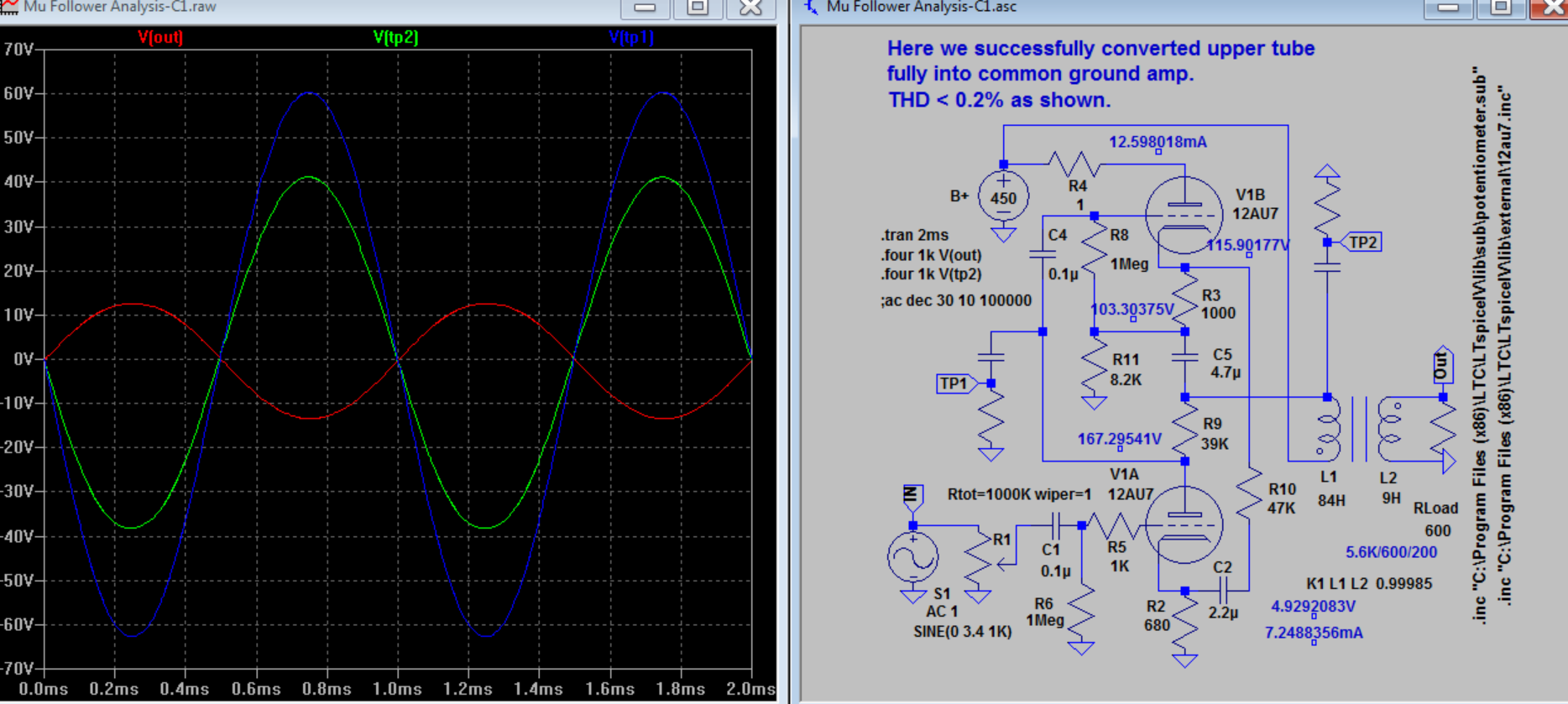

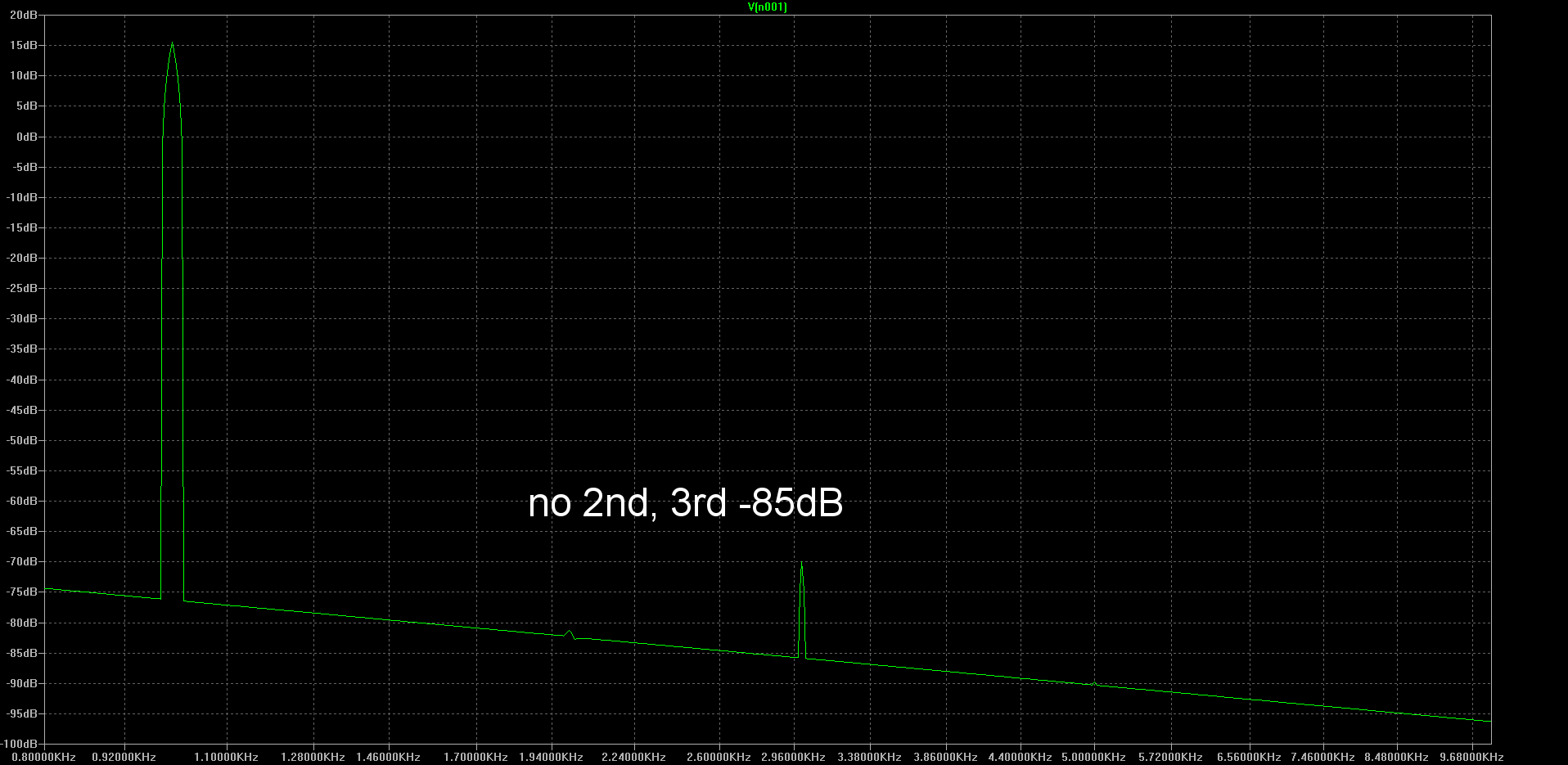

2 tubes better than one, apply more voltage up to 500V, more swing. Here is 60V snapshot at 450V, but distortion has not been fine tuned.

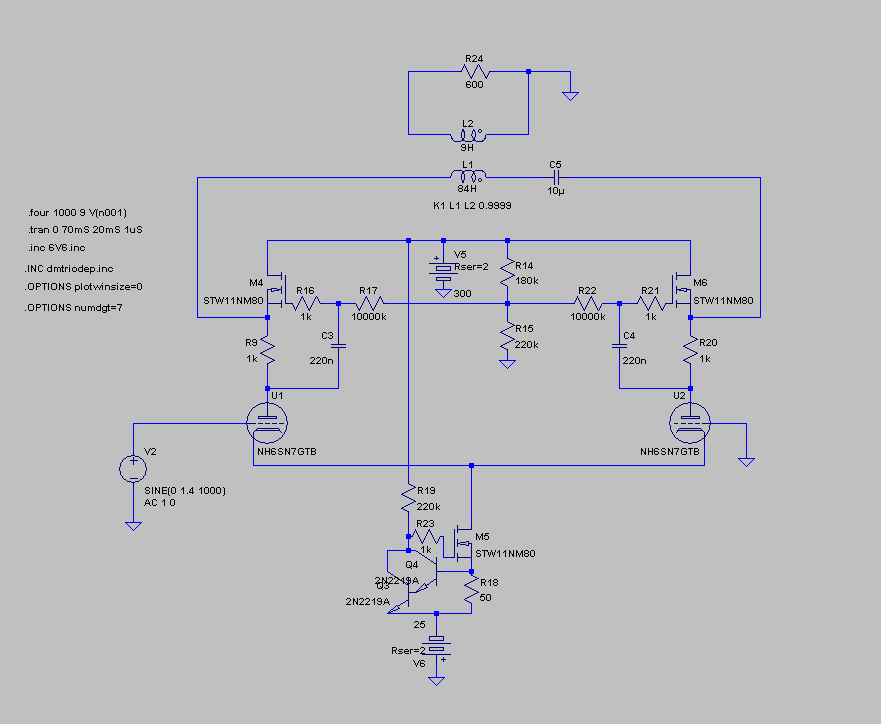

It would appear that you are going towards something more like a totem pole balanced P device and N device with self split kind of arrangement instead of a mu follower.
I would advise you to drive your headphones with a long tailed pair.
When building open loop circuits, first step is to choose a tube with good curves. That leaves 12AU7 out of consideration; instead, choose for example 6SN7 which is cheap and easily available, and has good curves.

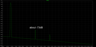

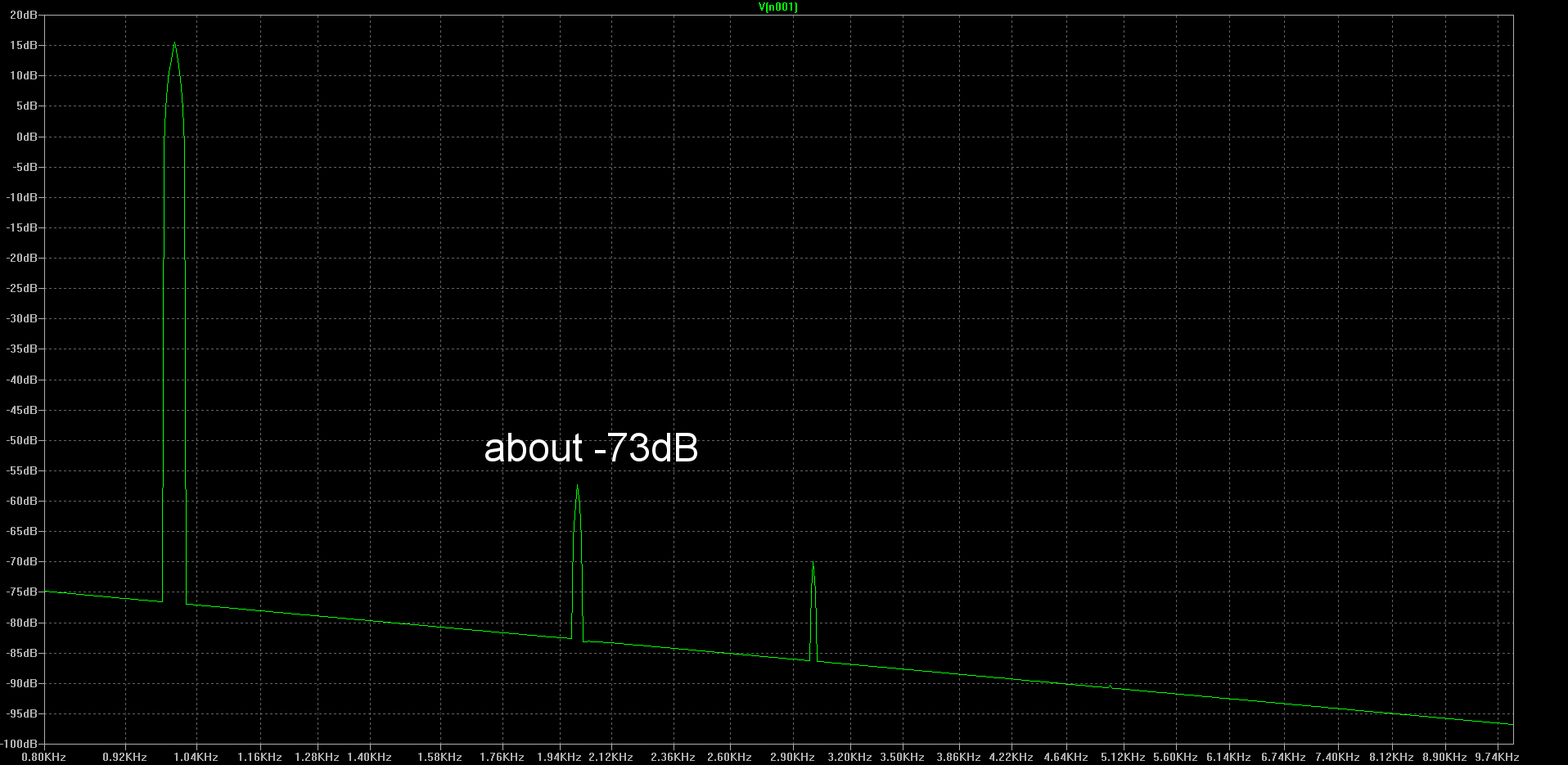

Attached is my 6SN7 LTP schematic. It can be driven with a single input (other input is then grounded). This will increase distortion a little bit. Best results are with a balanced input (driving both inputs).
Sims are of course sims and numbers are presented only as a curiosity, but this circuit does in fact produce incredibly clean output for small power needs such as headphones. I've done this with a number of tubes including 2C22 and 6SN7 with excellent results.
With 52 VPP signal between plates;
Single input: Total Harmonic Distortion: 0.023%
Balanced input: Total Harmonic Distortion: 0.005%
Attached also FFTs with single and balanced input signals.

Yes 12au7 has higher distortion, and I heard folk say can do 0.2% at 10mA CCS. Why it should be different in your circuit or have you built and have already compared the sonic difference, so the conclusion is the more linear the tube, the better sound it is to you but not to everyone. Sorry no negative comment is intended, I just a bit disagree with basis of your advice.
