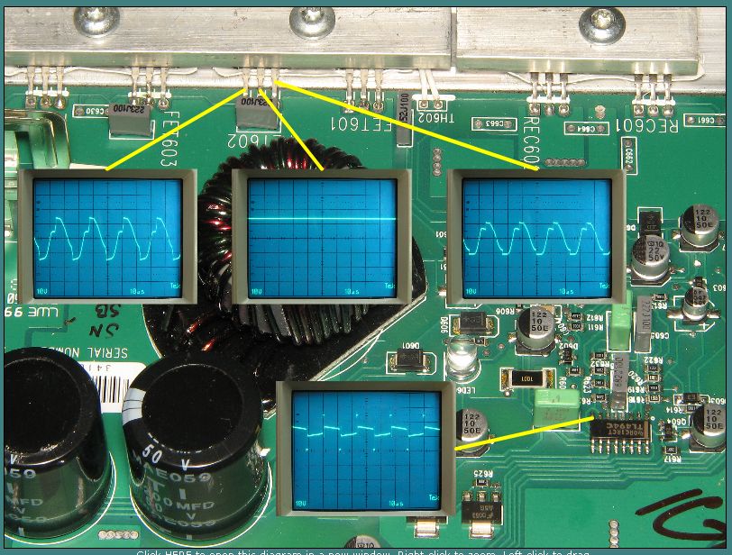

ok so i am working on a mtx again. I have a square wave at the gates but i have 0v as well. So i. could use some help getting the power supply up and running.

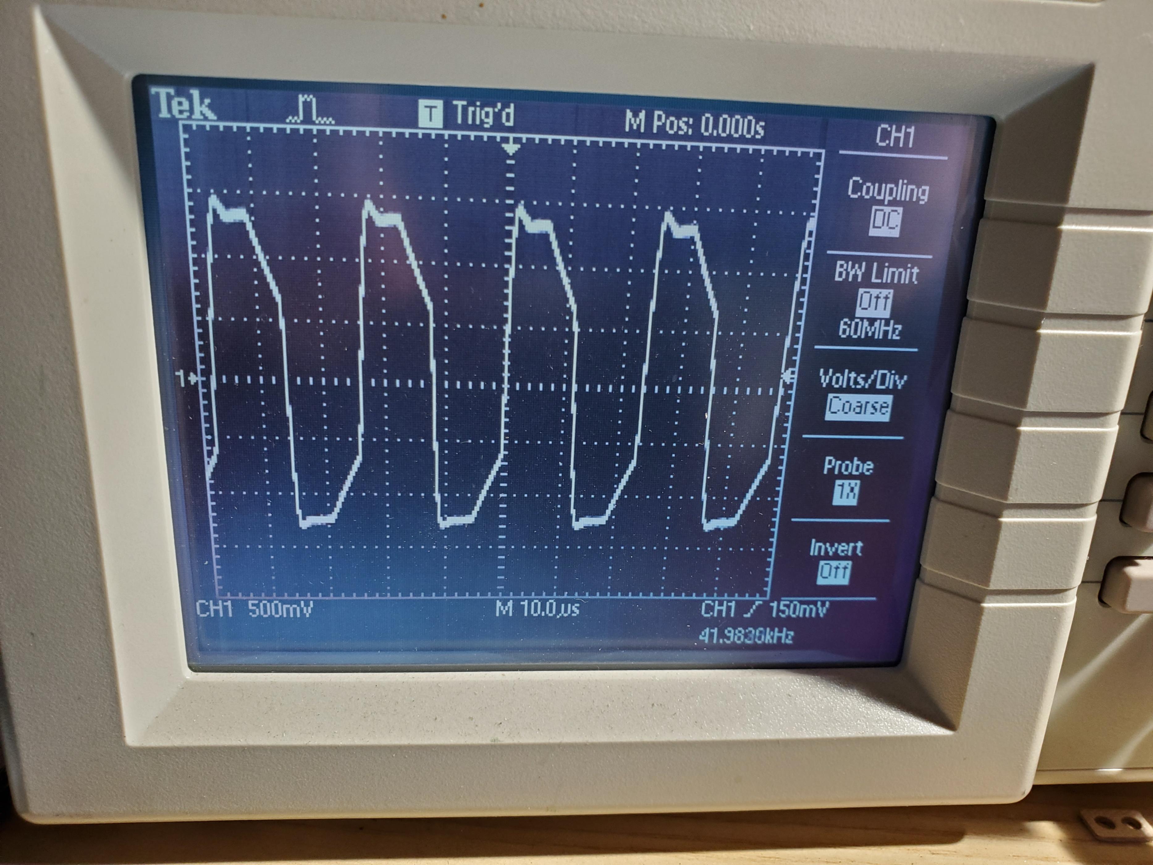

here is the drive signal. The problem is no audio, current draw is not even registering on my power supply's gauge.
This is the drive wave on the pads.

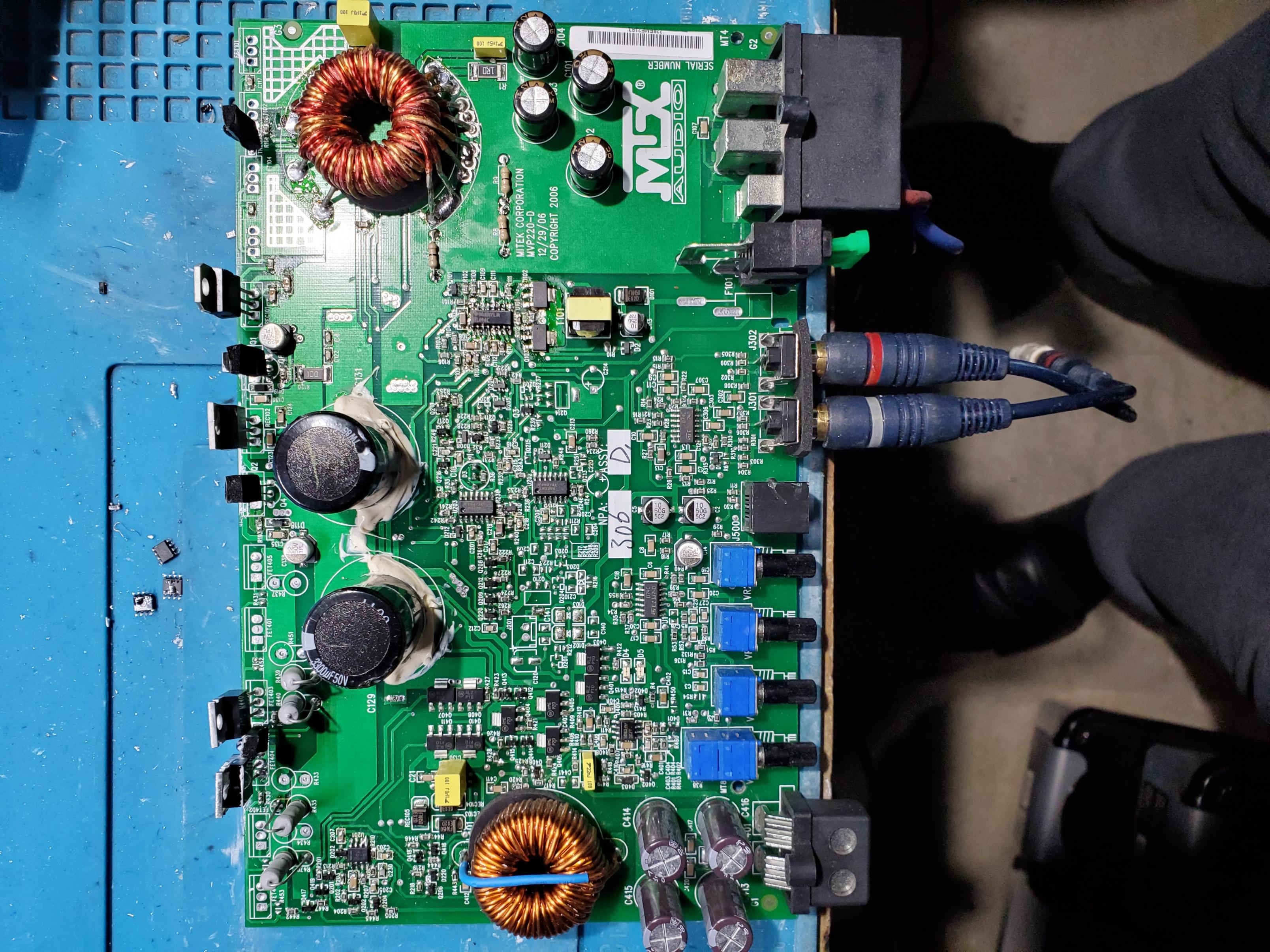

One of the mspa56 transistors was failing intermittently. when i first tested regulated was present +-15vdc then just now it was missing?

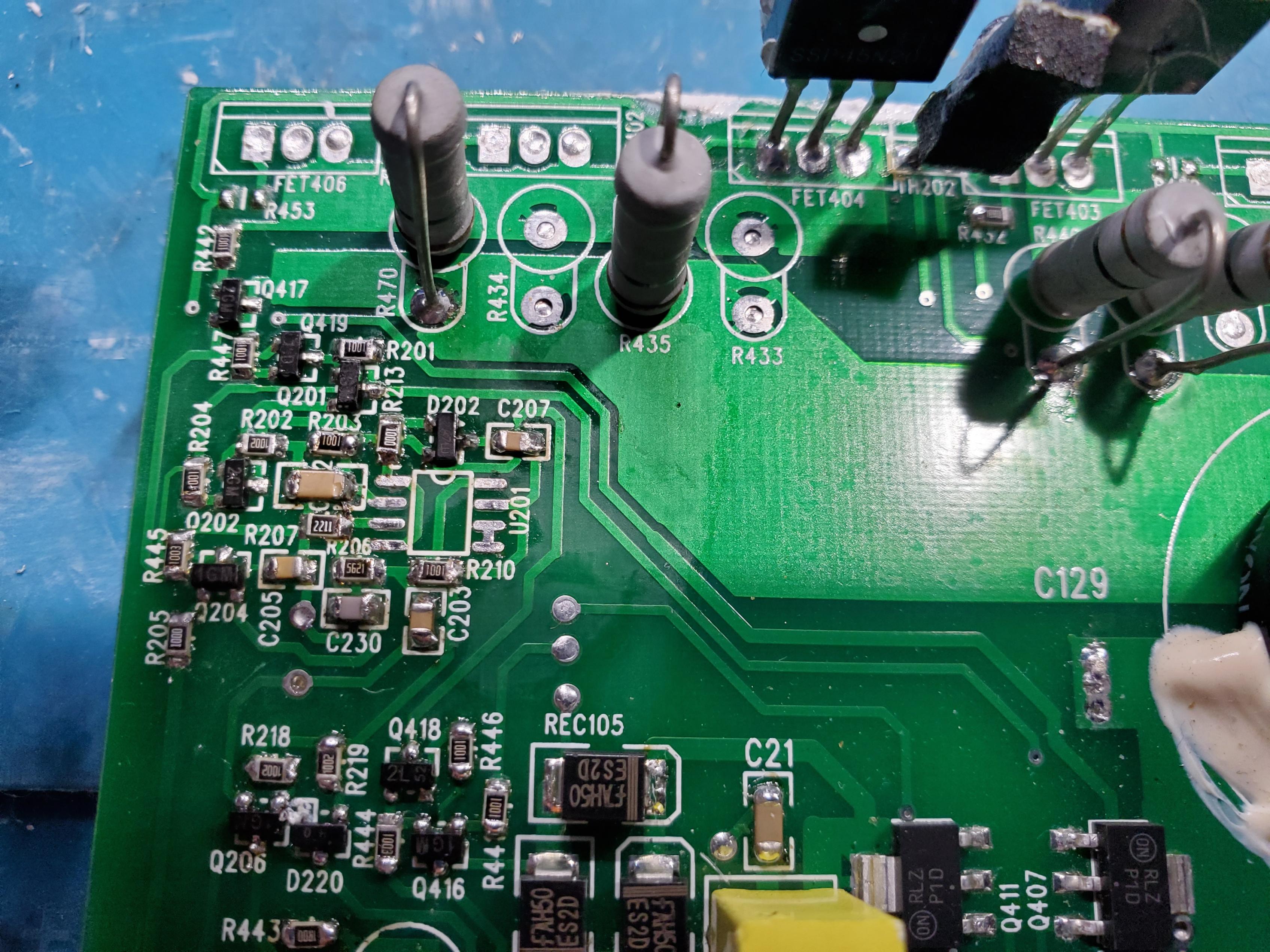

So i replaced it and it is now drawing current at idle., but i has the 45vdc on the speaker terminal. i pulled both outputs and tested them both were good.

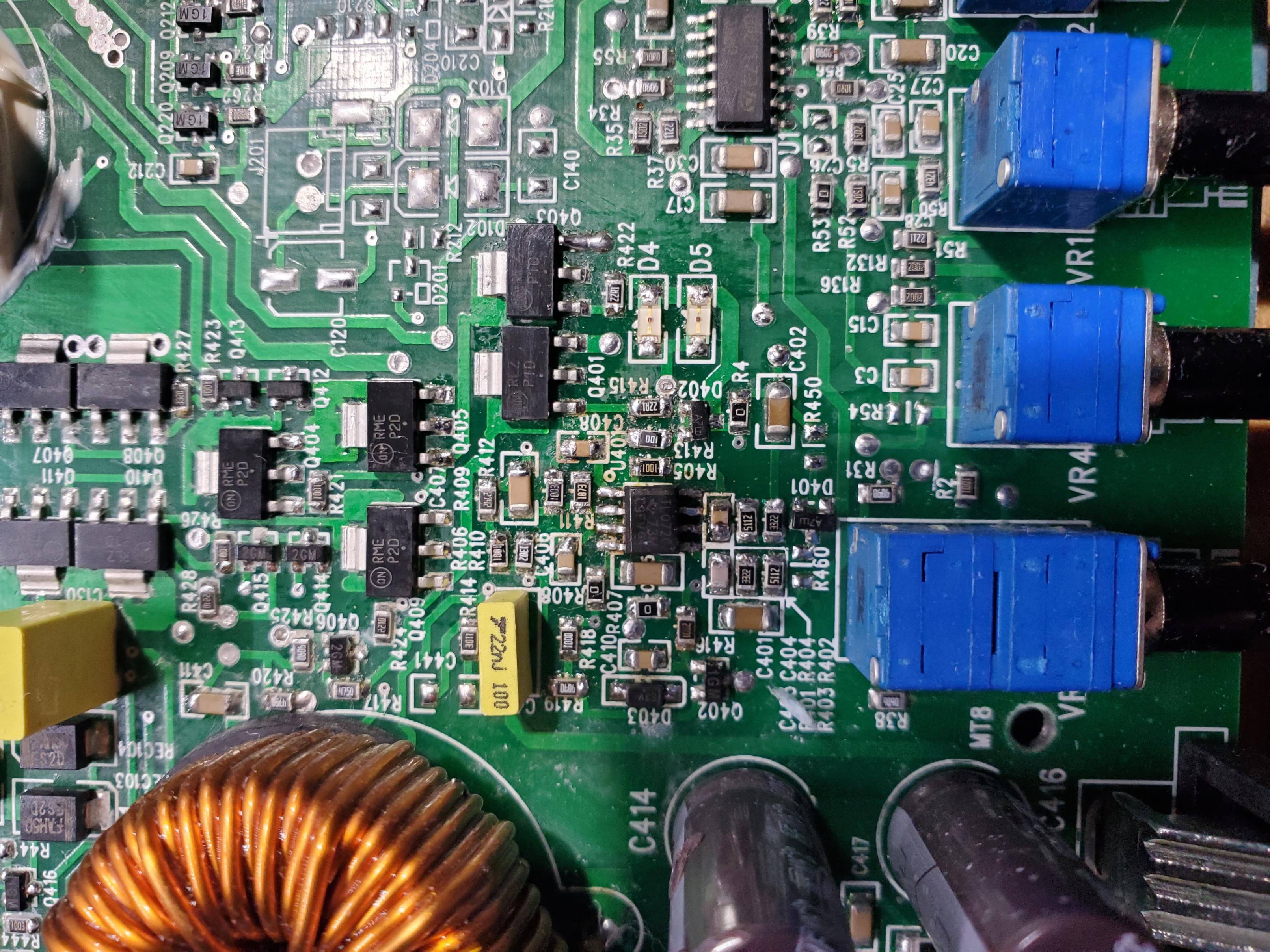

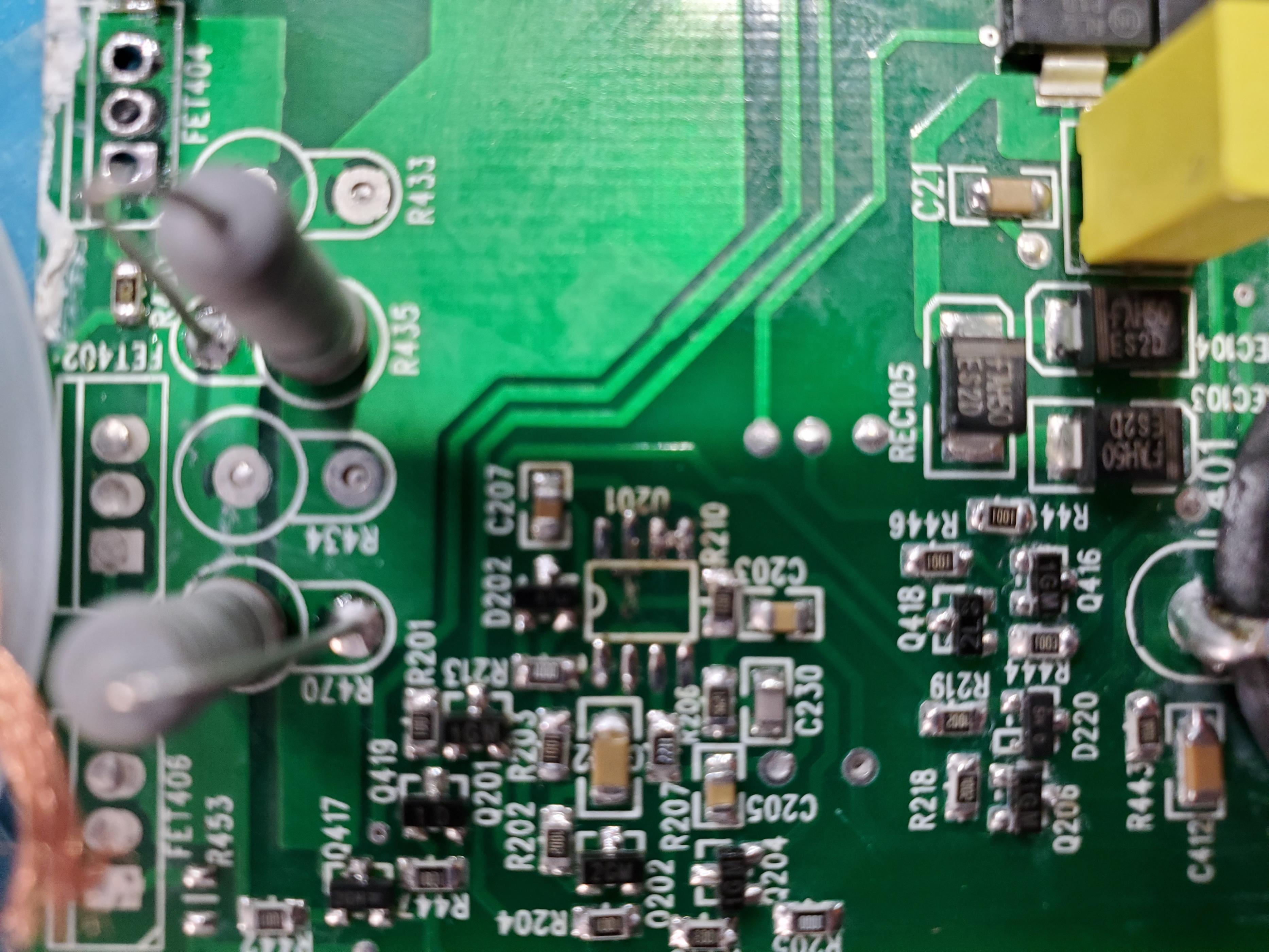

This area is where the resistor burnt up. i replaced it with the 1001 and it burnt up, so i used a 10R and it has not burned.
Yet i still have DC across the speaker terminal.
