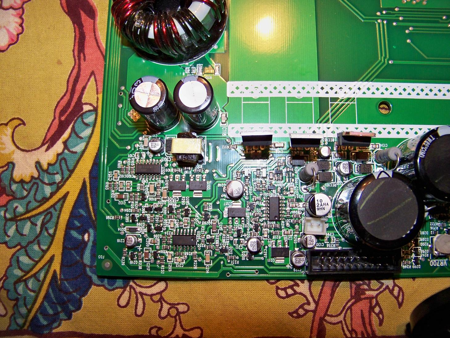

I cannot be sure about the signal I was seeing at the outputs. It happens so quickly usually all I see on my scope is a random flash-change off flat-line.
With the outputs removed from the amp everything still power cycles. I've got the outputs installed right now but will look at removing them if nothing else.
Kev79,
I actually never fixed this one. I still have it in my posession though. I had verified with another MTX that this one's pre-amp board was in good condition. In one of the previous posts from Perry, I had taken his advice and removed Q102 with little effect.
