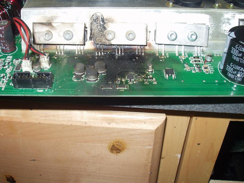

Do NOT power this amp up without having everything clamped down. The regulators (especially the positive regulator) can fail within seconds which can cause components to fail throughout the amp.

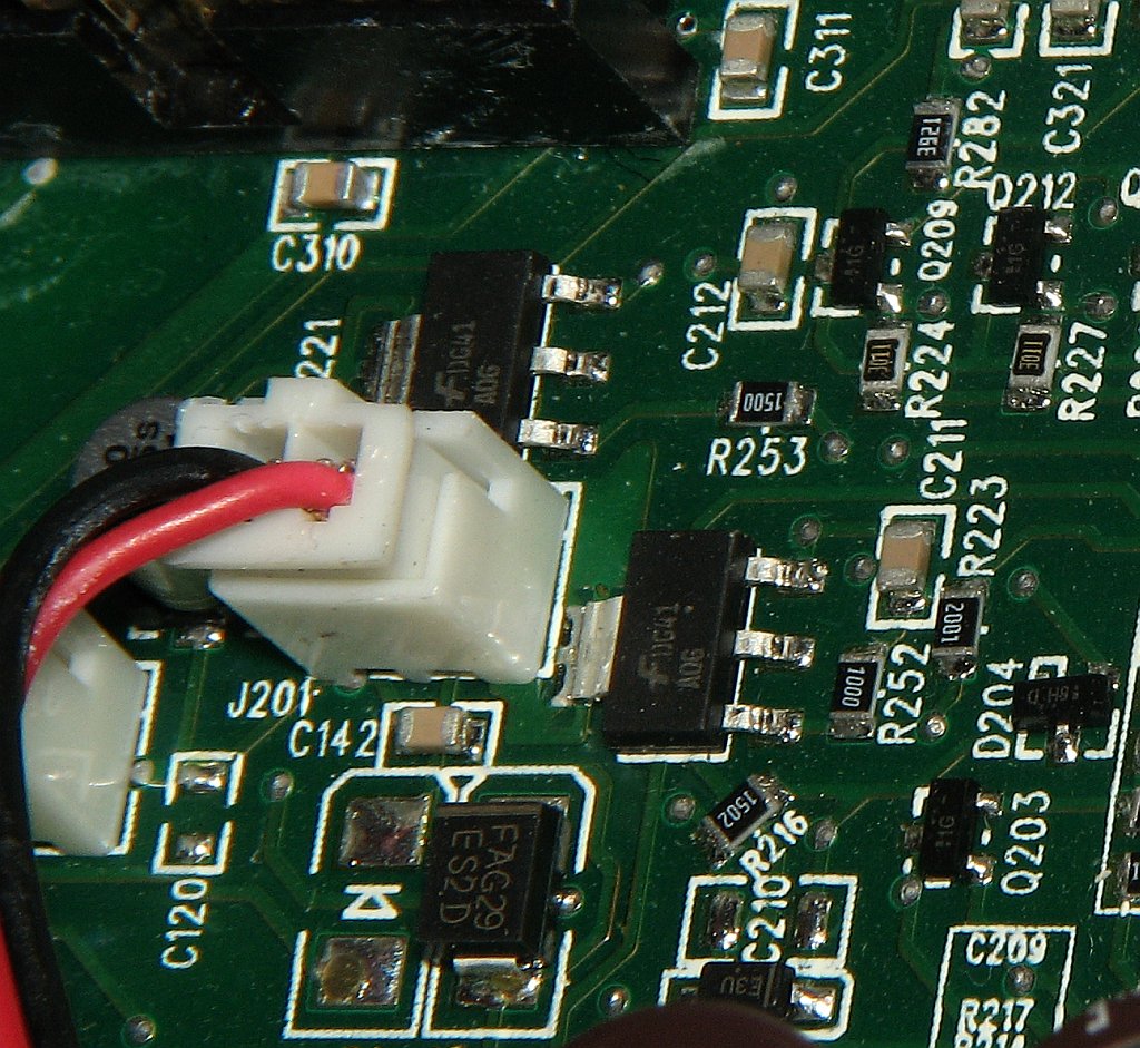

I have damaged my MTX 81 001, missing pieces in the power and want to help me with the values, these are:
Q210 and Q221.

Q221 is a PZTA06. I don't see a transistor with a circuit board designation of Q210. MTX will give you the part number if you email them.
MTX 81001 DAMAGED HELP..!!!
This transistor is next to Q221, and is the same size, and is connected to the base with R252 = 100 ohm
