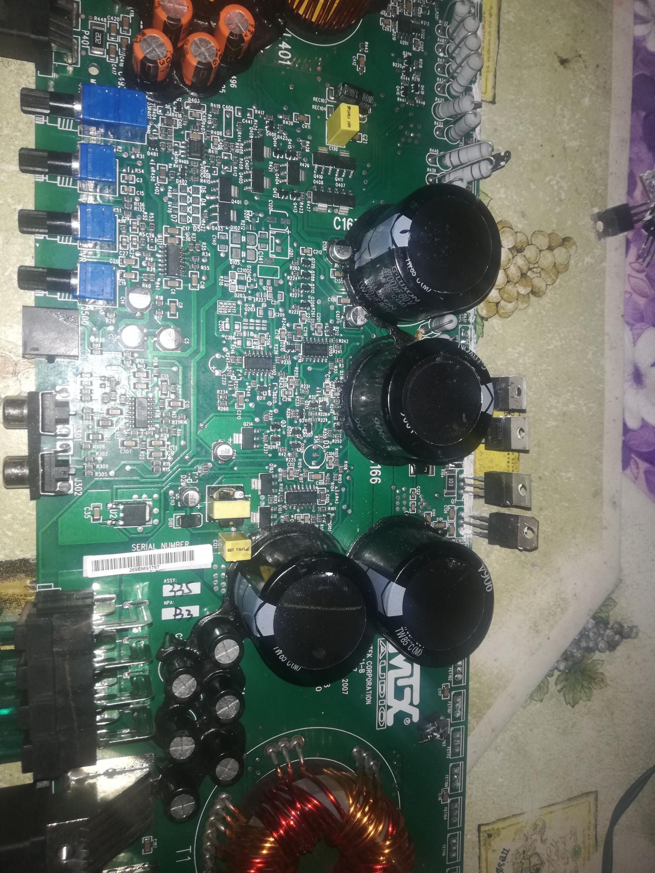

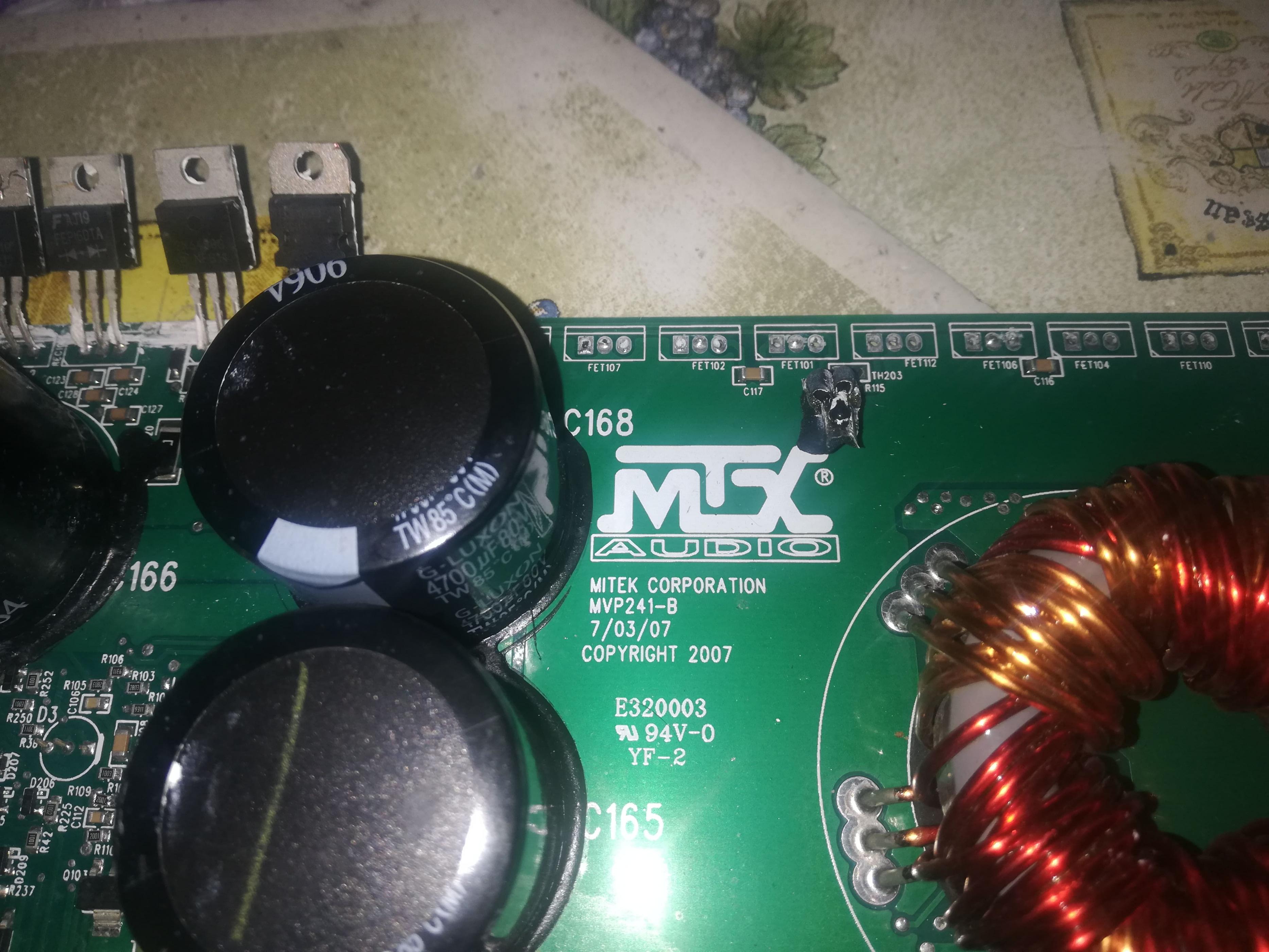

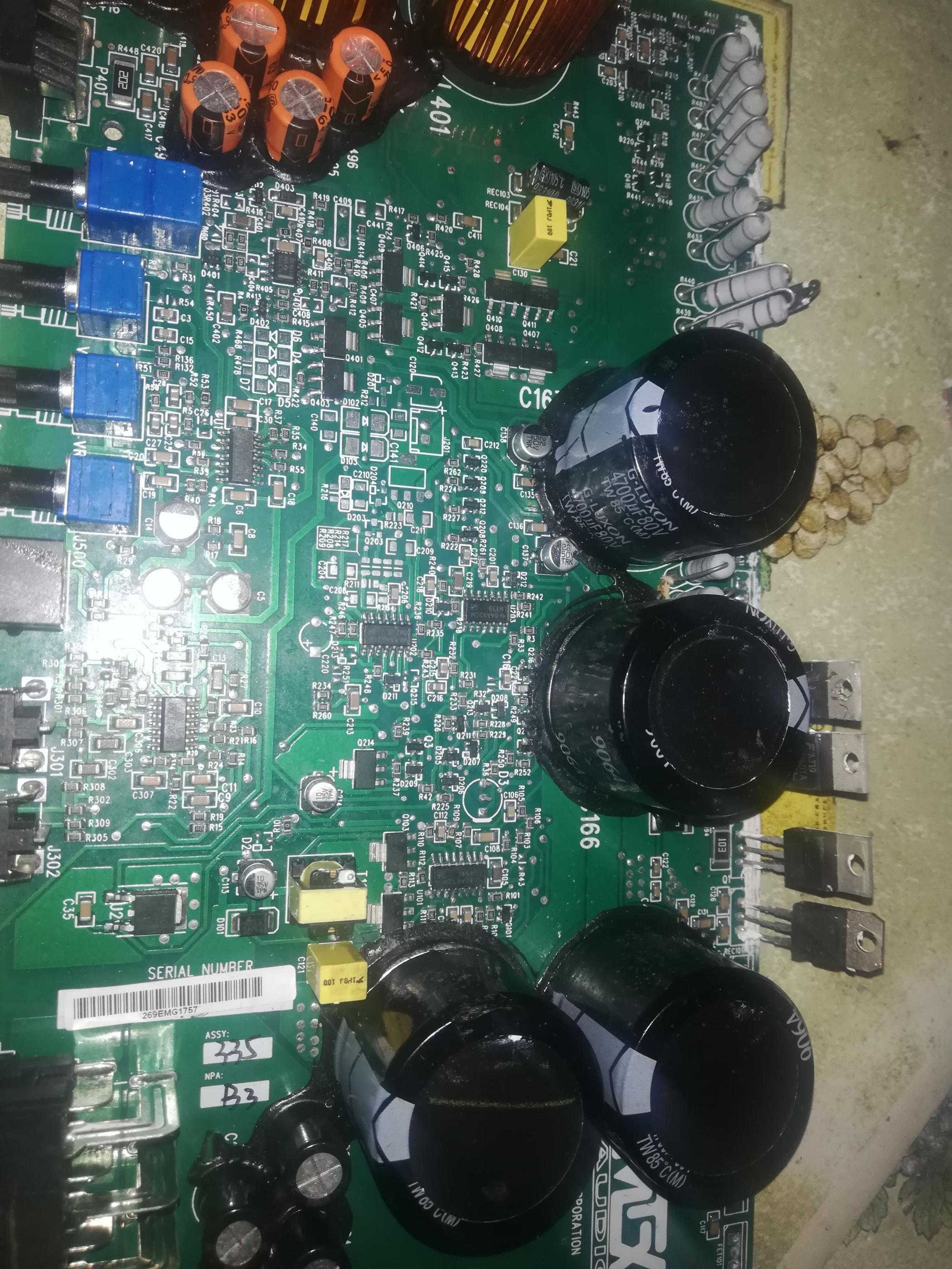

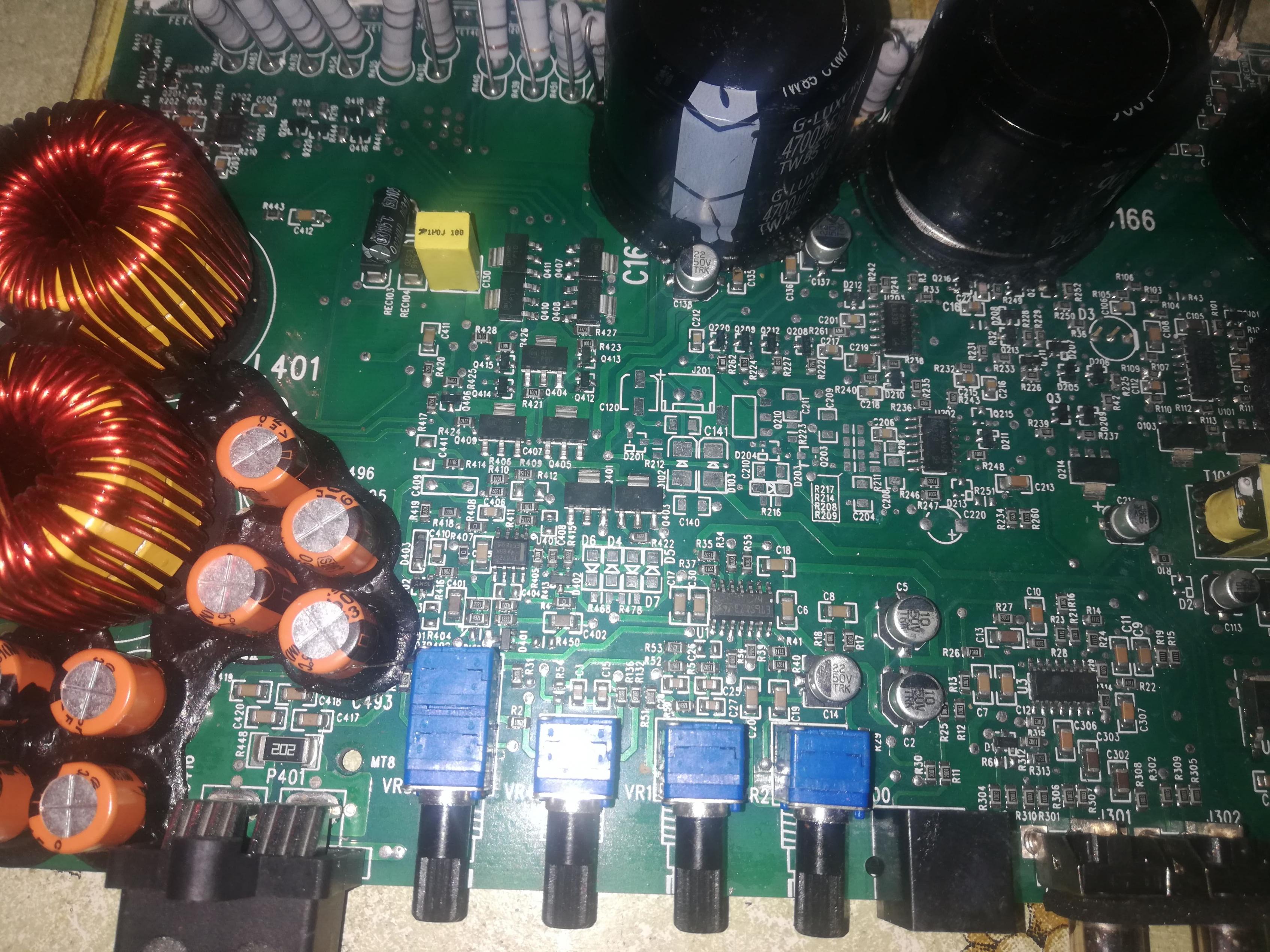

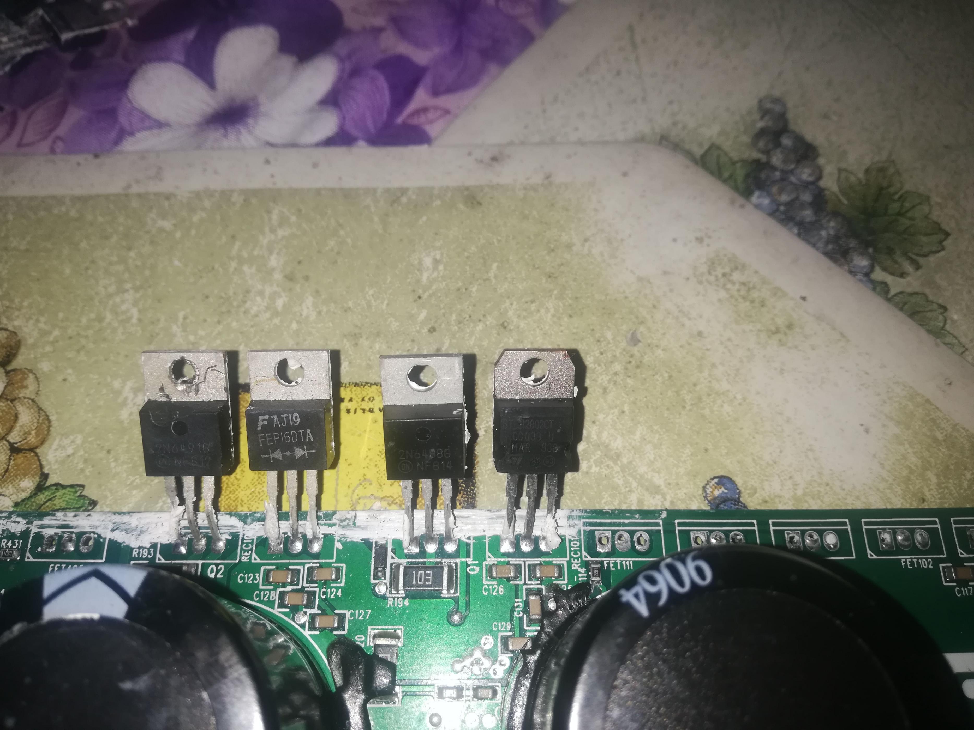

Good morning Perry, sorry for the image quality is what I have at the moment the camera still does not arrive and well I discovered that it is in equal protection raise Q101 next to R101 and pin 4 of the tl494 fell to 0 volts I can not find that I can be pulling on the base of that transistor. I told you that I also changed the lm339 but nothing remains the same in protection.
