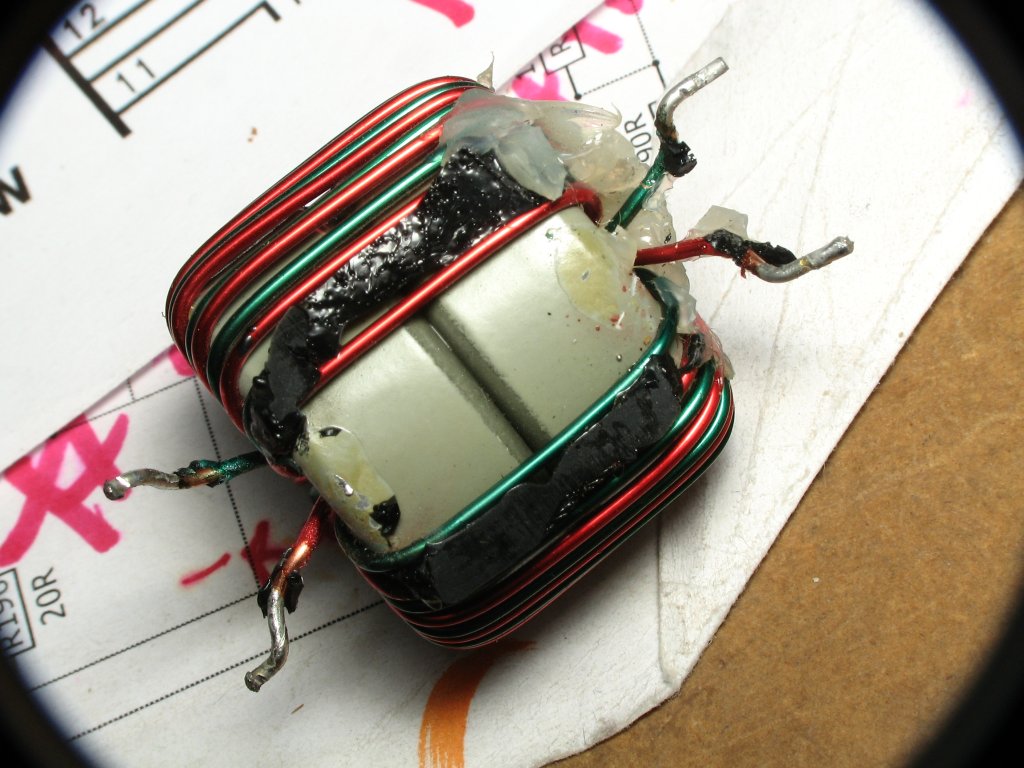

I got replacement cores from junk MTX amplifiers, not worth repairing. like 251D and 311D, etc.. which the double stacked/glued cores are identical. Now i just need to get the windings right.
It's not possible to tell if the cores are identical to the original ones without testing. If they are the same, you can simply wind the cores the same as the originals. I don't know if they are the same as on the larger amps. The 92001 used 27 turns of parallel red and green. The attached photo shows how the windings are configured to go into the board.
