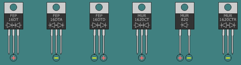

My initial diagnosis is that it appears the rectifier is shorted (FEP16DTA).
Putting the meter on diode setting, all combinations show 0v (tested on another diode and I can get the 0.4V forward, and 0V reverse).
So replace this I think?
Secondly, the second rectifier (U1620 I think), seems to be a 'ultra-fast' rectifier. It has A K A on the package.
I get 0V between pins 1 and 3 (A -A)
and ~0.4 with COM (black) on pin 2 and V (red) on 1 and the same for 3 (I think this looks OK)?

One quick question, the FEP16DTA appears to be 'glass passivated' whereas the more readily available FEP16DT isnt.
What would be the effect of using the non-glass passivated version?
I read that it means less leakage, but real world..what does it manifest itself as? (background noise/hum/amp not working 100% efficiently?)

The glass passification is part of the production process and isn't important. The DT isn't the same as the DTA. If you can't find the DTA, use the MUR1620CTR.
