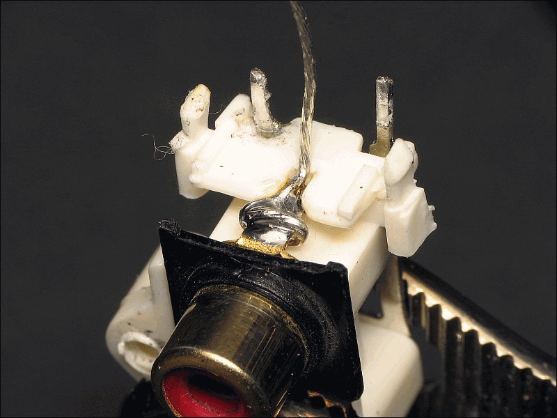

You can generally repair these.
One problem is finding them with the correct right/left configuration. The 4-jack Rockfords have two rights sharing a shield and two lefts sharing a shield. The Orion style have the right/left sharing a shield but the right channel is near the board. The MTX jacks have the left channel near the board.
The best option may be to repair the shields as shown in the attached photo.
