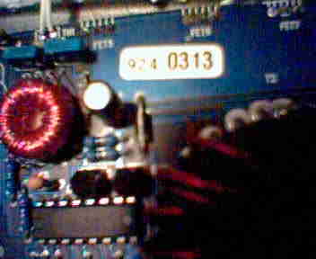

Hi, i have installed the components, and when i try to turn the amp on, it turn on for about 1 second, and then it turns off, all fets are in good condition, i do not know what is happening, my power supply gives 17 Vdc, could this cause the amp protects it self (overvoltage)?, i put a 3 amperes fuse, the amp in rest should consume 1 or 2 amps max (i think, because other amps i have consumes that)

I going to use another power supply at 12 volts
I have a digital multimeter, i have not conected any speaker to the output,but first i giong to use a 12 volts cd power supply, if the amp steal turn off i going to use a speaker an se if i got sound
i was thinking about the lm339 or the tl494 or some bad capacitor 😕
i used a 12 volts power supply and the amp do not turn off, i conected one speaker to one channel and work fine at low volume and the other channel works fine too.
there is only one think that worries me , one of the output fets gets so hot so i turn off the amp, i am afraid i´ll burn that fet,
only this fet gets hot even if there is no speaker conected to that channel
Check the resistors that drive the gates of the FETs in the channel where the FET is getting hot. If the value is more than 5% from what it should be, you need to replace it. You may have to pull one leg of the resistor being tested from the board to get an accurate reading.
If the resistors are OK, turn the bias down a little for that channel. It's unlikely a bias problem because both of the FETs would likely have been overheating but it's something you should try.
If neither of those solve the problem, you could have a defective driver. Finding the defective driver is not too difficult but can be time consuming.
