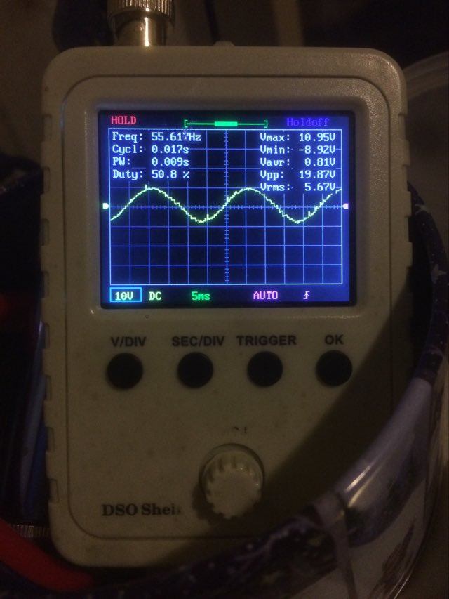

Amp came in for repair.
Kind-a works but the output is heavily distorted and doesn't even look like a sinewave. No power light on, no protect (LEDs work, tested them outside of the board).
It's the big brother of MTX 7801. I've checked your guide Perry and followed everything through it.

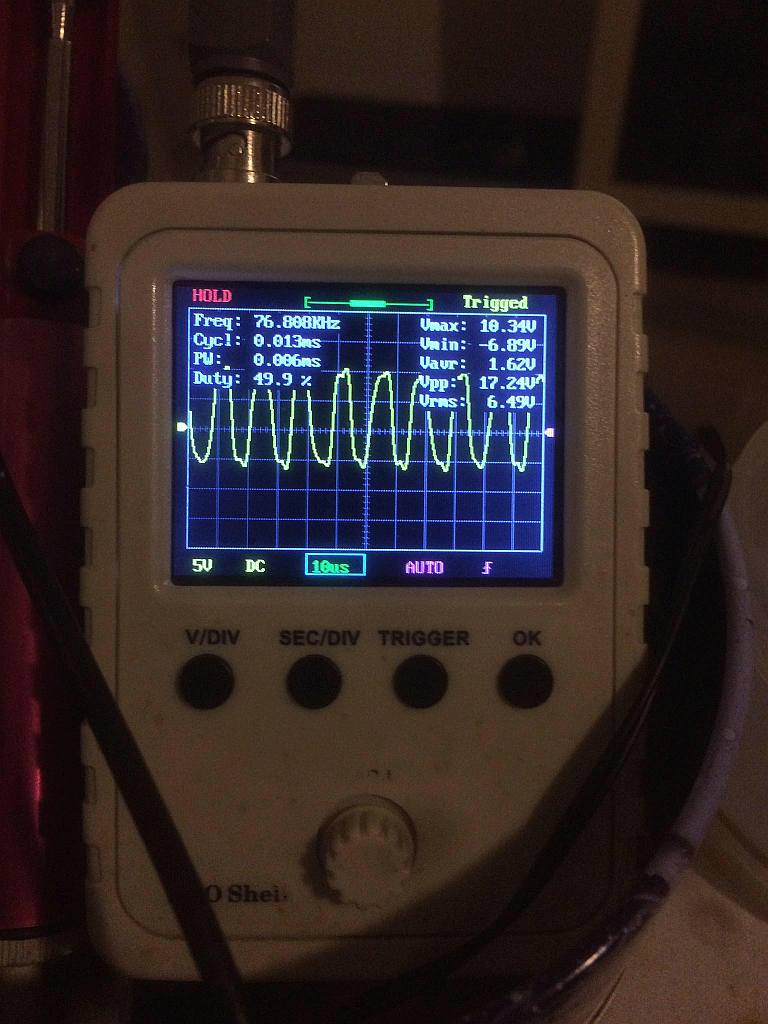

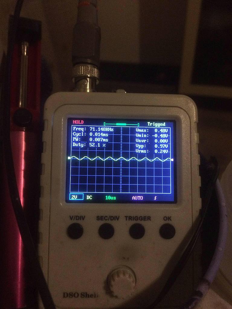

Optocouplers, N5532, rail voltage, supply voltages are all fine. Oscillation is as it should be according to the Perry's manual. I've re-soldered the inductors just to be sure. I've used jumpers to preamp bypass.
From the pictures:
The clean sinewave is taken at the jumpers.
The distorted one is at the output of the amplifier.
It's the same if i re-connect the pre-amp section.
I've noticed that the output filter caps get warm. They are nichicon 63v 470uf, doesn't seem they have been changed but in Perry's guide the ones over there are Panasonic, but the voltage and capacitance can't be seen.
I took out 2 caps and measured them - they read just fine 501uf, ESR=0.1ohm (leads resistance not taken out).
What else to look for ?

Across optocouplers: probes on pin 5 and 8
the one on the right - 20vdc
the one on the left - 19vdc

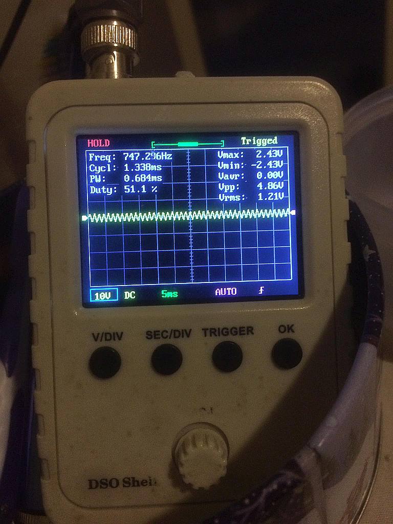

Ok.
Pin 1 - in the tutorial the wave swings above ground, in my case it stays below all the time.
Pin 2 - there is some wave in my case (pic attached), in the tutorial there is none it's ground.
Pin 7 - yes it swings equally.

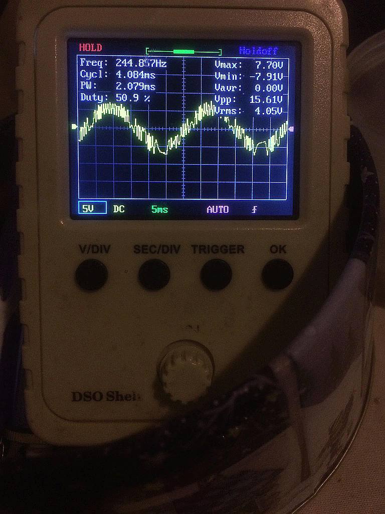

But i've noticed something interesting. When i turn on the amp, while it's starting up, there is a moment for a split second, just right before the amp turns on fully, the output looks kind-a better - picture attached.
Can't figure out if this is due to the filter circuit unable to filter out the noise or it's class D drive related.
Fully on - when current draw stabilizes at 4.5A. This is what i'm referring to.
Between initial current surge and the stable 4.5A draw, in this timeframe i've taken the picture.
Waveform is taken at the output terminals with no load attached.
Dummy load attached - 2ohms.
First picture is without any RCA signal in. I don't know if this is the class D switching...
Second picture is 40hz sinewave into the RCA, but doesn't look like 40hz sinewave at the output.
It's a clean sinewave at the jumpers.
