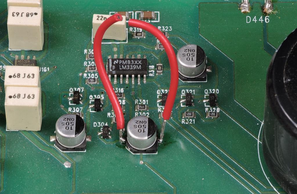

I have an 81000d here that doesn't have all of the outputs installed but before it switches on the output stage, it draws about 0.6 amps. After the output stage is switched on (LED238 on), it draws approximately 2 amps.
Before LED238 is lit, all current is from the power supplies (low voltage, regulators and rail). You can confirm that there is no current flowing in the audio section by measuring the DC voltage across the shunt resistors near the output transistors. You can prevent the output section from switching on by shorting the capacitor shown in the photo. The jumper in the photo was cut to allow normal operation.
See attached.
