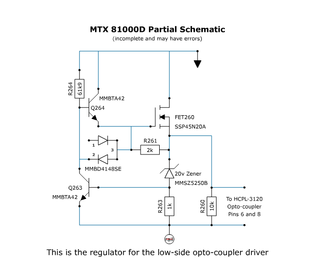

Good evening guys, I need help with identifying the part numbers for the regulatory stage of the Mtx 81000D.
The FET260 is blown along with; Q264, Q263, D263, R263.
Mr Babin you've supplied a partial schematic on my other thread but I'm having a tad bit of an issue identifying and/or matching some of the parts.
I haven't remove them from the board as yet and I haven't done a trace test with my DMM to simplify the diagram you sent.
Ok, so in regards to the SMD SOT Package for the 4148SE, does the PIN 1 connected in the circuit to any trace?
I doubt i can get that from my local stores, if its not connected can an axial fast switching diode be used across the connected pads?

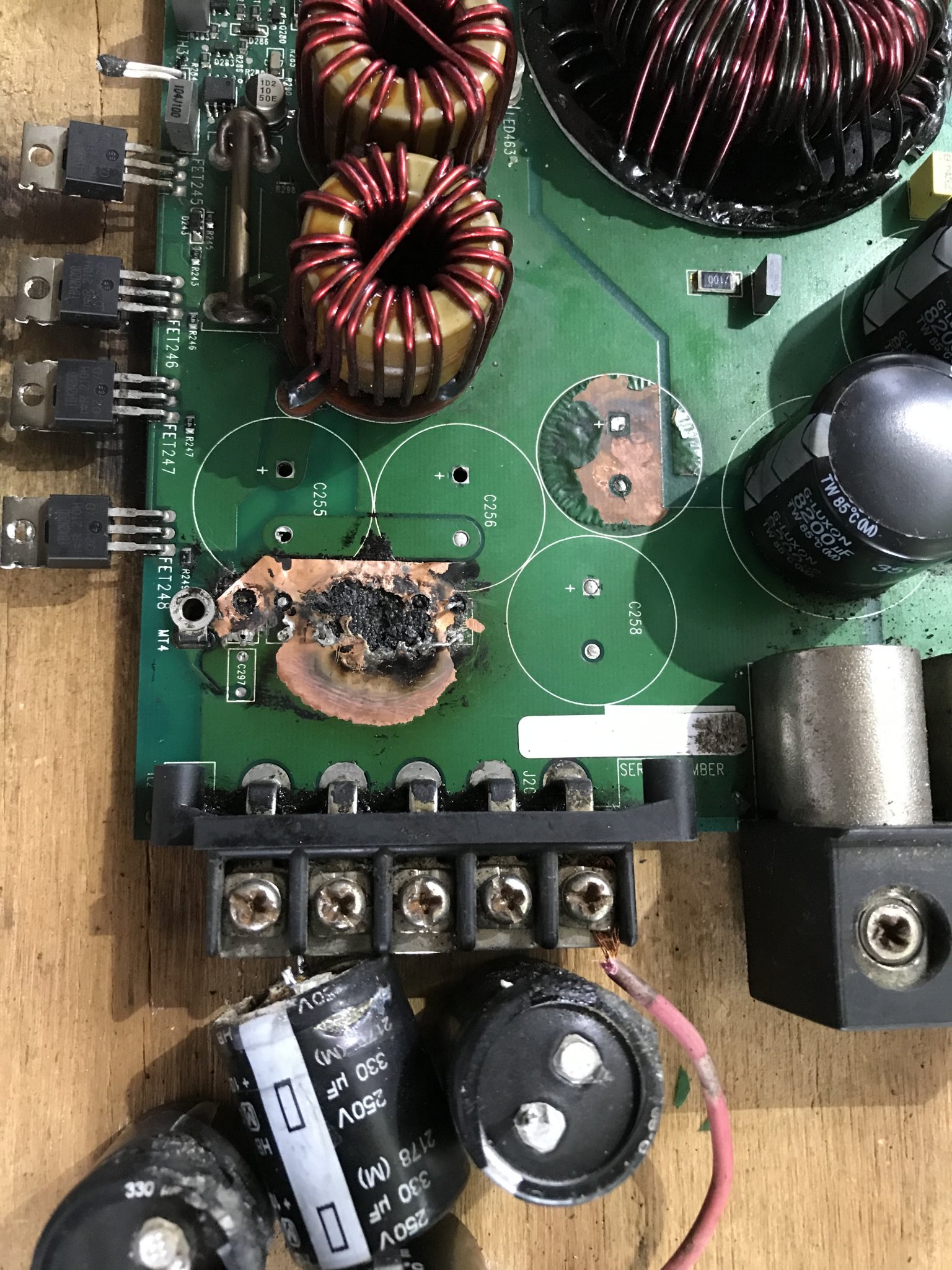

Good day guys does anyone has a partial schematic (or full) of the final output filters and mylar caps connection network of this amp. It’s gotten burnt and becomes conductive it flames and smokes when powers on, I have cutting to do but I would like to know the circuit layout so I can place the small parts on an offset piece of pcb to wire it back to complete the circuit arrangement.
