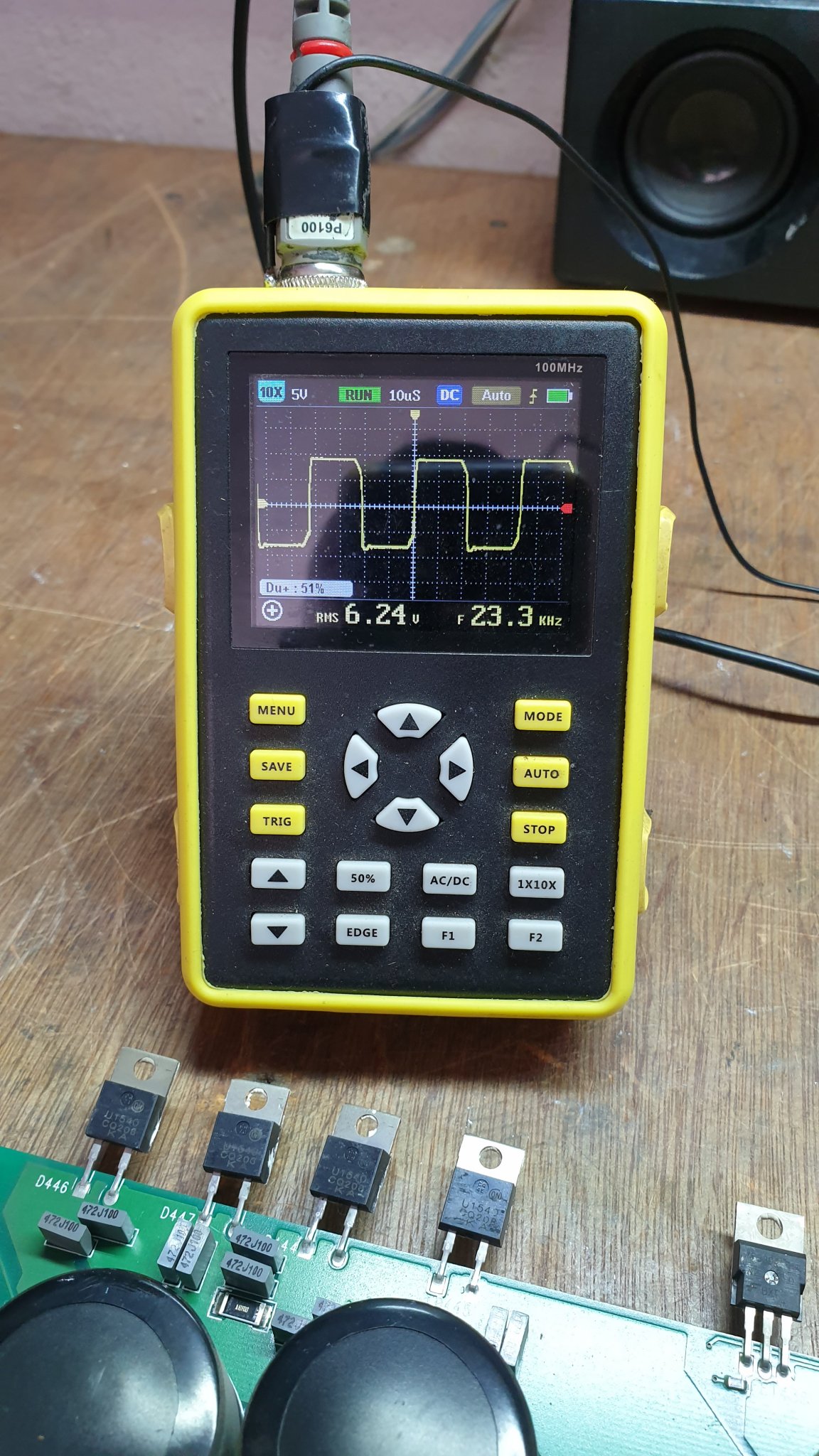

Hello friends! Thank you for allowing me to continue being part of the forum. On this occasion I have in my hands an amplifier of the brand Mtx model 81000d in which I received an irf540 in the output stage, of course it was blown up. The problem is that it does not generate audio. LEDS 399 and 463 turn on, but there is a current consumption of more than 4 amps and the fet that is attached to the board is very hot, I have a sawtooth gate pulse, but I understand that it is normal, at least Turn on the amplifier my supply voltage goes from 12v to 9v, I checked the fet that is on the board and it reads well, tomorrow I will lower it and get the HCPL3120, in the same way I measured them and they seem to be fine but I will try to get them, thank you your help and patience... regards

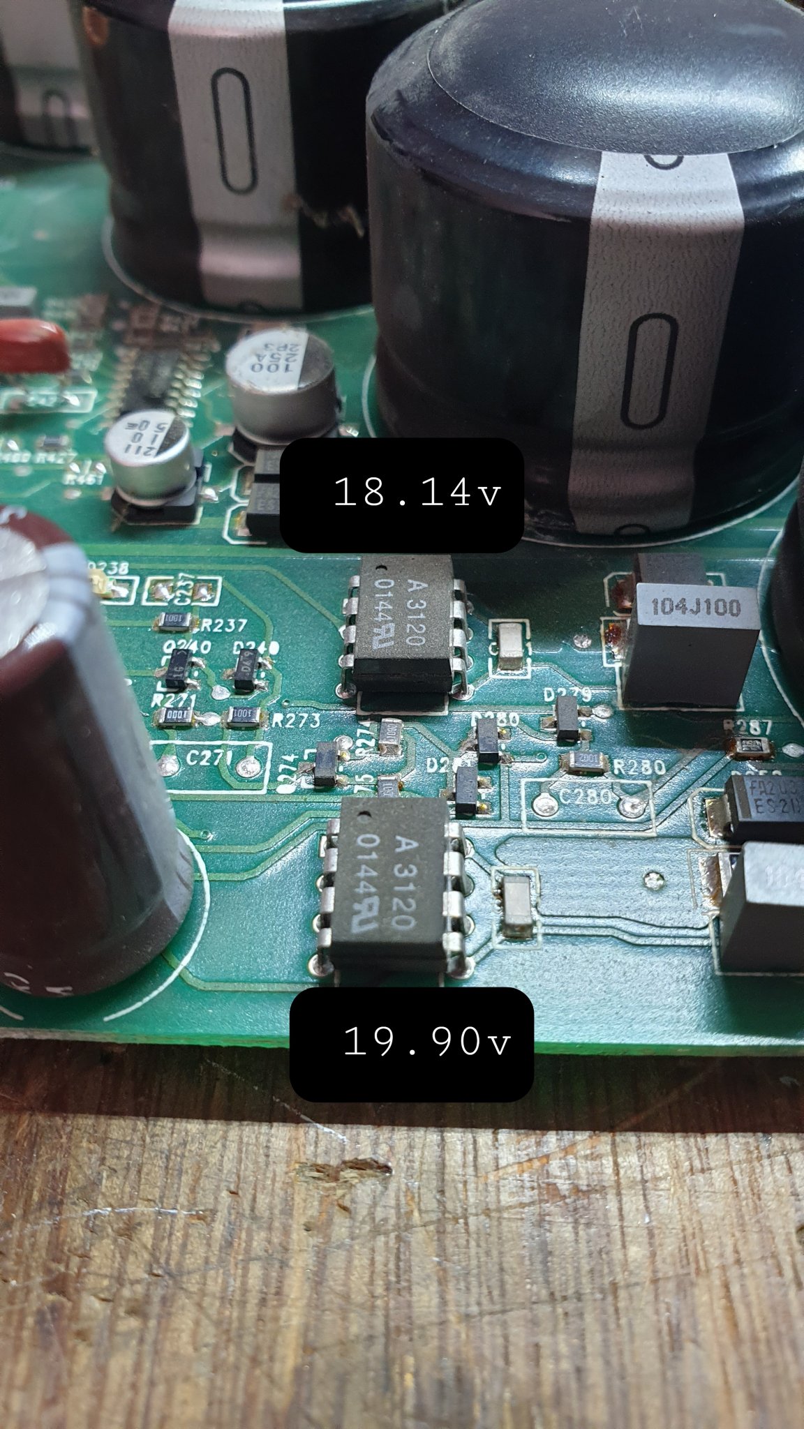

What's the DC voltage measured directly across pins 5 and 8 of the two 3120s?
the fet on the board gets hot from the start, you can even feel it when you run your hand. In the operationals TL072C and NE5532 I have pin 4 -15.54v and pin 8 16.28, only the 3845A has pin 4 2.43v and pin 8 5v. In the 3120 there are 19.90v and 18.14.

First: Gate signal MUST be square or rectangular, not a sawtooth.

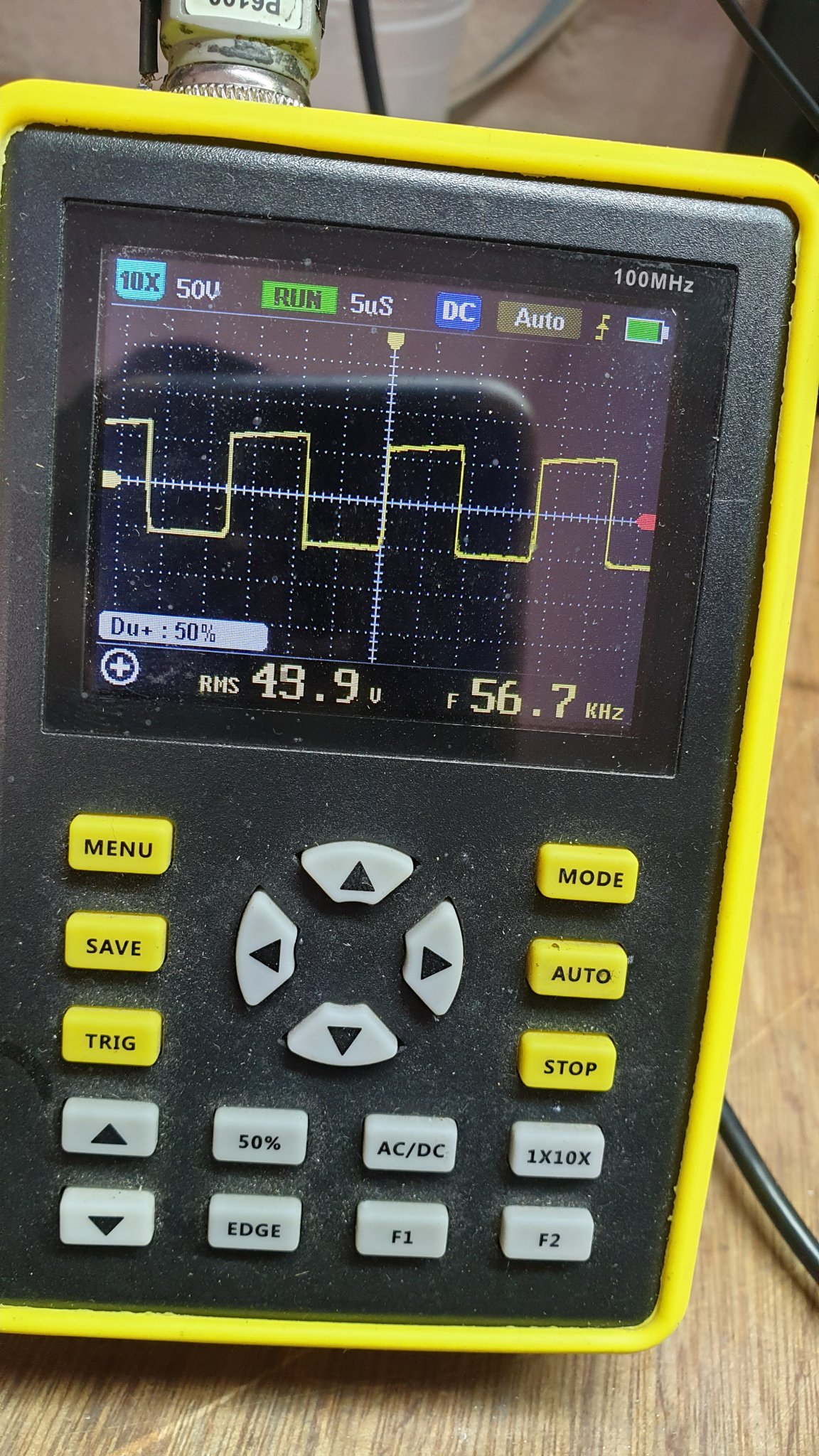

If that scope is completely isolated, check the waveforms on the gates of the high and low-side FETs. This is best done with a loading capacitor (~0.01uf) connected across the gate and source.
in fets 255~258 -64v and in fets 245~248 0v without shape only voltage and I tried with 2 irfb42n20d fets on each side and it turns the led238 on and off and it throws me this square wave
