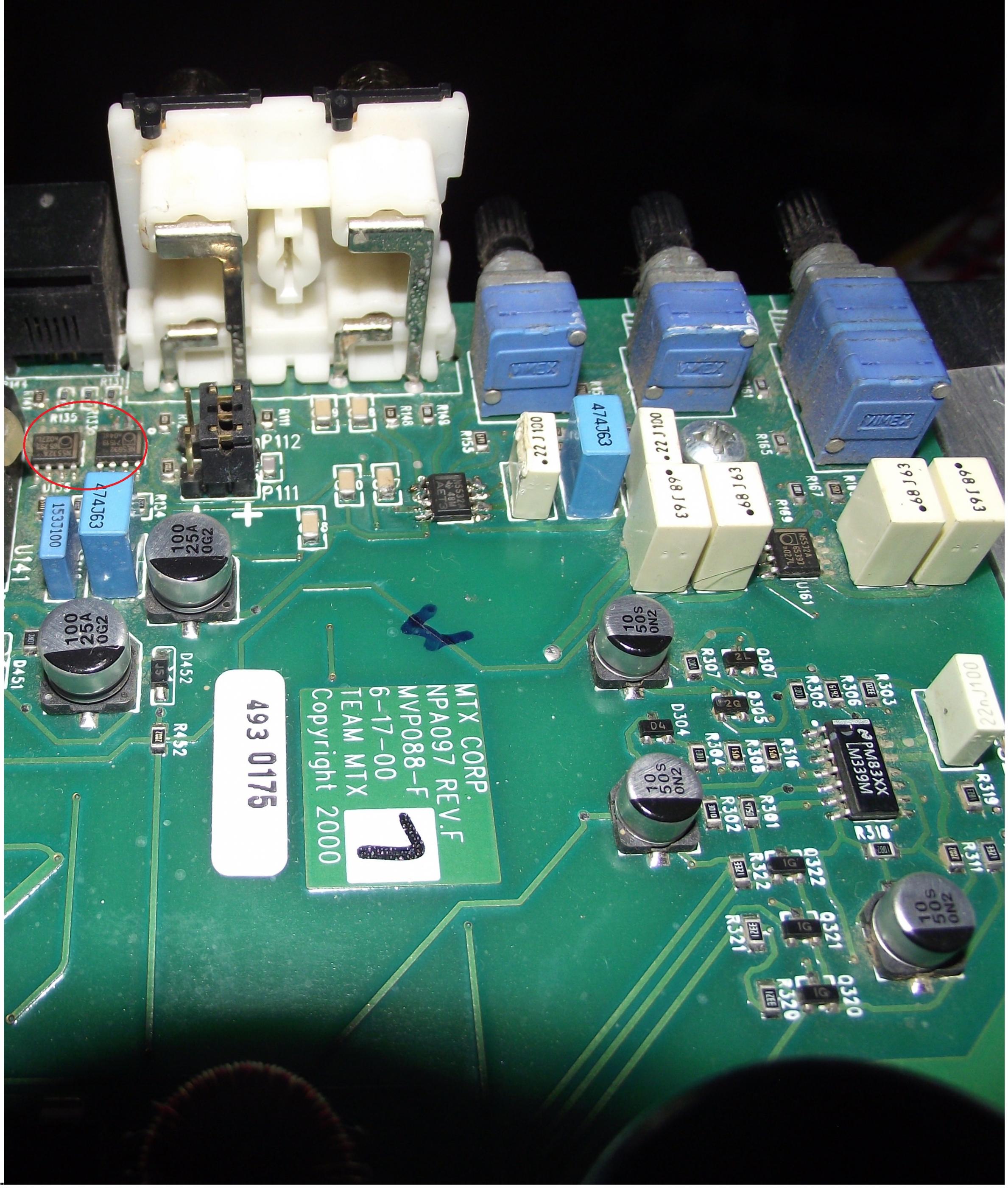

Heres the pic of the inside of my MTX 1000D
