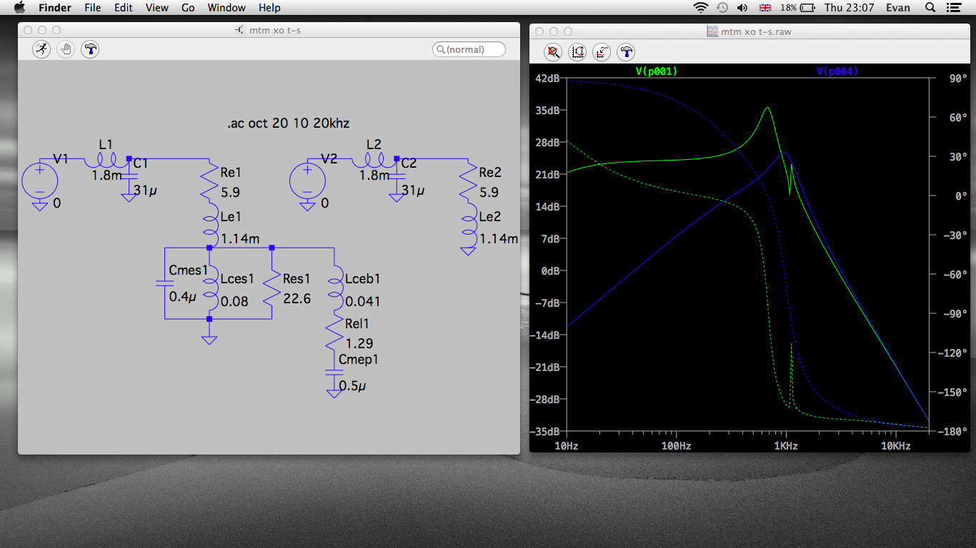

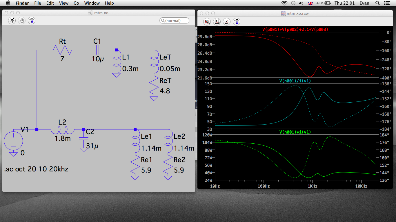

Just out of curiosity I have simulated an existing design from this project at 20vac & 40vac input:
Zaph|Audio - Bargain Aluminum MTM
Interestingly I get not too dissimilar curves in comparison to my design, so it may still be viable?
Zaph's acoustical simulation shows a flat response whereas when I simulate his design in spice its gets "hot" on the woofer region.
Can someone shed a light on the differences? Is it because mine is only electrical simulation and the fact that the box is not simulated at all? Must be...
Hmm I think I've found a way to acoustically simulate the enclosure in spice as well, seems to be working... I think:

See woofer simulated with and without enclosure.
