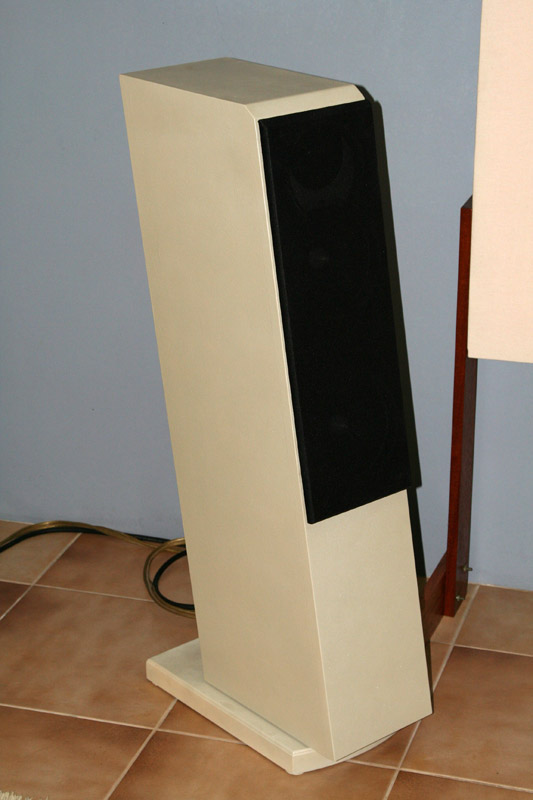

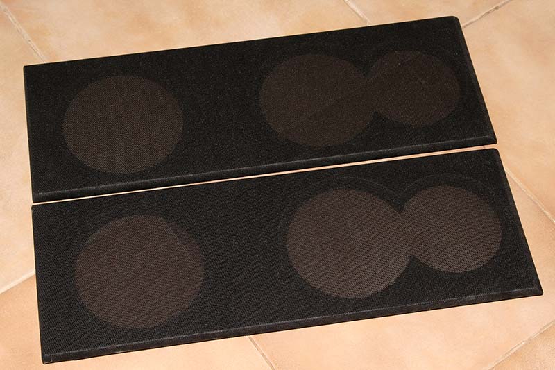

Now that I can't continue finishing the box, I instead went on to make the speaker covers.
The covers were done in a matter of few hours , I never thought it would be that easy and fast, cause this is my first speaker covers, ever. I just followed the instruction from the web on how to make speaker covers.( sorry , I lost the link). I used contact adhesive for the grill cloth, since I also forgot to buy spray adhesive. The result is ok, but it would have been easer if I had the spray adhesive.
Below is the picture of the finished speaker covers.

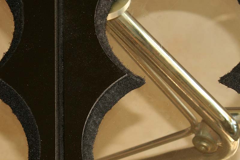

Here is another pic.
Note , In order to improve the situation when the covers are in use, I cut the inner part of the cover with 45 degrees angle , Using a router with a V-grooving bit. And then covered the router tracks with pieces of felt.
This should reduce the negative effect of using speaker covers.

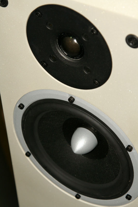

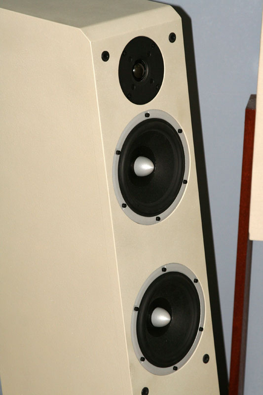

Hello to all,
I just would like you to know that I already finished this project few days ago, Only now I have the time to post , because I was busy listening and tweaking the sound.
For the tweeter, It turned out that the resistor value that Jay gave me is the best one, I tried resistors with lower and higher values , Even very small deviation from 2 ohms , would yield a very different sound, I first tried 1.5 ohms and the sound is too bright, and then 2.1 ohms, The sound is a little dull, and then 1.97 ohms, the sound is a little too bright, And finally 2 ohms, The sound is just right.
Below are the pics. Note: my wife chose the color (dove gray metalic satin finish). These speakers are intended to be used for our living room, Currently they are in my music room for evaluation.

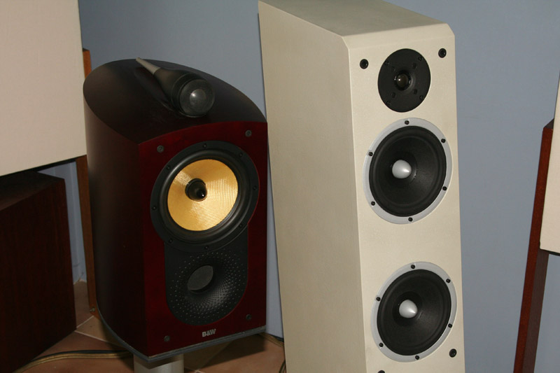

Hello Jay, Thank You.
First of all, The high and mid balance are the same as the B&W, Tonally, They sound the same from 500hz and above.
The difference are:
The B&W, Because of it's smaller baffle have more pinpoint imaging. The 2.5 way, though not the same class as the B&W in imaging is not far behind, The imaging is still very precise and stable though not as pinpoint.
The bass is much better in the 2.5 way, as expected, It goes deeper to just below 40hz, that I dont miss the subwoofer when listening to it, I tuned the box with pieces of polyfoams to make the bass sound to my taste, fast ,deep, musical and not boomy.
The 2.5 way could go much louder with and with out a sub, this too is expected.
The real differences between the 2 that I have no control of, are the sound of the materials used in they're drivers. Though they me be the same in mid to treble balance , The inherent characterestic differences between metal vs soft dome and paper/nomex vs woven kevlar persist.
The N805, Due to it's use of rigid class cones and domes have more inner details, air and have the "see through" transparency. Though the 2.5 way have very low coloration , distortion and have very detailed sound, they're not in the same class as the N805.
