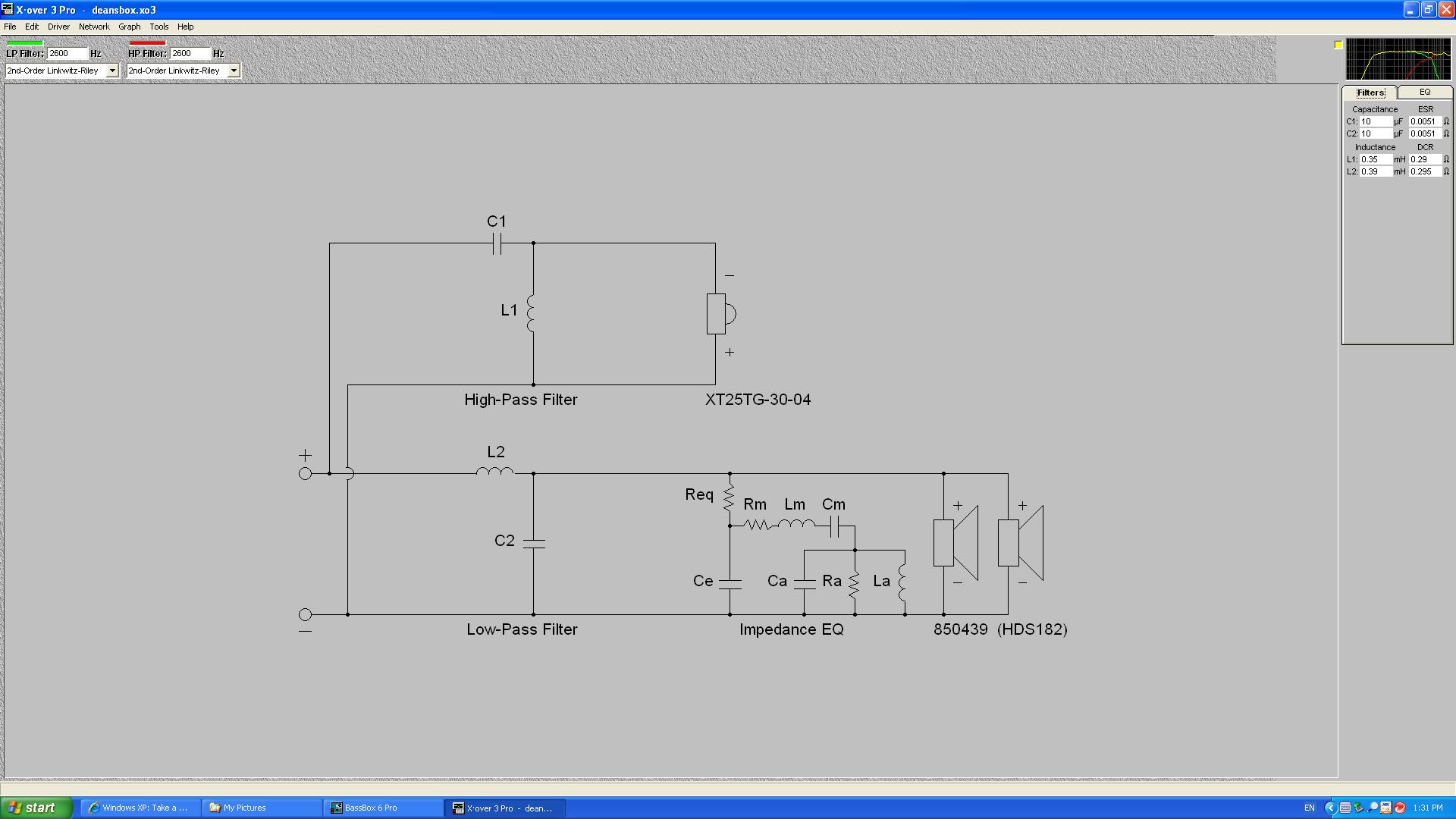

Getting into the domain of proper XO sim software here me thinks...
What do u use for xo design, being the easiest/free??
Another question... The Nom Imp of my woofers is 8 ohms but my MMD measures imp as 3.2 at the terminals with 2 in parallel. So when running XO calc do i use 4 or 3.2 ohms???
I just generally use the online one on diyaudioandvideo.com, and try to avoid most of these problems by using easy to cross drivers where ever possible.
I've found through years of reading, the grey heads do this and try to stick to first order slopes where ever possible, (less phase shift), the bald guys, try to correct inherent problems by adding more!!!!!! Tweaking proved it to be dead true....IME.
Another bit of advice that helped me no end was "try to avoid crossing over in the midrange". This is where your ear is most effiecient. Mother nature designed it that way to better hear the human voice. Any problem there, is going to be very difficult to mask!
Check thread 'p22wp transmission line' for my design, its still in its infancy, but the clarity through the midrange blew me away instantly, and the drivers were dead cheap.
What your measuring at the terminals is the resistance of the voice coil (RE), (of 1 driver div 2, for series, as you already know) plus your wire resistance.
Impedence is different, as it changes with frequency and can be followed on your response graph, it's the impedence curve that you aim to flatten with the zobel. That will (should) hold the impedence close to nominal at your xo point. So, xo to nominal impedence not RE. Your crossover in the pics shows your on the right track there.
What your measuring looks normal to me. Genly rattle your fingers on the cone while you take this measurment, you'll get the idea......

Note that what determines the filter order is not an electrical order but an acoustical rolloff order. In this case (or in most cases with this kind of driver combination for home speakers), you want to shoot for Linkwitz-Riley acoustic 4th order. For your particular driver combination, I am 99% sure that this is achieved by using a second order electrical low-pass filter (with or without a Zobel) for the Peerless and a third order electrical high-pass filter for the Vifa XT25. The tweeter should be wired in normal polarity.

Hi Dean have a look at the natural rolloff of the woofer, then add in the rolloff that the crossover introduces, when summed you should get your 4th order rolloff. Now I haven't looked at the rollof of the tweeter but I assume it is more shallow hence Jay suggesting third order for it. You might want to do a search on target response 🙂

Hi Dean, Have a look at the freq response curves for the two drivers. The XT25 drops by around 6DB between 1Khz and 500Hz (one octave) and the peerless drops by around 12db between 3Khz and 6Khz (again one octave and ignoring the peak at around 4Khz) 🙂

OK... I'm kinda getting this.... Are you saying that the chosen electrical slope should match the drivers acoustic slope in most cases?

No you want a particular target response (ie slope) If this is 24db/octave and the speaker already rolls off at 12b/octave then you only need 12db/octave on the electrical side 🙂
Both the woofer and the tweeters rolloffs should match each other (ie in this example 24db/octave) in order to sum properly for a flat response 🙂 Since the tweeter rolls off at 6db/octave you need an additional 18db/octave from the electrical side, hence a third order on the tweeter as opposed to 2nd order (12db/octave) on the woofer.

Hi dean, I tried doing a search for some graphs which show the roloffs and summed response and came across this article The first section on phase is well worth reading 🙂 Phase is something that usually does my head in, but this article helped a lot, especially the graph demonstrating the difference in phase.
It is primarily an article about using cad software for designing crossovers which is beyond the scope of what we are discussing, but have a look a bit further down and you will see the combined response of the drivers with the crossover and the summed response as well. So in a way I guess your question is correct, but maybe not how you meant 😉 You do want symetry around your acoustic and electric slopes both meeting a a point to sum correctly, but they don't start at the same frequency, they are idealy a mirror of each other.
If you look at the first example in that article, the crossover freq is 2.5Khz the dotted lines represent the response of the driver + the filter for each of the woofer and tweeter, note that the woofer starts rolling off at around 1.2K, because the tweeter is still providing some sound level even at 1.5K (though admittedly around 20db down) the two sum together to make a relatively flat response (and this goes for all of the frequencies in between)... this is why the phase is so important in the crossover region, if the output is not in phase it won't sum correctly... This is also why it is important for the "actual (ie acoustic + electric) rolloffs to match each other as closely as possible (ie be a mirror of each other). If you look at the tweeter it is starting to roll off around 5K (note each is starting it's rolloff 1 octave below/above the crossover freq).

Madisound shows that tweeter as having an fs of 500hz.
Is that correct?
If so, you're not doing yourself any favors by crossing that over so high.
There's simply no reason to be higher than 3x fs at the maximum. Which would be 1,500hz.
Secondly, I see a slight peak at 3,000hz. That is THE notorious point of harshness in music to our ears.
Put a notch filter there, and I bet the harshness goes away.
Also, MTM's like lower crossovers for the tweeter. So you should seriously consider redoing that to closer to 1,500hz.
The half wave length right now at crossover frequency, is 2.6".
You would increase that to 4.5" if you took it to 1,500hz.
And that would go a long way to making the speakers sound better outside of the sweet spot.
