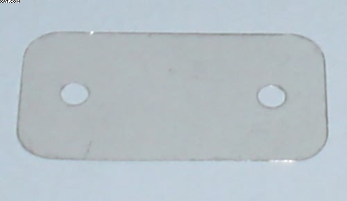

It depends on the quality and thickness of the mica, the MT200 mica's i got are crystal clear and 0.0025" thick.

As Mike indicated, you should expect somewhere below 0.20 C/W for a MT200 mica.
