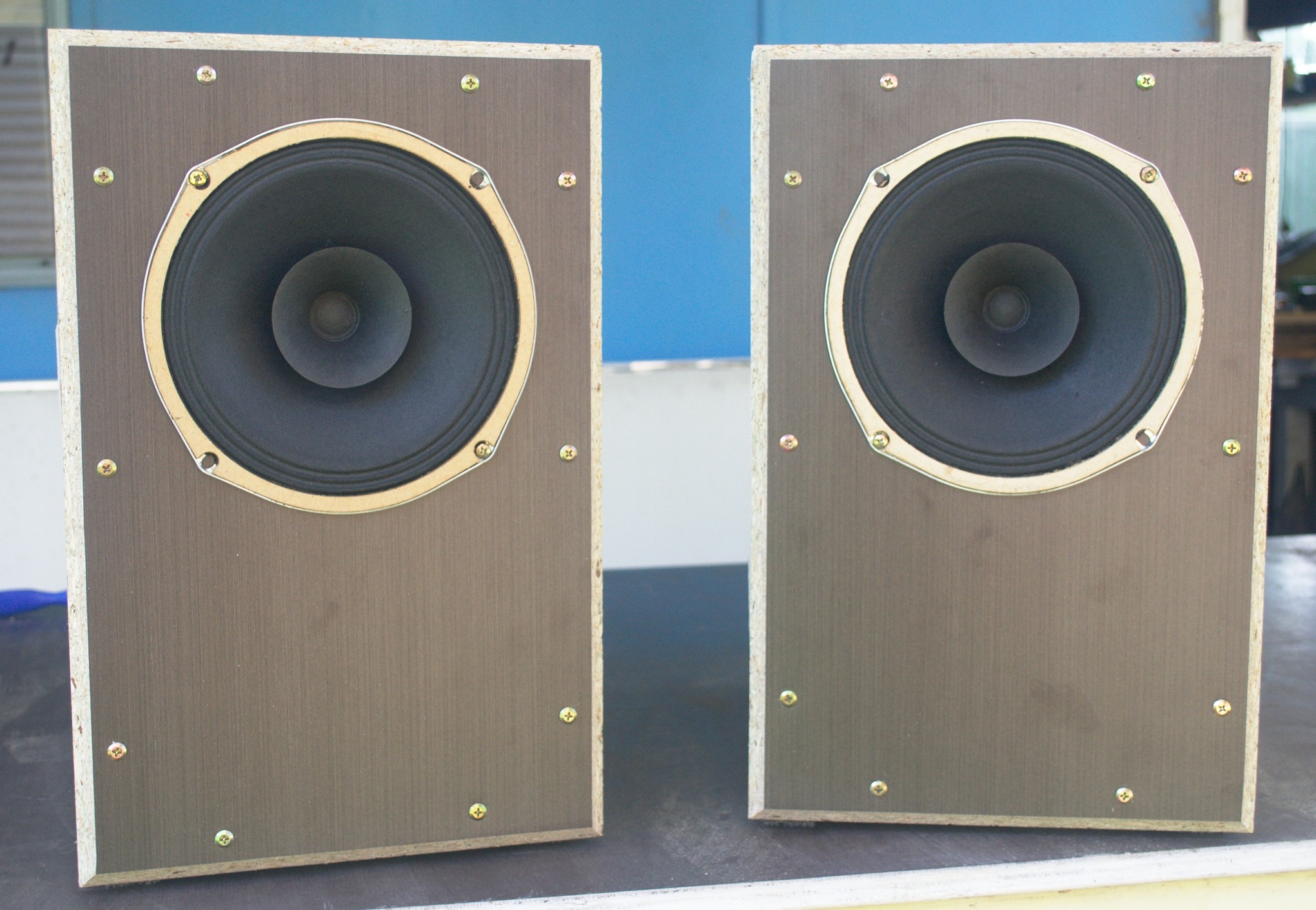

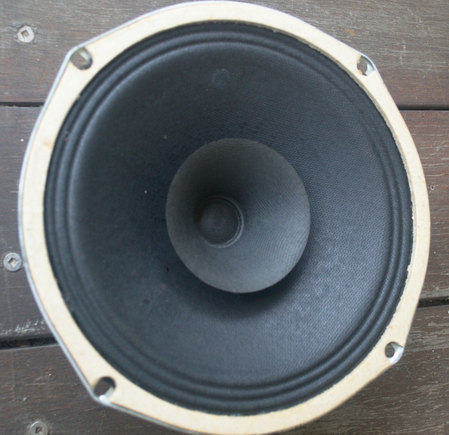

Just thought I'd give these a try, they've been sitting on my shelf for years. MSP were an Aus manufacturer during 50s-70s
These are their 8TAX/15 Alnico full rangers, 8", 15 ohm, Fs 50 Hz, Qts .84 power 8 watts.
Plonked them in a pair of 30 L test boxes, well stuffed.
How do they sound? - Low end, a bit recessed, but not bad; Mids- low treble pretty good, full & well balanced, but no high highs to speak of, sound OK with a couple of piezo supertweeters. Saxaphones sound glorious on these.
If anyone in Western Sydney wants to try Alnico Full-range nostalgia, come & get 'em, they're surplus to requirements here & need a good home
