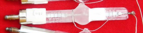

Hi guys.
Ive got these 2 lamps, one of the is from a Infocus LP720, and the other is from a Epson EMP-3000.
Both are 150 Watt Metal Halide, but im not sure if they use the same voltage ?
i know that the mscr150e3h is a 65 volts metal halide, but what about the mscr150e4h ?

THIS LAMP IS USED IN THE ASK A4 PROJECTOR. IT IS A 150WATT METAL HALIDE ALSO USED IN SOME OTHER MODELS, INFOCUS, EPSOM ETC. ON SOME LAMP HOUSINGS THAT SLOT INTO PROJECTOR A 50c THERMAL FUSE IS FITTED THATBLOWS FOR NO APPARENT REASON, FORCING USER TO BUY AND FIT NEW LAMP THAT STILL DOES NOT WORK🙂
yes! they are same, burner and reflector
