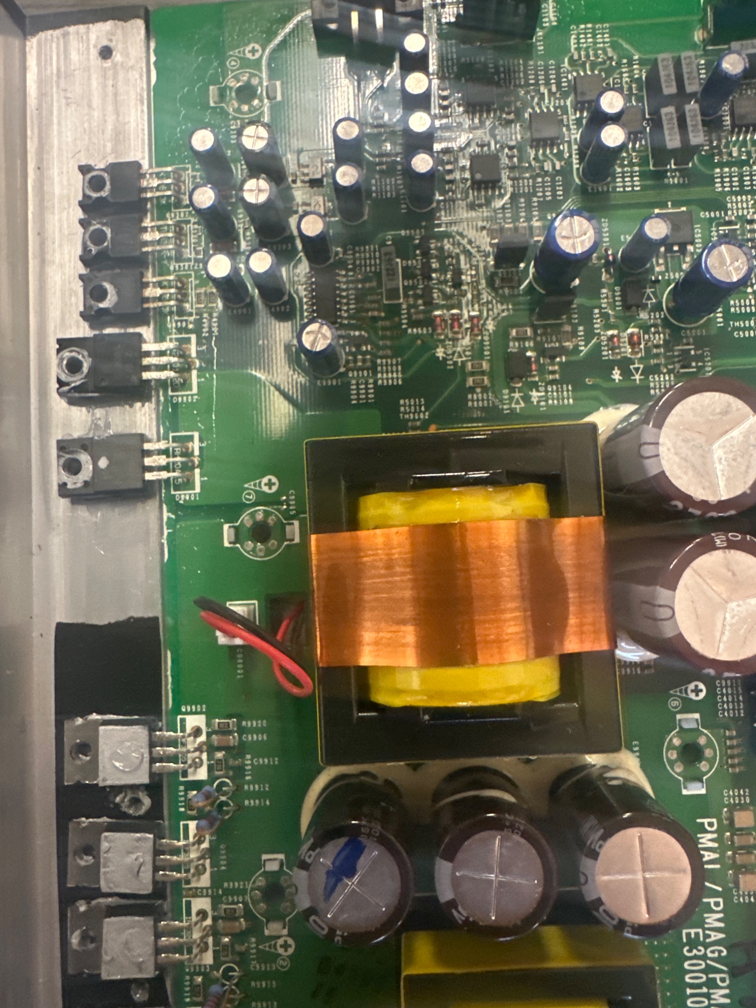

MRP-M500
How do I test them? Which legs should I be on?
Use the main ground terminal unless you read 0 ohms from the main ground to that screw.

Clamp all transistors back down and play it until the amp shuts down, then recheck the voltages. Has any changed when the amplifier malfunctions?
Alright Perry, I got another one off eBay. And it doesn’t work…. So I’ll probably return it. But when I tested doing the same methods you mentioned above, e9701 and e9702 there is no audio. What would be the next steps if there is no audio there?
