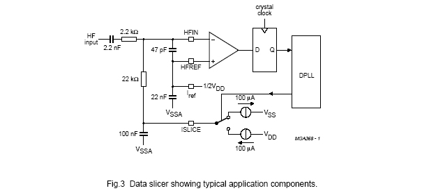

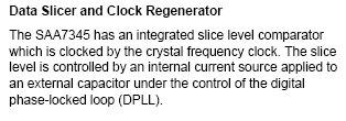

The data wavefom coming off the disc is an analog waveform. This is converted to a squarewave (rectangular) data stream by a 'data slicing' circuit stage. If the power supply to this stage is modulated (noisy), the threshold level varies and timing jitter is introduced into the data stream, and this jitter is very audible.

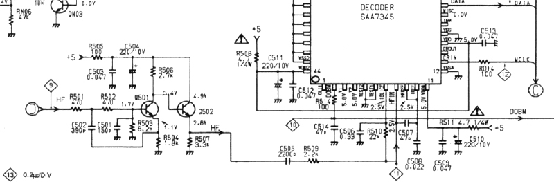

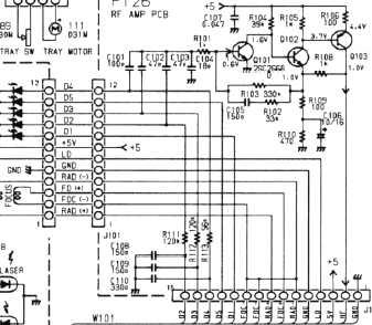

Anyway, if you study the above circuits you will see that they are all single (B+) supply operation.
If these supplies is noisy, additional noise is directly coupled into the HF waveform and this may confuse the Data Slicer decision stage, introducing actual data errors or at least timing errors (jitter).
I know that this squared waveform is passed into a FIFO buffer that theoretically should eliminate this jitter, but in practice a noisey/jittery HF waveform causes data corruption that may or may not require data error correction or interpolation.

In some (most ?) earlier cdps, the initial preamps and data slice/decision stages were discrete and external to the first processor, but I don't have HD copies.
If you study the above stuff you should get the point.
Other schematics are worth a close look too.

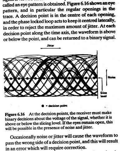

thanks for your replies, but I am still a little confused, especially in light of the following I found at this web site: http://electronics.howstuffworks.co...ington.edu/conselec/CE/kuhn/cdaudio2/95x7.htm
From the above I gather that the "RF' created by the reading of "pits" of varying length is still read using the zero crossing method, power supply polarity notwithstanding (a capacitor in the right place can take care of making it so), where when the signal crosses the "zero", it is read as a one, whereas during the other "T" cycles if there is no signal crossing, the result is a logical zero. The rest of the signal, according to the article, is used for servo control, error correction, etc.
I guess I am going to have to seek several different publications, and a good schematic, one which breaks down the compoonents a bit more discreetly in order to understand this.
