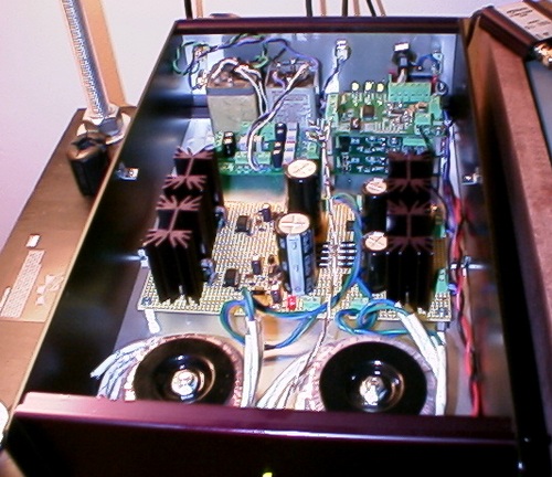

Here's my dac built with a combination of TPA Spdif receiver module, a couple of bare board COD dac boards and a bare IVY.
The cods are configured in mono mode, and the currents are summed at the outputs. I use a single IVY for I/V conversion and use that to drive a pair of UTC A-21 line mixing transformers for balanced to unbalanced output. It works really well.
I found with a pair of cod boards that the most consistent operation occurs with the receiver and dac boards stacked. I kept the I2S lines very short as I did have problems with the SCK line interference.
I built up the CODS, and IVY over the course of a few week nights. I recommend this route only for those who are very sure of their smd soldering skills - not a trivial task to solder these components in a home environment. The modules will be less hassle for most.
There are 4 separate supplies, two 7V digital supplies based on Rohm BA17807, and a set of analog supplies somewhat similar to the Jung super regulator with a pre-regulator and LME49710 based high gain fast integrator for error correction, and a TL431 reference.
My new dac is already outperforming a heavily tweaked Zhaolu 2.5A, and with further changes should get even better.

Excellent work Kevin, great project. 🙂 You are right about the soldering, its not exactly easy. In fact I only know a couple people who have built them up from bare PCBs.
I am glad you like it. I hope you enjoy it.
