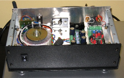

Hi Russ, FINALLY my Opus sings. After months I now had the time for building the boards in a decent case. Results are very good regarding the highs and midrange. Soundstage is very good and depth and spatial imaging are on a high level. My Opus is somewhat bass shy. It is still breaking in so it might change in some days. Without any scientific explanation I simply suspect the OSCONs in the output circuit. I also experience some static clicks when the source starts feeding signal over SPDIF. They do not bother me really but I'll try to find what causes this.

Ah yes the original beta boards. 🙂 Very glad you got it going.
Are you still using a transformer for BAL -> SE conversion?
Also if you are using consumer SPDIF make sure you ground -IN, as this could be causing your clicks etc.

Hi Russ, I designed a simple output stage for BAL -> SE with high quality amorphous core transformers but I have not had the boards made (yet). I really had other things to do the past months. Probably the specs of the DAC will be better when symmetric outputs both are used ?! Now I just use only one of the outputs for SE use.
What are your experiences with your BAL -> SE output stage ? And did you try other caps at the output instead of the OSCONs ?
Anyway, the older beta DAC is a fine product. Just wanted to let you know as the beta phase is history for some time now. I can only imagine how the final design sounds.
Regarding the advise to ground the -IN: did you also connect the case to the DACs ground or did you leave it floating ?

I am still using the Beta full time (embedded in my CD player).
I leave my ground floating. For -IN, the CS8416 receiver board now has an onboard jumper to ground for single-ended S/PDIF use.
If your system can tolerate some DC offset, you could try bypassing the caps to see if it eliminates the bass problem. I have thought about some off-board (large) 20-22uF MKPs, but have not tried it, as I haven't really found the need in my system.

Hi Brian, the output transformers I want to use are allergic for DC. I think I will settle for Black Gate N series caps if they will fit. If not I have to adapt the transformer PCB so the caps will find their place on that PCB.
Hi JP,
I think I have a good solution for you if you wish to try it. If you look at the "Ballsie" schematic you will notice the stage that does the BAL -> SE conversion regjects common mode voltage. So the SE output (only!!!) will have virtually no DC component. You would completely omit (or bypass with a jumper) the output caps of the DAC if you used such a circuit. Just keep in mind the balanced outputs of the ballsie will still have the 2.5V common mode voltage, only the SE output will not.
If you wish to roll your own SE conversion circuit the first part of the ballsie circuit can easily be omitted, just increase the values of the resistors around the opamp to keep the impedance > 2K or so. I would shoot for 2.21K.
For capless DC free balanced output our TXD board fits the bill very nicely. You can use the TXD as a buffer/Line Driver with no cap on the DAC as the TXD also completely rejects the common mode DC.
So its quite easy to go capless if you want to. 🙂 But honestly the Oscons are excellent, and I don't think its the caps. I just wanted to be sure everyone knows there are tons of options. 🙂

I see the new receiver PCB has no SPDIF input transformer at all. Did the original input not put up with expectations or was this decided as a cost reduction ? Just curious.
I'll think about the options you and Russ offered for omitting the OSCONs. The transformer option is a nice one as there will be no active components (opamps) in the output. It could be the difference between "very good" and "excellent" 🙂
Till now I haven't measured the device for RF/HF at the output without filtering. Is filtering really necessary ?
Pardon me for questions about the beta DAC while the product is already out of beta status.... The device really is very good sounding as it is but I'd like to sqeeuze everything out of it that's possibly in it. Next test will be a comparison with Pedja DAC 1.1b which is a non oversampling TDA1541A DAC.
The WM8804 does not have differential input, so we omitted the transformer since it make much less sense without diff inputs, especially with most people using consumer gear. The good news for some folks is that we still offer the CS8416 board with SPDIF input transformer precisely because we know that for some folks it actually may be more desirable.

I have found in my experience that additional output filtering (while not seeming harmful to me) is completely unnecessary. I attribute this to the fact that the DAC already filters the output sufficiently.
