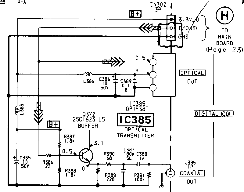

promitheus said:
Thanks, this would be interested to see.
I think that the voltage level of the TOSLINK input is too low.
the schematic shows 1,4V only. How much should the Coax S/PDIF be? 5V?
Here is the info from the CS8416 DS:
Differential Input Sensitivity, RXP[7:0] to RXN VTH - 150 200 mVpp
So 1.4V is certainly plenty. 🙂
You should be able to use what you have just fine. 🙂
Cheers!
Russ
I found a solution.
I read about the Elektor magazine tos to coax SPDIF converter and I can buy the Pcbs.
take a look at the attachement.
I will connect the data that goes to the Toslink transmitter inside the CD player to the pin1 IC2a see schematic.
If anybody wants the pdf file in english I can´t post it here so please contact me with email.
Here's the scan from my Sony manual...
L385 and L386 are 0mH ferrites.
C388 is 1uF 16V ceramic
C387 is 180pF 50V ceramic

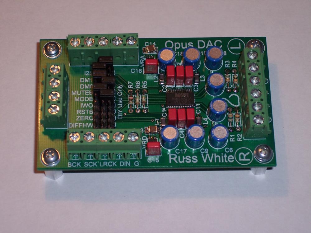

First Opus is playing music... 🙂
Just wanted to let you folks know that the Opus is alive and well. Some pictures of the stuffed DAC and Receiver PCBs. 🙂
Its been a long time coming, but I believe it was worth the wait. :yes:
USB PCB and BA;/SE converter coming very soon now.
BTW, DipTrace rocks! Glad I switched from Eagle.
:drink:
Cheers!
Russ

Re: First Opus is playing music... 🙂
Very nice work indeed, Russ. I might have to get a set of the new boards despite alredady having the proto's.
I agree with your opinion of DipTrace. I bought the DIY'er licence and haven't looked back.
Re: Re: First Opus is playing music... 🙂
promitheus said:
Hey the look absolutely wonderful!
Nice job! 😉
Thanks guys!
I learned a lot from the beta.
I owe a lot to many of the forum members who gave me good advice and showed me where to find answers when I needed them.
I will be testing with two DAC boards tonight in dual differential mode (mono). That is supposed to get us another -3db SNR. like -117db was not low enough. 🙂
Cheers!
Russ
