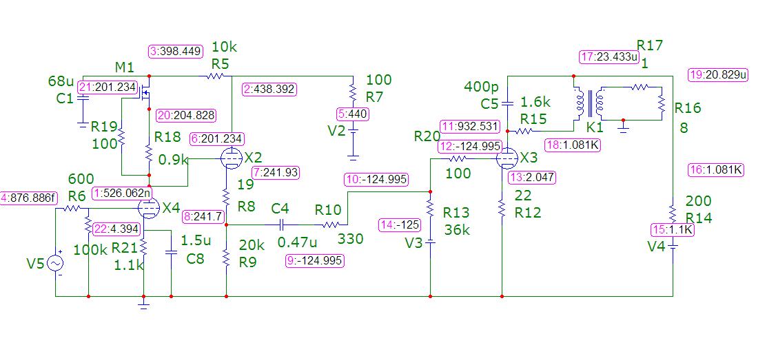

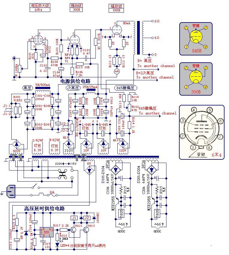

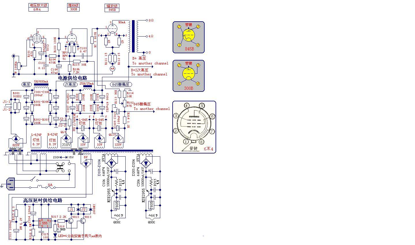

First I found what was known as schematic of this amplifier.
See Pic.1
As you can see it is indeed uses 6J4 penthode doing all voltage amplification, directly coupled 300B in cathode follower circuit as driver, and finally 845 with fixed bias in output stage. All power supply is solid state, but with chokes in filters and regulated filament supply for 300B. 845 filament supply is not regulated, but still uses solid state rectifiers, as do plate and bias supplies. I should say that hum level from this amplifier was very low, so circuit is good in that regard. There is no either global or local feedback anywhere in the circuit, so in keeping distortions in check designers relied only on characteristics of tubes. And if 845 and 300B are relatively linear tubes, this cannot be said about 6J4 considering very high plate voltage swings needed to drive 845. So it was clear that the main problem if front stage circuit.
I opened amplifier and found that some components differ from what is shown in diagram above:
R101 was 390 ohm
C101 was 1000 uF Black Gate and clearly was someones custom job to install it
RF3 and RF4 were 38 ohms
R106 – 6.6 K
C103 though had same capacitance was clearly installed by someone after this unit left factory. These were M Cap silver and oil type.

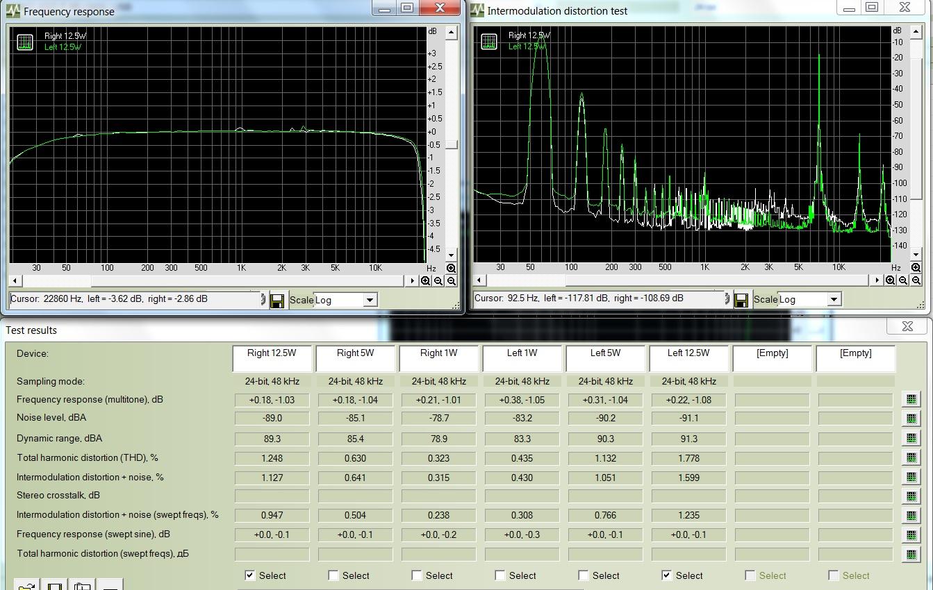

I checked power supply and found very low ripple in both driver stage and output stage B+. Input stage supply was 440 volts and output stage got 1100 volts (which is on a higher side comparing with other 845 based amplifiers) when tubes were removed. Under normal operation conditions I saw 430 and 980 volts accordingly. Bias for output tubes at 95 mA current was about -120V.

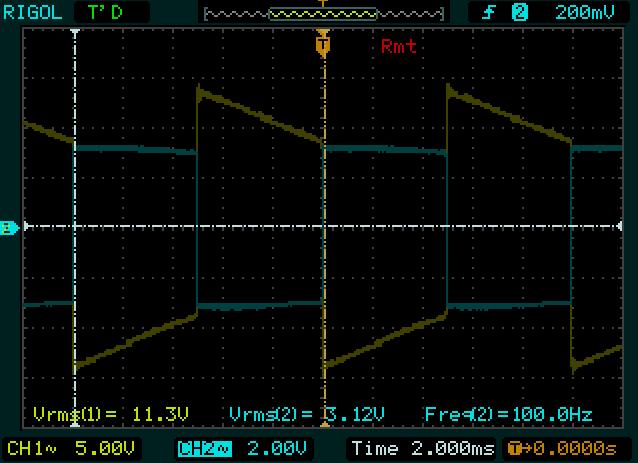

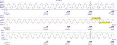

I have circuit simulation software and decided to do research on computer first before making any changes in real circuit. I found SPICE models for 6AC7 and 845 tubes (300B was already in supplied library) and entered amplifier circuit as I found it. I used my new Mastech MS5308 LCR meter to measure main parameters of output transformer. I ran DC simulation and compared results (voltages and currents in different parts of circuit) with what I measured in real life. They were very close, so simulation models were close enough to work with them.
But it was immediately clear WHY amplifier sounded so poorly – the main problem was input voltage amplifier stage. Look how low plate voltage is – just 65 volts. And this is when you need at least 250 V peak to peak signal to drive 845 tube to the limit.
See Pic. 2
Thus small signal tube clipped well before driver and output tubes were used to their full potential. And this is understandable – penthode circuit with resistive load could not even in theory provide large voltage swing (considering loss in driver you need about 300 V peak to peak) and keep distortion low. Look at results of simulation – do you really like that “sine” waveform?

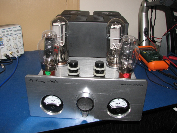

See Pic. 3
This amplifier had reasonable THD (below 1%) only well below 1 Watt. That was a reason WHY it sounded so dirty.

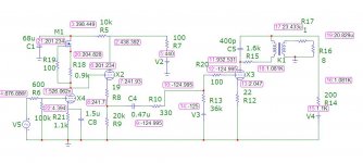

Here is a part TWO of report on my attempt to make Mr. Liang 845 amplifier sound better.

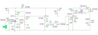

So now was a challenge – what to do with it. I could completely re-do the whole circuit, but that would require removal and replacement of PCB that contained all components (power supply had a second board, which I didn't even wanted to touch), or go with a limited change of circuit keeping most components in place. I decided to go a second way – the same like I did with Yaquin. But here more needed to be done – not just components with different parameters, but circuit itself had to be changed.
So now I needed to decide what type circuit needs to be used. He goal is to have very large voltage swing and low distortion. There is no way I could do it keeping resistive load. There are two methods to have circuit more efficient in using plate voltage – either load tube with transformer (or choke) or use CCS circuit. Considering that I had to work with existing power supply, and didn't want to add more tubes (which would require PCB replacement I wanted to avoid), I decided to go with with solid state CCS. Luckily enough not long before I read about a new components made by IXYS – three pin device that behaves like depletion type Mosfet and specifically designed to work as CCS in circuits with up to 900 volts. They need less than 10 volts to enter into saturation, so there will be little loss of B+ voltage if I could use them. I decided give them a try and ordered few pieces from Mouser. These devices cost only few dollars so I had little to loose. Then I had to decide what to do with tube. Penthode circuit had to go – the only way to get low enough distortion was to use triode. I could try something like 6SL7, which could be a very good choice, but that would require major alteration of circuit board. Here again I decided to try easiest path and use the same 6J4 tube, but in triode connection. Going that path I would trade a little of amplification, but will need to do much less actual work modifying a board.

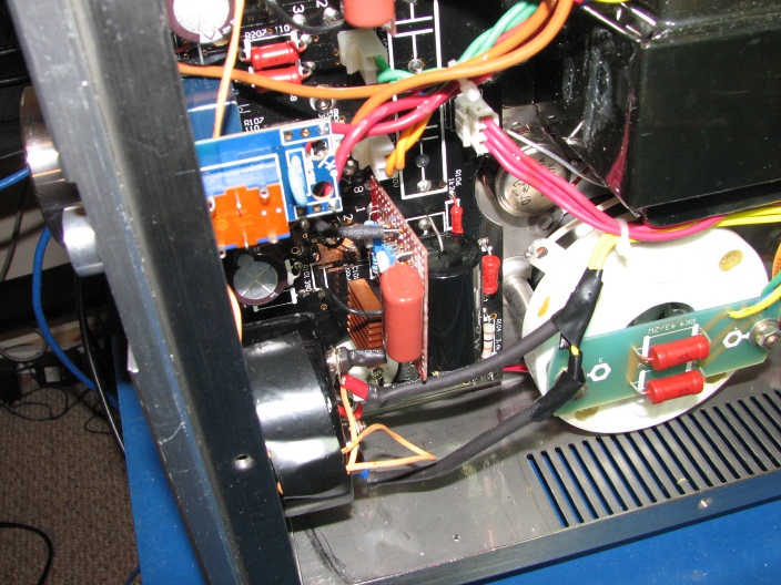

When CCS devices arrived few days later, I built a breadboard circuit with 6J4 tube in triode connection and CCS as plate load. I could only power it up to 300 volts (all I can squeeze from my bench power supply), but even then I got reasonable amplification and 250 volts swing of output signal. So I proved a concept and next started designing new circuit around it. Most circuit design was done using computer simulation, and then only final adjustment done in real circuit. That saved me from making major mistakes (though I still made one, and describe it later). Hardest thing was to find a SPICE model for 6AC7 tube. I actually found two different ones, but only one of them provided results closer to what I saw in breadboard.
See Pic. 4

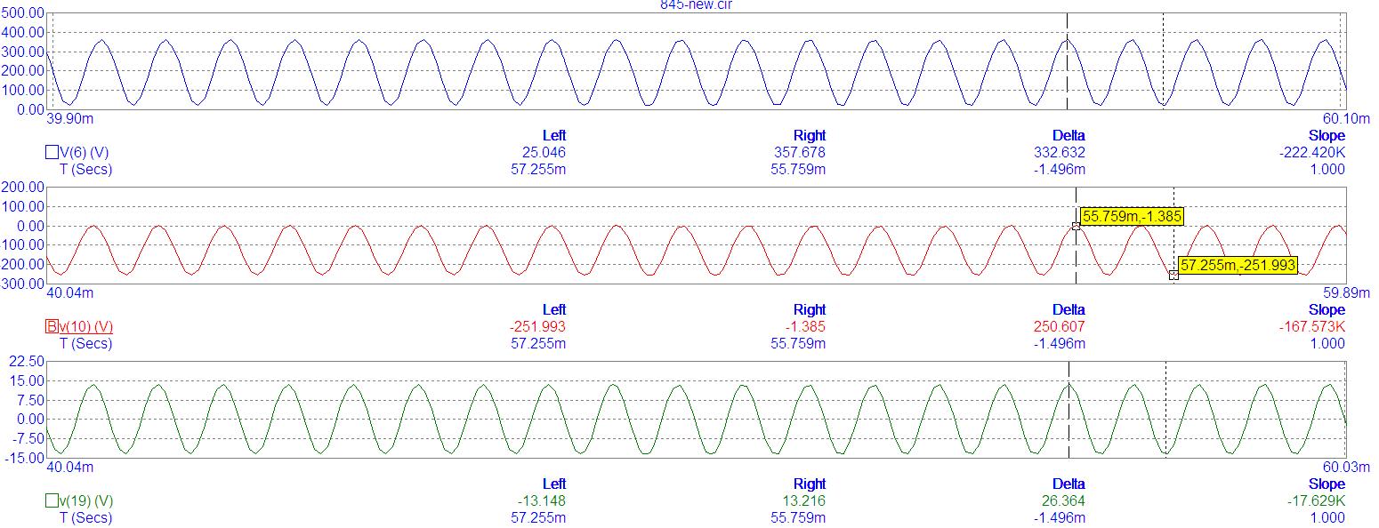

Key changes (besides rework of input stage) was increase of R9 so that idle current through driver tube is about 10 mA, and reduction of R5 to increase available B+ for first stage, and thus possible peak to peak amplitude of output signal. CCS (M1) model was taken from IXYS application guide – they use standard model of depletion mode Mosfet and supply parameters for their device to be used in simulation. In the circuit R18 defines the current through CCS. R19 prevents possible high frequency oscillation. R21 is a self bias resistor, it needs to be adjusted for every specific current set in CCS – this is the only in circuit adjustment that needs to be done. I used adjustable pots for both R18 and R21 because adjustment is needed for specific units of IXYS device and tube. C8 moves up roll off in treble compensating influence of input capacitance of 300B driver tube, which is significant comparing with dynamic impedance of CCS. I reduced current through 300B tube because I wanted to keep it reasonably low to avoid saturation of choke that filters B+, if it was rated to 25 mA (as mentioned on original diagram), I would have 28 mA passing through it (10+10+4+4), and keeping 20 mA would exceed specification almost two times (I do not know what designers thought when they chose components) and I didn't want to replace that choke soldered to power supply board.
As you can see now we have about 200 volts at plate of first tube and simulation promised very good results.

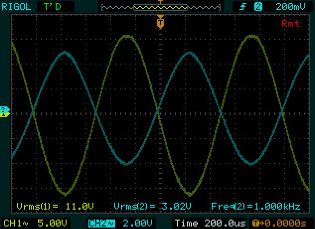

See Pic. 5
As you can see we have quite good sine wave with over 330 volts peak to peak at plate of first tube, and it offers over 10 watts of clean power at 8 ohm load. The trade in was much lower sensitivity of the amplifier – it would need 3-4 volts RMS from preamp to achieve full power. This was not a problem for me since my preamp is capable to go as high as 10 volts RMS, but it can be a problem for someone with more modest preamplifier. And of cause modified amplifier cannot be driven to full power directly from source like media player of computer sound card. But anyway that was a time to start working with real hardware. To keep amplifier internals clean I decided to use small pieces of proto boards for all new components - CCS device, and tuning pots. To avoid costly error in exceeding adjustment limits and frying CCS or tubes I added resistors in series with trimming pots, so that full circuit resistance would never reach zero and thus keep currents within safe limits. This proved to be useful as adjustments were severely non linear. I soldered copper clad steel wires (internal conductor from TV coax cable as pins to connect proto board and main PCB so that they fit in existing wholes left after removing unused components. This proved to be a reliable solution. Considering that IXYS devices would dissipate about 1 W of power, I decided to use small heat sinks glued with heat transfer tape – this is commonly used by computer modders on video memory chips. I initially modified only one channel, so that I could compare results before and after modification.
In tuning process I used digital oscilloscope, function generator, and computer measurement station with EMU 0404USB interface and DAC and ADC, calibrated HP attenuator, and computer with Windows 7 running SpectraPlus and RMAA software.
First I adjusted pot controlling CCS current to 2 mA and bias trim pot so that I could get largest swing of signal at the plate of first tube (I use 1 kHz signal) and still do not see distortion on oscilloscope. Then I went through a series of checks in RMAA. And here I found my first mistake. I found that amplification factor increases when I reduce current through the input tube, as well as largest possible voltage swing, but a side effect is an early roll of in treble – up to 3 dB at 10 kHz. This was not acceptable. Increase in current pushes roll off higher, but require larger signal to drive amplifier and also limits voltage swing. Through trial and error I found a compromise at 4 mA. I also tried to find a value of capacitor parallel to bias resistor to get lowest roll of and no bump in ultrasonic frequencies. There was still some roll of (about 2dB at 20 kHz), but I considered it acceptable. For full fix one more gain stage is needed like in modification of the same amplifier made by Lampiztor, which I found later (MrLiung), but it was outside of my original plans.
When I made that final adjustment to the amplifier, I got a very good results. I was able to get 15 watts on 8 ohm load before onset of clipping and about 10 W with THD below 1%. Distortion was mostly 2nd, 3rd and 4th harmonics. IMD was also reasonably low. This was very much better than original, and I was satisfied with results. Now it was time to modify second channel and go through a full series of tests.

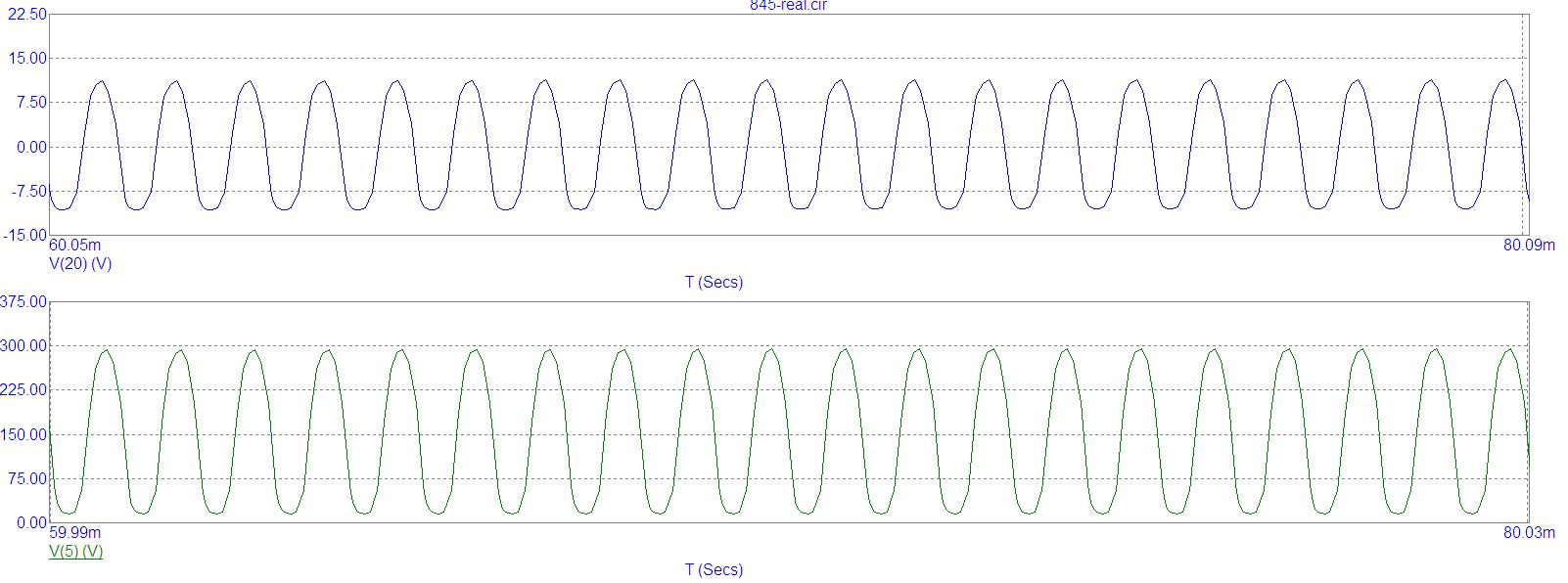

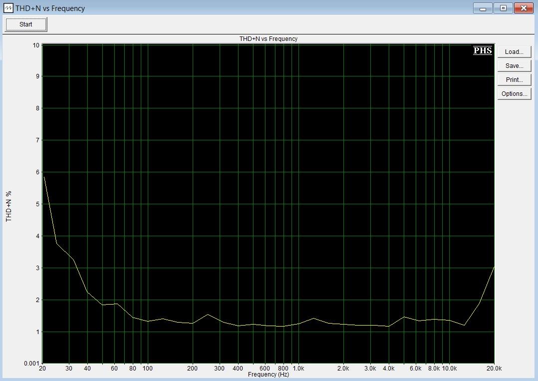

When I wrote about Yaquin, some complained that I didn't provide objective measurement results. Now I decided to add them as proof of my work. So here is an oscilloscope snapshot at onset of clipping.
See Pic. 6
As you can see I was able to get over 11 volts RMS at 8 ohm, which is equivalent to more than 15 Watts, which is close to a theoretical limit of what is possible to get from 845 tube without significant grid current. I actually suspect that there was some grid current, since I noticed that average current through each of power tube was increasing from 95 to 105 mA according to internal meters when I pushed it close to clipping.
Then I measured main parameters of the amplifier using RMAA software. Results look acceptable if remember that there is NO global negative feedback.
See Pic. 7
You may notice that there is a lot of hash in the midrange frequencies in spectrum – this is purely because of common mode noise I picked up. Direct measurement of noise level at speaker terminals resulted in only 3.5 mV of hum/noise. I consider it acceptable. And when I was listening this amplifier, I could only hear hum when I put me ear few inches from midrange driver. I also measured THD as function of frequency. Result was mostly a flat graph with distortion rising below 60 Hz and above 15 kHz. This measurement was done at 12.5W of power.

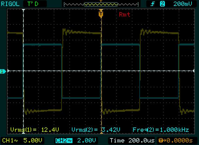

I also looked at how this amplifier reproduces a square wave. As you can expect it demonstrates limits at low and high frequencies. But you cannot expect much more from inexpensive SET amplifier.
See Pic. 9, Pic. 10 and Pic. 11
Some ringing that you can see, is a result of ultrasonic resonance in output transformer. But this is not sign of any instability of the amplifier circuit. I also measured output impedance of that amplifier – it is around 4.7 ohm, that includes about 1 ohm resistance of output transformer winding.
