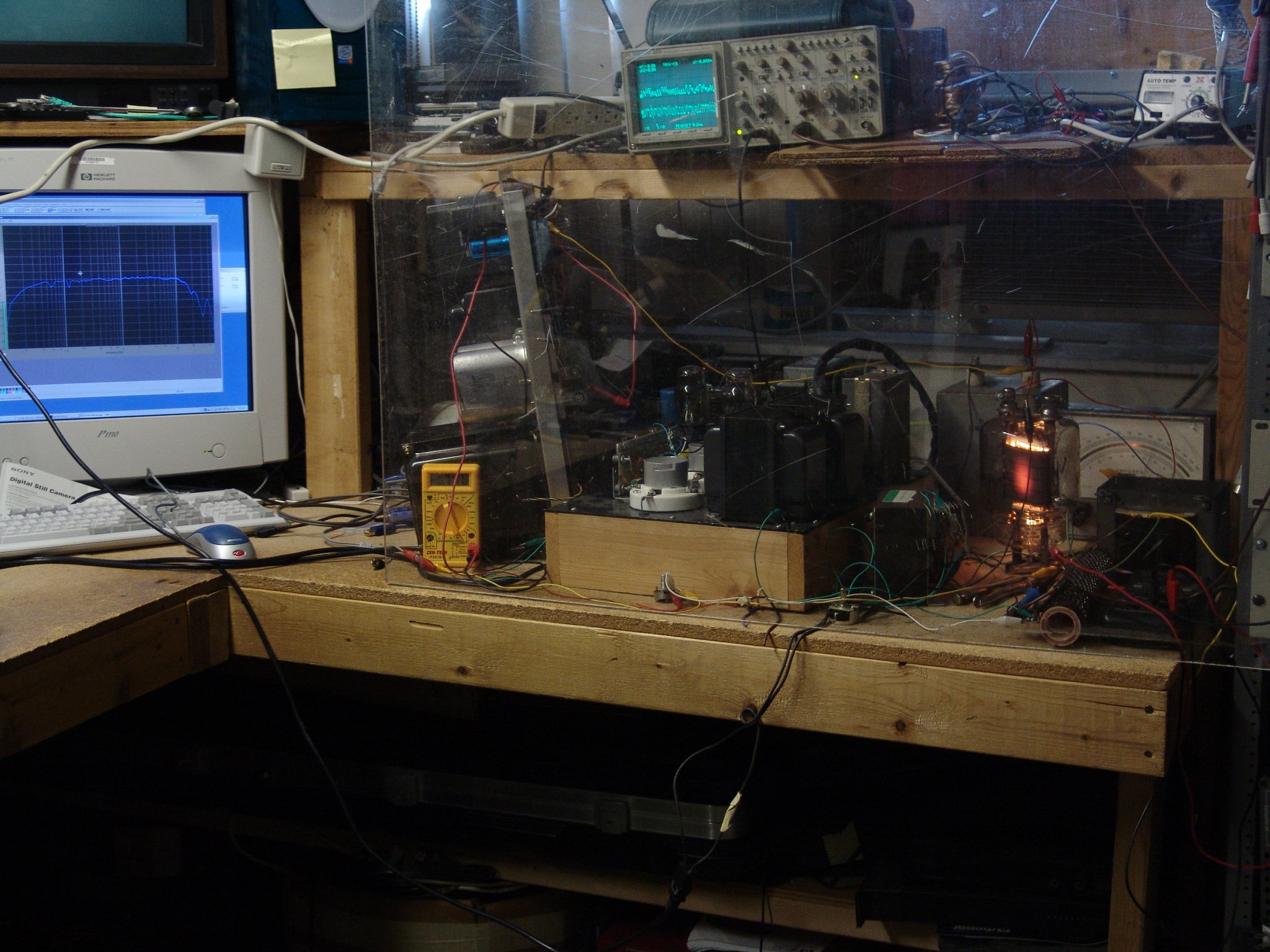

The biggest working tube amp I ever had made used an 833A tube that needed 100 watts of filament power (10 V @ 10 A). With 1500 volts at 280 mA flowing through the plate and OPT in A2 SE, I got around 200 watts of audio power output with about 5 watts of drive. I annoyed the neighbors with my lousy but loud guitar playing for about 2 weeks then took it apart. I still have all the parts for a single channel, but never actually built it. I had central AC in Florida, AND a 5000 BTU window mount "booster" AC in my work room and the 833A amp could only be used for about 20 minutes before it got too hot to be in there.
I did have a pair of 4-1000 tubes which are quite large and need 158 watts each on the filament and 4 to 6 KV on the plates to make 3000 to 3900 watts of audio in AB2 with about 5 watts of drive, or 2000 to 3800 watts in AB1 with zero drive power. Someone who wanted to make a BIG RF amp offered me good money for them, so I never even made a test amp. The plan was to use a large power transformer for an OPT and a big power transformer from a Harris transmitter for power.

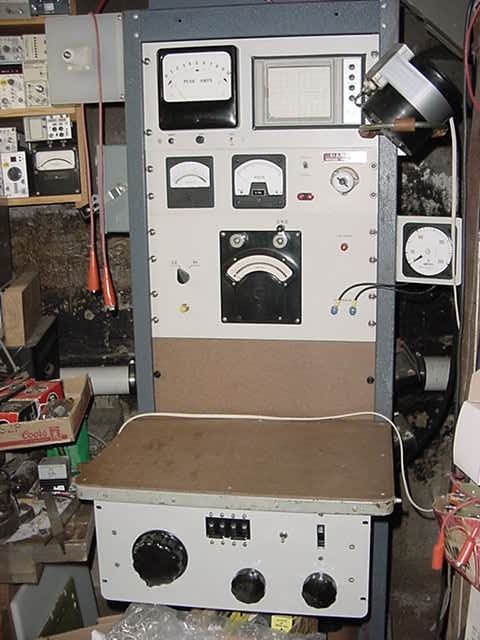

That video brought back memories. Around 35 to 40 years ago when I was actively buying and selling industrial power tubes I have had that tube and tested it. Paul says it was good because it lighted up okay without smoking the filament. But that's only part of what needs to be done if you can't put it into actual operation. I've had big tubes that lit up fine but had virtually no emission.
First you hypot the tube between all elements with around 1500 volts (or more) AC. This checks for shorts, leakage and gas. If it passes that, then power up the filament slowly, but not necessarily as slow as he did, and then pulse test it with 2500 VDC. This is actually a mil spec test. Specifically you connect the tube elements as a diode, charge up a HV capacitor bank to 2500VDC and discharge them through the tube via a high current mercury switch. Peak current is measured as voltage across a 0.1 ohm resistor between the filament and negative source. The instrument that dose this is seen below, and now resides in my basement form it's former location.
Tester particulars:
Filament transformer 12V @ 200A
Capacitors 2 paralleled 100ufd @ 3000VDC photo flash cans
200 amp dual mercury relay (24V DC coil) (I think)
20A filament variac
10A HV variac.
Charging transformer Stancor PT-8311 (2400Vct - 225mA)
Amp meter is Hickok 150A iron vain type modified for filament voltage out at connectors.
Cathode resistor is 100 10 ohm 2W carbons for 0.1 ohm (no special reason for these)
Voltage into fast SS diode to 10uf PP 50V cap feeding high impedance VTVM sample & hold (sort of)
Calibrate - pulse 2500V into 25 ohm 200W resistor for 100 peak amps analog meter

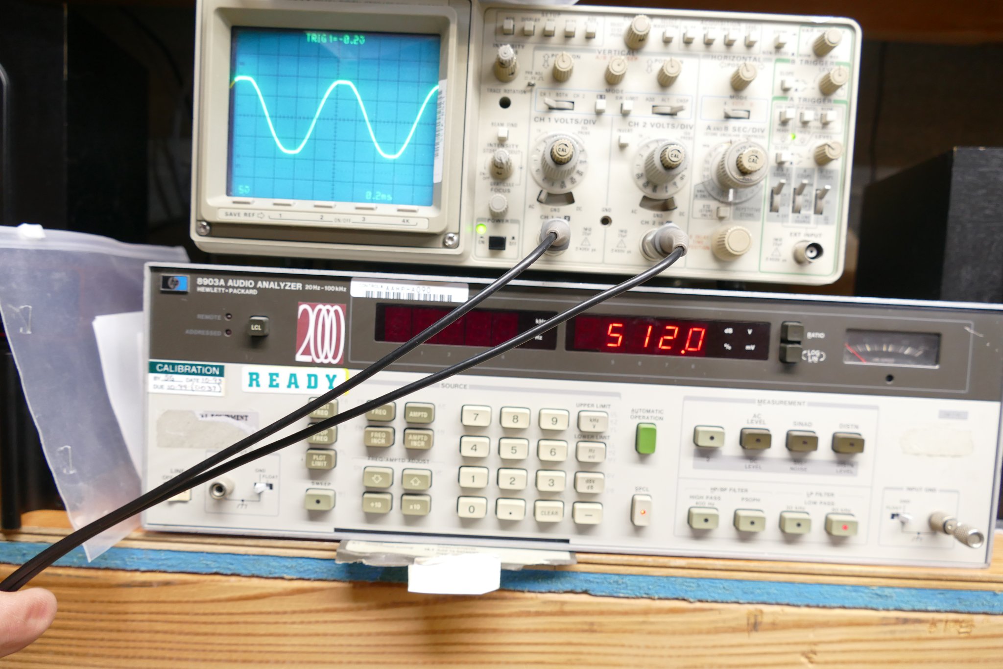

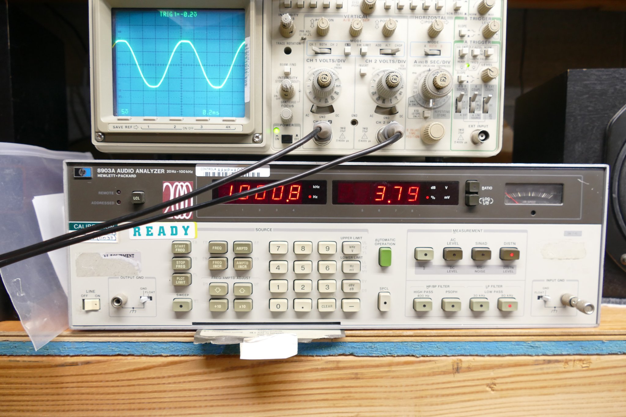

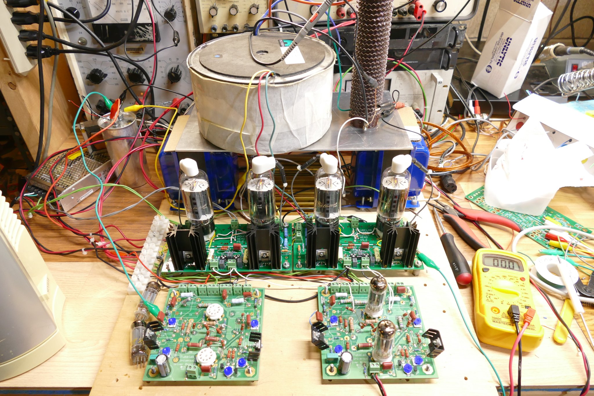

I have no need, or even a use for a monster tube amp, but I have collected all of the necessary parts for a 1 KW (500 WPC) tube amp, pending on the outcome of one more experiment. Still not sure if I'll ever build it.
The pictures show a single channel test amp that uses one of my Universal Driver Boards driving a pair of my Octal UNSET Output Boards to 512 watts at 3.79% THD. Clipping appears at 525 watts. THD at 350 watts is 0.817%. The only remaining piece of the puzzle is a suitable power supply. I have a pair of huge toroidal isolation transformers that have 4 isolated 120 volt windings. They could be used to make a conventional but heavy 600 volt supply capable of powering this amp. The overall weight of the amp could become more than I could lift as I get older, so I'm going to explore another path. I have about 20 identical 48 volt 3 amp SMPS's. If they could be interconnected in series without creating a nuclear fireball, they could lighten the amp a good bit. The OPT's are still heavy, but I have an unpotted pair that are lighter.
