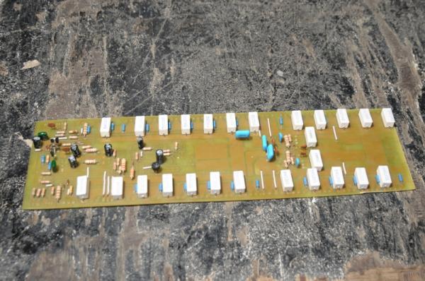

I'm looking for the substitute of MJE15032 to drive for the class H amplifier I'm making.
Try the fairchild FJP1943/5200 . Just the little brother to the famous 2sa1943/2sc5200. they come in 2 Hfe classes R- 55-100 and O - 80-160 (to-220 package).
KSA-C 44/94 are super replacements for the mpsa's (350Vce) and ALL my VAS's are strait KSA1381/KSC3503. These fairchilds very rarely are off by 10% in beta , out of lots of 20 , I usually only have a few I can't match pairs to 2-3% .
OS
In my place (Iloilo City, Philippines), people are looking for powerful amplifiers so we're making amplifiers. Our HB+ and HB- is 155 dc and our LB+ and LB- is 77.5 dc. The transistor we're using is C5200 and A1943 for the power amp and for the switching and those are the only available transistors in my place. That's why I'm looking for the drive to replace the MJE15032 because of the QSC I'm modifying right now.
If the amp uses three current-gain stages, yes, it's best to go and use a full size output device as a driver. It sure simplifies everything. Then you can use MJE340/350 predrivers which are widely available and are easy to screen if you're worried about where they came from.
But if you're cloning the QSC circuit the driver needs to be a smaller lower capacitance higher hFE die.
