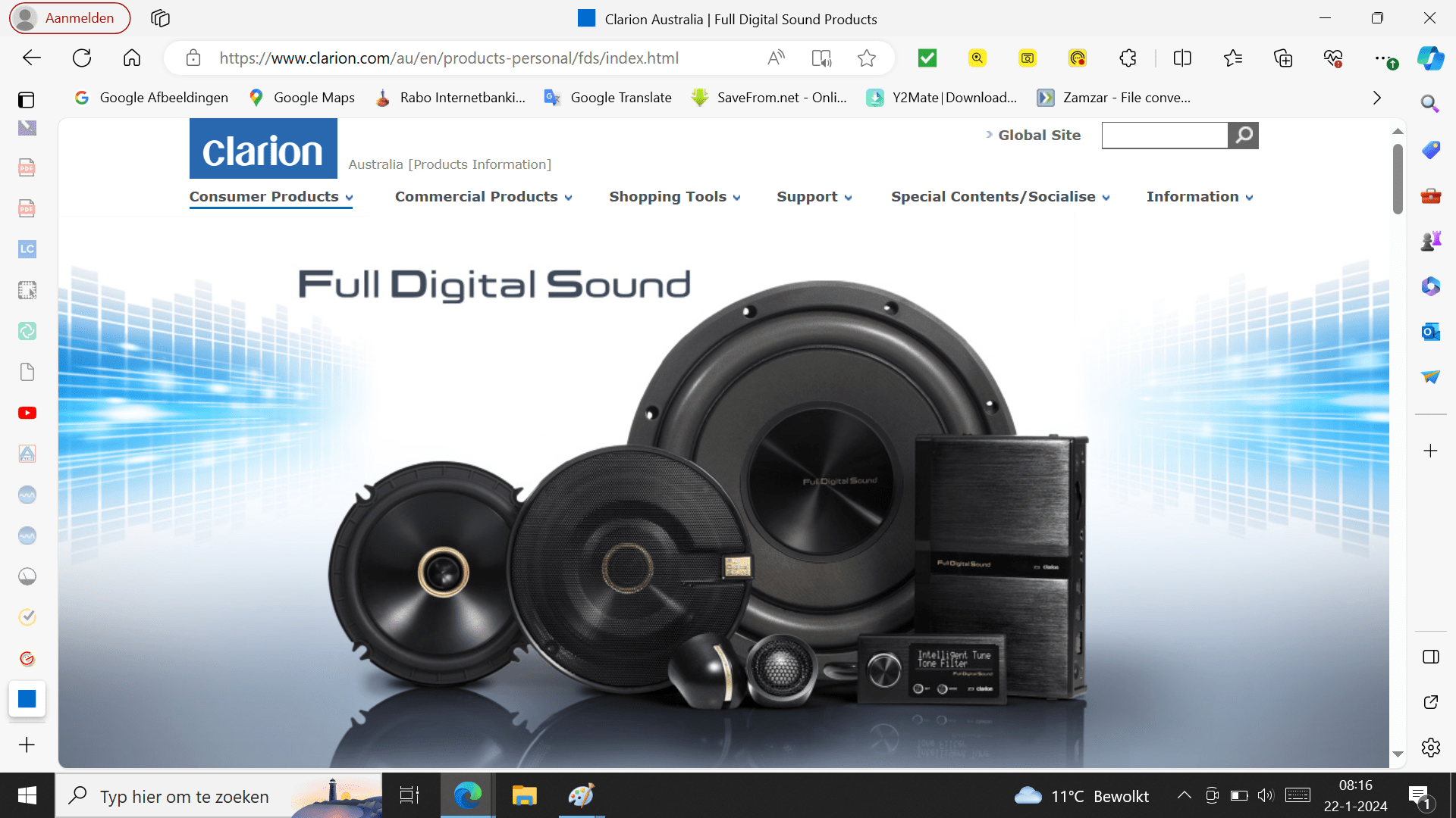

I remember that about ten years ago there was an announcement for a speaker that had many coils, and each coil is driven by an amplifier such as ( my catch) each is a Bit part of a Byte. Clarion had a flyer explaining it. I don't see it applied, even if it was for car. Maybe graphene is the new thing applied to loudspeaker technology...I dunno!?
So that was a system for a compact all digital way to make sounds. Probably the speaker part had not been resolved. But I 'm unaware of today's progress in digital, in general...Like Mp3 and the likes, also in video. But I believe we are leaded, hence the progress in science and technology, by what satisfies most (our senses) so sort of natural selection.

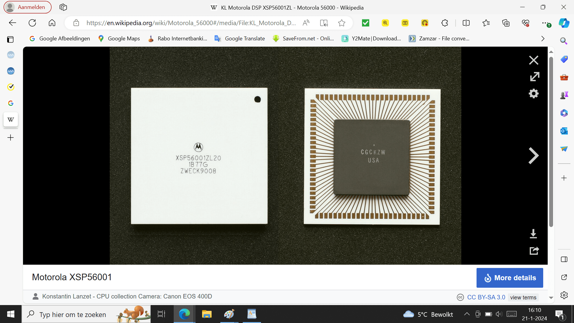

Motorola wasn't sold to Freescale. Freescale was created from Motorola's semiconductor business.Motorola was sold to Freescale,
... a speaker that had many coils, and each coil is driven by an amplifier such as ( my catch) each is a Bit part of a Byte. Clarion had a flyer explaining it...
... all digital way to make sounds....
Maybe using only 1 speaker and many coils was a way to eliminate crossover-circuits? I idn't look into Clarion.
"all digital", so more than 1 class-D (amplifying) ADCs involved?
You're right, I hadn't heard of Freescale before I discovered the Motorola DSP56001 datasheet suddenly had a "changed manufacturer"...Motorola wasn't sold to Freescale. Freescale was created from Motorola's semiconductor business.
... Clarion had a flyer explaining it...
This one? Gonna look into this...

Works something like this?:... about ten years ago ... a speaker that had many coils, and each coil is driven by an amplifier... each coil is a Bit part of a Byte....Clarion had a flyer explaining it... ...all digital...

Didn't look into Clarion yet; going to view above https now...
