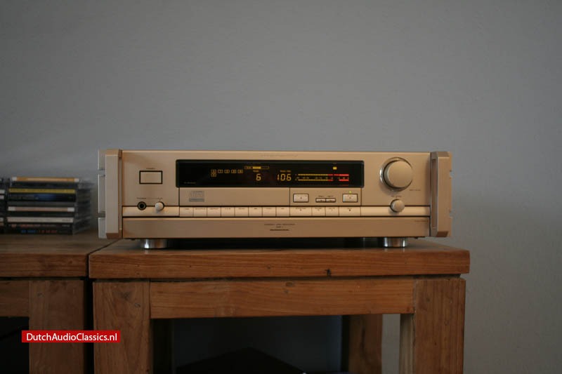

Back to my encoder in 1990: I encoded 6 audio-sources and joined them. This gave 1.4 Mb/s (standard CD: Fs 44100 Hz, stereo, 16 bits PCM). I bought a Marantz CD recorder. This was one of the first devices that could RECORD A BLANK CD!!!
I was concerned if this would work, because I wanted to increase the capacity of a CD (playable in a CD-player) 6 times, and the Marantz could only record AUDIO data, whereas I wanted to store/record PURE data. My data sounded as noise, but luckily the Marantz could handle it (input by S/PDIF).
I put a DSP inside of a normal CDplayer and only needed 5 hack-points of its internal circuit: power (5V and GND), bitclock (going to the DAC of the player, sampleclock and data, going from CD to DAC (in my case carrying the complessed audiodata) and from my DSP (outputting standard PCMaudio to DAC
CDplayer could be operated as usual (play, stop, pause, next, prev), and one extra button of mine, to select which one of the 6 channels.

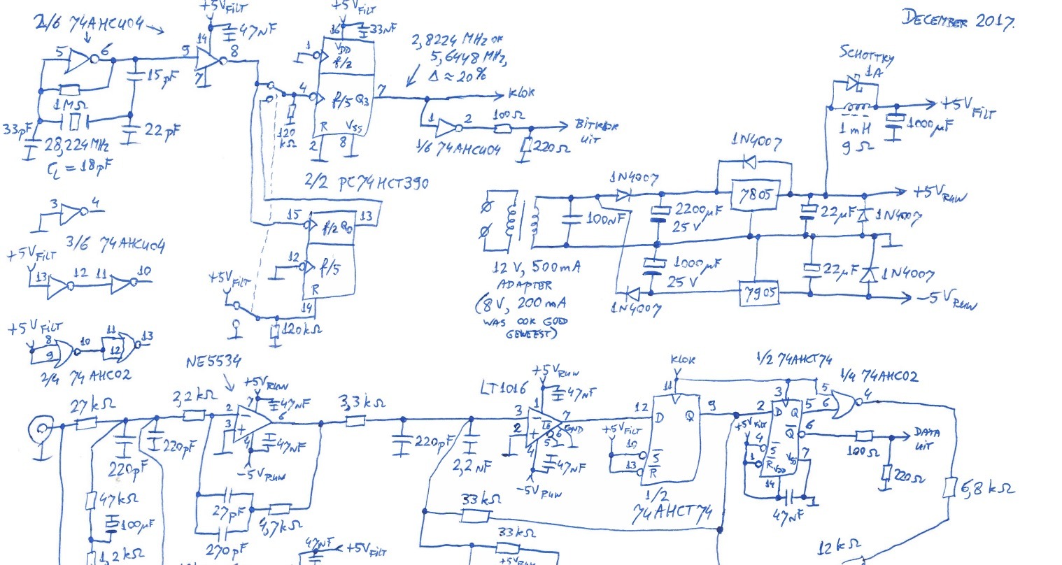

Your sigma/delta ADC (drawing above) will feed my very simple sigma/delta 1bit amplifying DAC: four transistors in fullbridge configuration, driving a loudspeaker through an analogue reconstruction filter, like STA518 (ST semiconductor; digital in, analogue out). I am new to sigma/delta, and a (to me) an intriguing phenomenon seems to appear, when looking at TPA3138D2 (Texas instruments; analogue in, analogue out). This class D digital amplifier seems to inherently do datacompression factor two. Its clockfrequency is 320 kHz, so 320 kbits/s. CD PCM is 700 kbits/s. Maybe its speakerdriver is more than 1 bit, because out+ and out- are driver independantly, resulting in 2 log 3 = 1.58 bits? Another reason could be TI is less than CDquality (THD+N, dynamic range)?
I guess in analogue domain, it is possible to have infinite resolution even though "clocked" at a fixed rate. THIS IS THE CONFUSING PART (to me, at least at the moment). Digital amplication (meaning increasing analogue current in a wire) seems to be "somewhere inbetween" analogue and digital, as far as 1 bit PWM or sigma-delta is concerned.
Your message and mine crossed each other. My DAC will drive a very low cost speaker. Poor sound, unless user uses headphones. I saw you also tested a design of yours of an order 6 delta-sigma ADC. Which one (2nd or 6th) order should work best for my appication?
