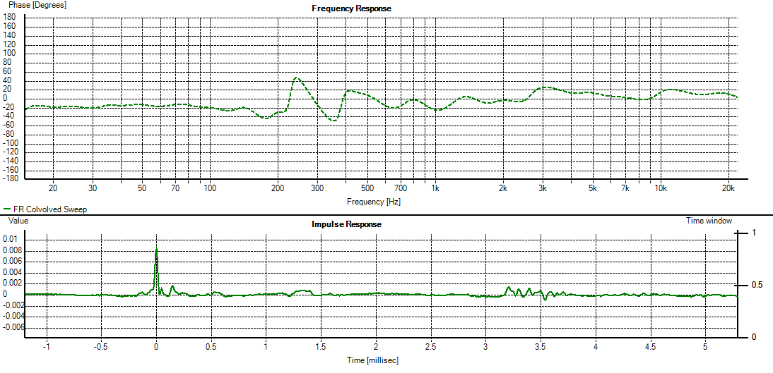

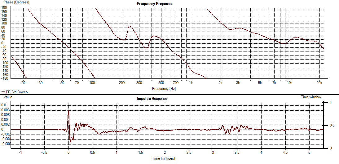

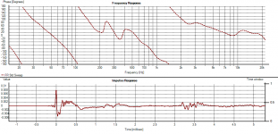

I then created a convolved log sweep wave and measured the FR speaker as at my LP about 4 m from the speaker.
I am using 1/3 octave smoothing in the following 2 charts.
Below used the normal sweep:
Below used the convolved sweep:
The IR is for phase correction only and the SPL response is unchanged as intended (not shown).

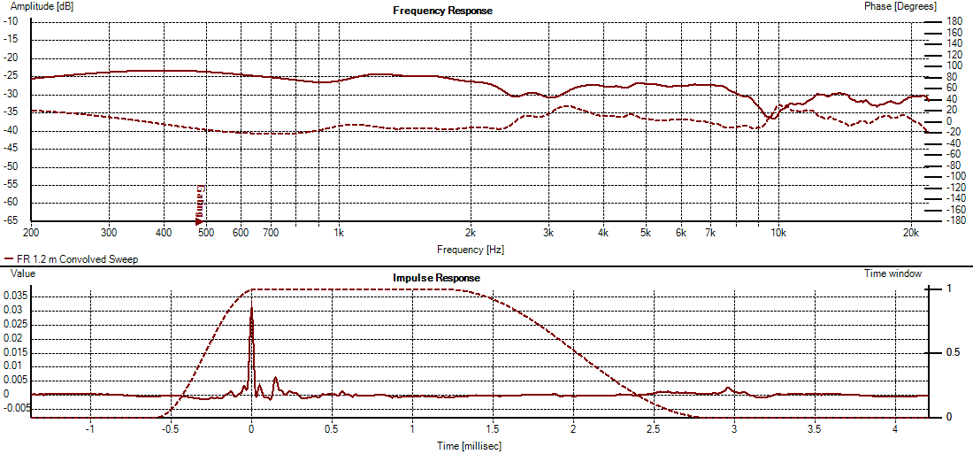

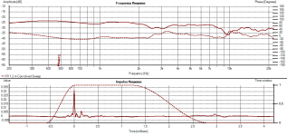

Below now using the convolved sweep with mic at 1.2 m (gated measurement as shown):
