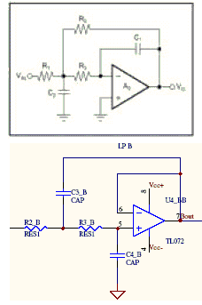

Can moxlite be modified either by track snip or by hard wire p2p to form MFB filter topology?
This mod is easy if gain adjustable filter blocks based on EVS&K are used.
now going one step farther.

Yes, the schematic for MFB is exactly as you attached to post 108.
The similarity is that both are 2 pole filters and when you draw the unity gain (moxlite) inverted with the -ve input at the top you find the component placement is almost identical with just a few track swaps and 3 extra resistors. Similarly if you compare the inverted layout of an EVS&K (mox) again component layout is even closer and this time only 1 extra resistor is required.
The advantage of EVS&K is independant setting of Q and accurate selection of frequency Rs & Cs without scaling. The advantage of MFB is independant setting of both gain and Q but at the expense of scaled Cs but you can obviate this by //ing identical Cs for the lower limb with good matching accuracy if board space is dedicated to the Hi Q filter.
All of this only applies if you want filters other than B2, B3, L-R4 and L-R6.

When searching for active filter info, try looking for transfer function and parameter calculation.
I have been looking at the MFIG filter, but desided on the S&K topology for my active filter, I thought the S&K was simpler (1 less component per second order section)
There might also be a need for an extra inverter somewhere because the the MFIG filter is an inverting filter. I think a desing example is needed to evaluate what filter is the optimal one for DIY.
The transfer function will be similar for the two filters, but the sensitivity to component changes will be different for the two filters.

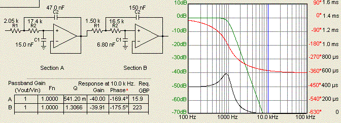

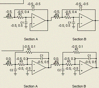

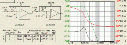

Andrew, there is no need for EV S&K! Check out the sensitivity comparison for two B4 filters. The top is SK, the bottom MFB. Yes, the MFB is less sensitive, but the difference is hardly overwhelming.
(The gain is unity for both filters.)
For both filters, the gain/Q error is never more than half the component error in this case. If you really want to be careful, you can choose your components so that a small error in one component is balanced by an opposite small error in another.
