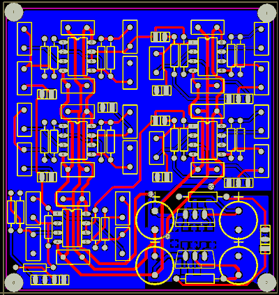

The board includes input buffer, two bandpass sections, and a high pass section. It also includes two parametric EQs and regulators.

Personally, I think the discrete opamp is most valuable in the mid+high; I don't think there is so much of a difference at lower frequencies.
Here is an updated PCB. I created a separate power ground run, increased the capacitor spacing (except for the 100pF input caps, all caps can be at least .280"/7mm wide), and cleaned up the ground plane some more. Please let me know any other comments.

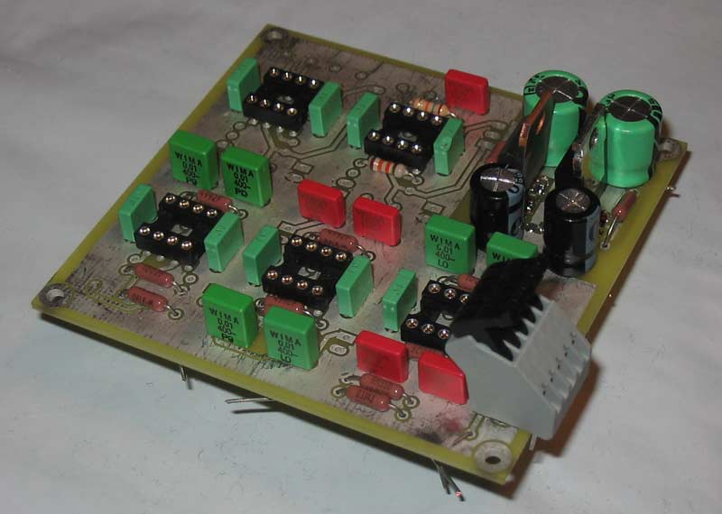

Here is a pic of a proto board. The MOXlite boards will have soldermask and silkscreen. I also flipped the ground plane on this protoboard for ease of soldering.

Ok, here is a preliminary schematic. It is not at all up to the level of Jen's guide, but it's suitable for poking around. I'll try to get this cleaned up a bit at some point.
http://tiroth.brinkster.net/doc/moxlite_v2_schem.pdf
Here are shots of the board multilayer, and each individual layer for clarity.
http://tiroth.brinkster.net/doc/moxlite_v2_board.pdf
You can see this uses a basic S-K topology. Items of note include the fact that any stage can bypass the input buffer allowing easy cascading for 24dB/octave or higher. There is also room for a 0.5"/12mm footprint voltage dropping resistor before the regulators; this should allow compatibility with most PSUs without the need for an extra low voltage transformer.
You can see that I have named components logically; that is, the S-K filter sections have the same designators but _A or _B appended. I don't know if this is useful or not...please give me your opinion if you care. I am happy to go either way.
If there are any comments or requests about spacing, grounding, etc. those are fine too.
