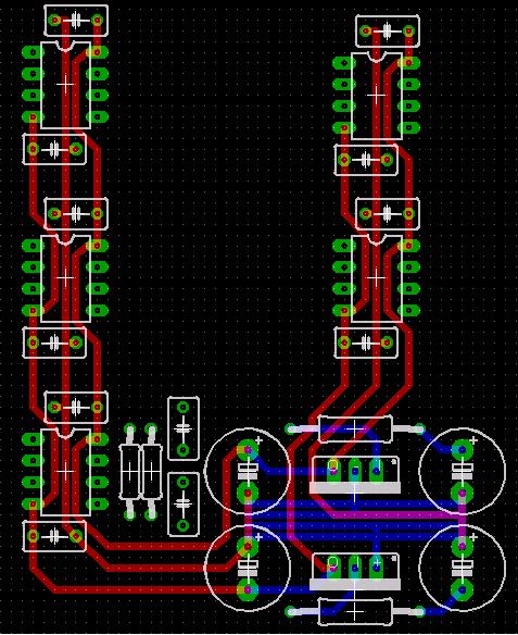

Thanks for explaining things in the mail. MOXLite seems like a good idea, although I may have one suggestion related to the PCB design.
I think that on the top side there should be a power ground track between + and -. Snubber caps (C10X) should be connected only to the power ground track (not the signal ground). The signal and power grounds must be connected only at the power supply's caps.

Feedback so far on MOXlite:
Grounding -- this could be a challenge, but I'll see what can be done. I'll post a mock up for comments.
Cap clearance -- I intended to have clearance for 5mm width caps for all filter sections. Jens has pointed out that I am probably short of this on a few caps. This should be easy to correct.

tiroth said:......Grounding -- this could be a challenge......
...and don't I just looove challenges 😀
Here is what I had in mind for grounding.

I thought I would let you spill the beans Milan. 🙂 Thanks for your drawing. I think I initially rejected this, because I had some pretty generous clearance constraints and I couldn't fit everything. Since this order will be for production boards with mask and not the bare ones I ordered for myself, it shouldn't be a problem.
I guess it is also a bit unnecessary to make the toplayer pads so wide. 😉
