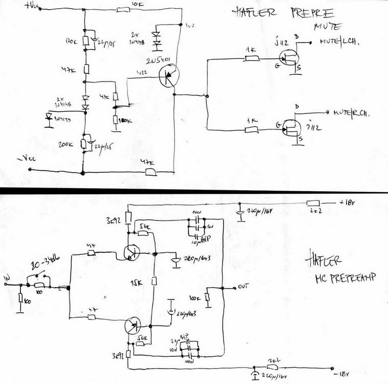

Paul, you are going to have a difficult time balancing your needs with a realistic solution. About 1/3 of a century ago, we used a pair of 4401-3's to make a moving coil circuit. In my patented approach, we did NOT need either input or output caps. However there were other problems, especially with higher output mc cartridges and I moved on to fets. Low noise Toshiba fets are at least as quiet as a 4401-3 pair, BUT they requre several Ma of current to work successfully. They also usually require more voltage as well.
Back in 1973, Mark Levinson and I paralleled 4 pairs of 4401-3 parts to make the input low noise enough for an Ortofon MC cartridge like yours. We also ran about 8 ma per channel, so we had to use D cell batteries, and even they ran down, all too soon. This AA battery stuff is a big compromise, because if you STARVE the transistors, the battery will last, but the noise will go up big time! Working fets in their 'triode' region will not get you the gain that you need. I wouldn't worry too much about the leakage of a cap, just use a good one. Try to use Japanese or German caps, if you can. Cap size matters! IF you use too small a value (like 10uf) the transistors will get VERY noisy below 1kHz. Not good. I would recommend a simple 2sk170 Toshiba fet running at a few ma and even up to Idss of the part. Common source or common gate will both work. I would probably use a 10 ohm resistor with a 2sk170 fet and direct couple to the gate. I would NOT bypass the 10 ohm resistor. I would set the load resistor, wherever I get the most voltage swing. I would probably start with 6V, but 12V would be better. Maybe a rechargable gel-cell battery pack. Either a 170 bl or gr will work.

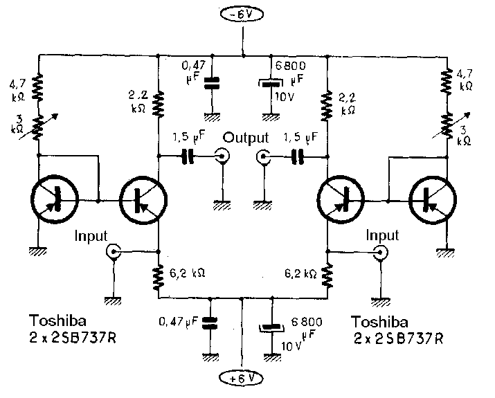

just for , sort of , reference
2SB737 and 2SD786

Have you heard about hiraga's pre-pre? I never tried but some people are very happy with this simple design but with monster power supplies (near farad or more and with plomp battery in parallel with the supply).
pre-pre

Hiraga's pre-pre amp has a low input impedance. See my post #19.
Rabeyrolles proposed an more elaborate version of Hiraga's circuit where a bit of negative feedback enhances the input impedance. Maybe I've got the full schematics somewhere.
Another problem with Hiraga's circuit is how it must be considered :
inverting or not ? If it is considered as having a current input, it is inverting. If it is considered as having a voltage input, it is not inverting.
This is a question typical of Hiraga's circuits ambiguities.
