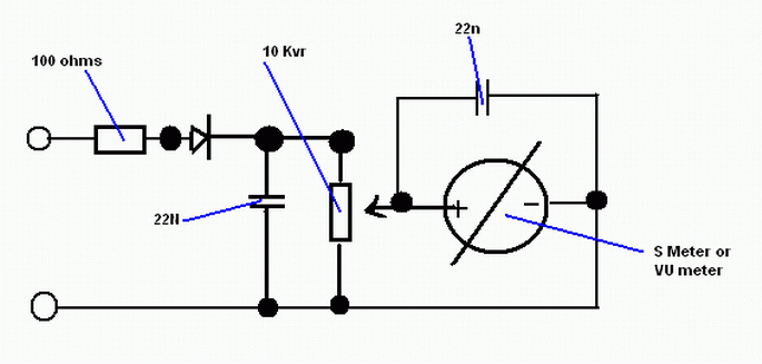

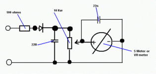

The rectifier can be Silicon or Germanium... to very low signals
It is prefered to use Germanium, as it will conduct starting into 100 milivolts...while the Silicon will start around 500 milivolts.
The trimpot will allow you to adjust the 100 percent indication, or Zero VU, or even S9 radio signal into your undistorted audio power threshold of clipping.
Carlos
